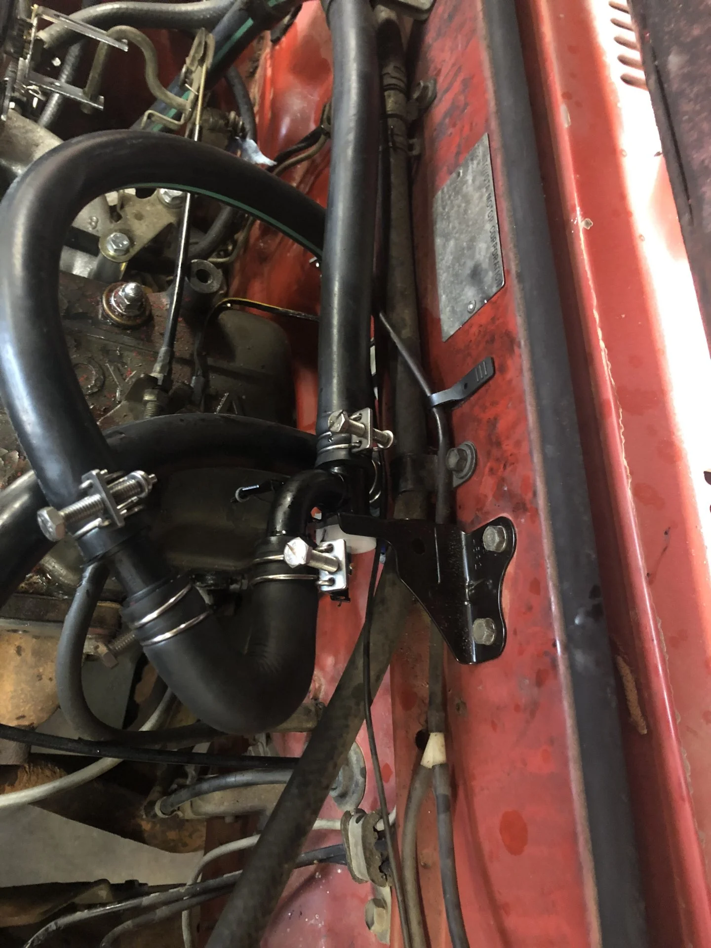

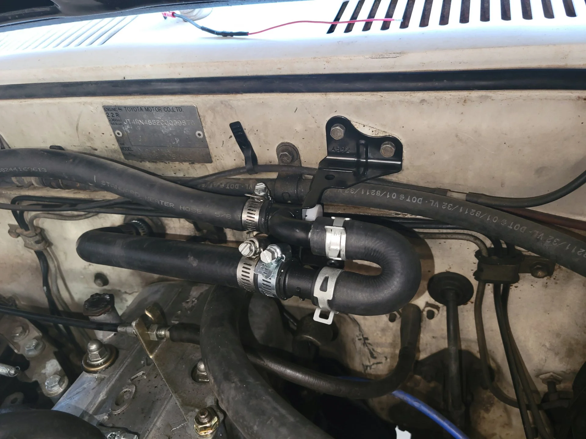

Here you go.
You just need a u-bend to make it work.
Dorman 626-001 heater core bypass kit.

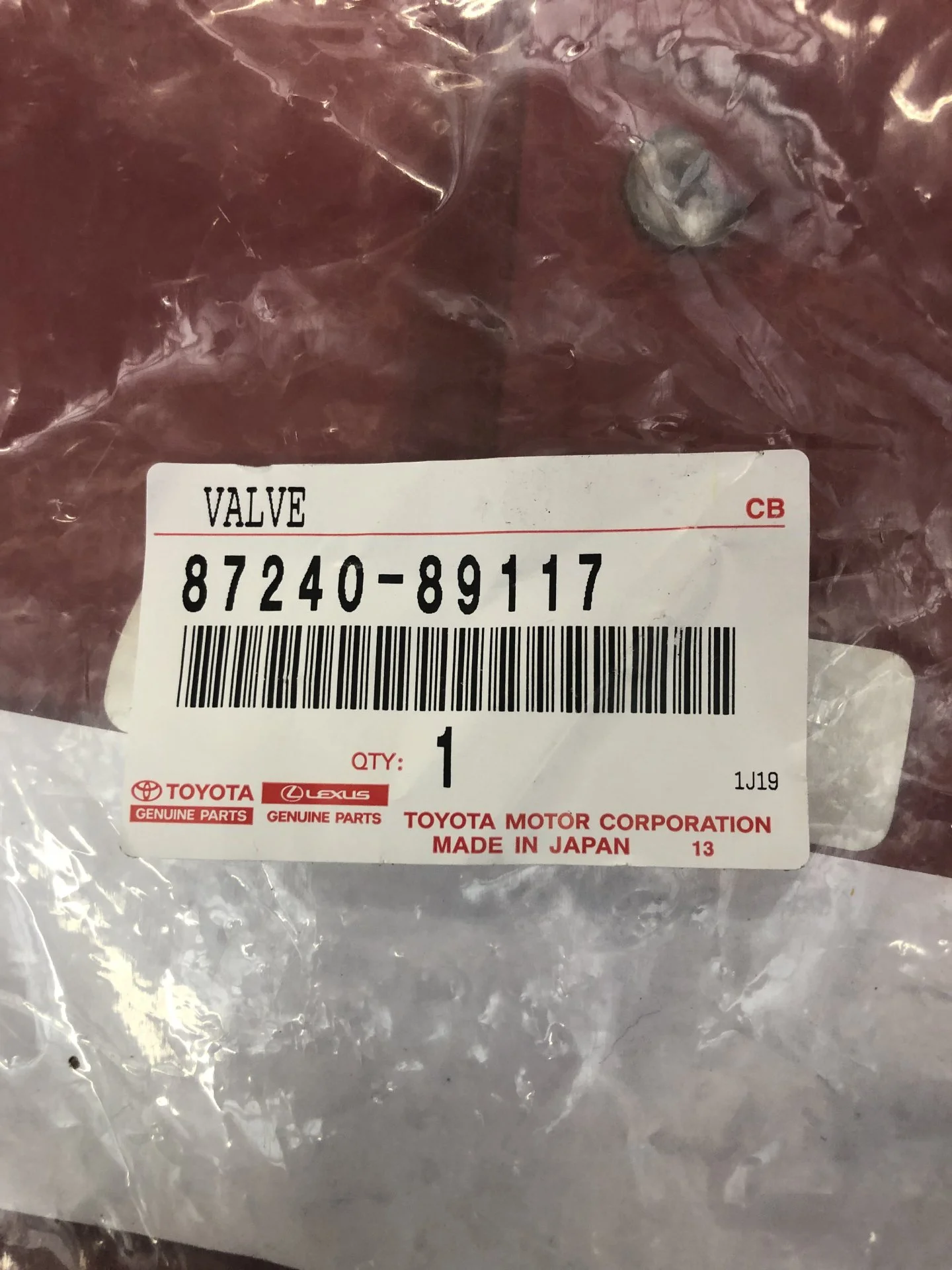

Nice! I knew there was a workaround. Thanks. Is this the 2nd gen valve?

Ended up replacing the heater hose from the firewall to the valve, the original was just a few inches short to make a solid connection. It was a bit swelled anyway so was probably time for a new one. New valve bolted right up and was an easy fix all around.
Lubed cable, controls are now smooth as butter...
