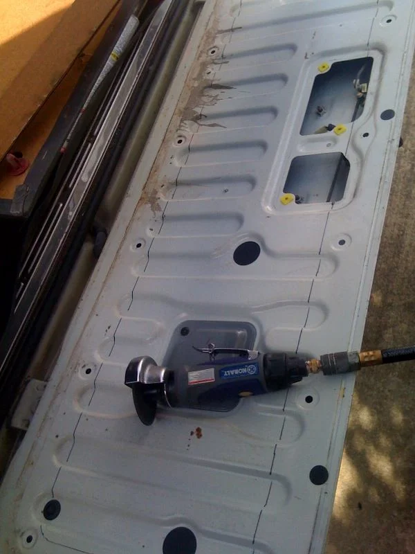

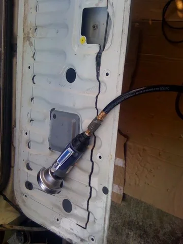

Carpet off and the template penned on with a sharpie and got the cutting wheel ready
the carnage begins

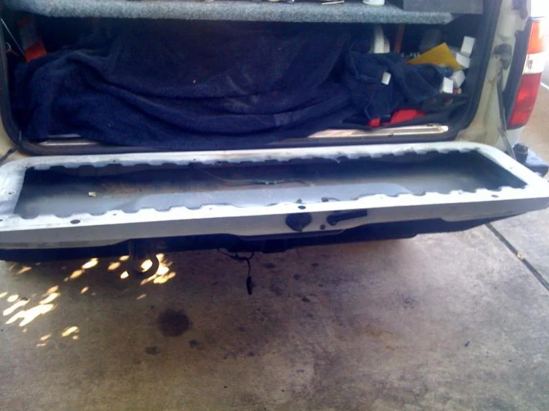

The wheel sucked, so I went out and bought a new reciprocating saw. Big Hole!

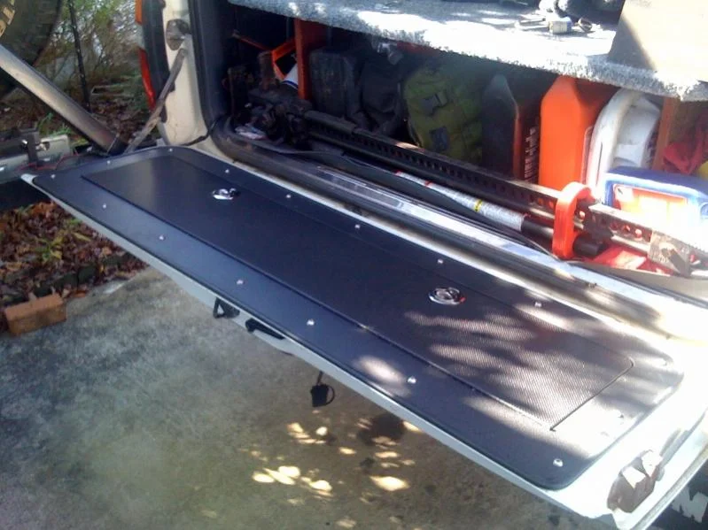

I fitted and started to put all the hardware on, and a problem arose. The hole in the center by the latch/handle area didn't line up as that hole isn't centered up cuz of the handle/latch assembly. After some head scratching, it looked like that Kevin assembled the lid with the top piece backwards.:doh: If I flipped the lid upside down, the holes matched up.
Easy fix though, just drilled a new hole:cheers:
Fully fitted
Open with my jumper cablers in there.
Love it. Great work Kevin;)
'94 tailgate. If you flipped the lid over with the lid door facing down, all the holes lined up perfect. Nothing a drill bit couldn't fix;) I did have to re-cycle a longer allen head screw off my 40 cuz that part I drilled into sat a little lower and the screws that came with the tailgate were just a wee bit too short for that spot.
After you you cut and drilled the top part, did you maybe weld the underside lip on the wrong side? With the one off center hole, there would definitely be one side of the lid that had to face out in order to have that one stray hole line up.
