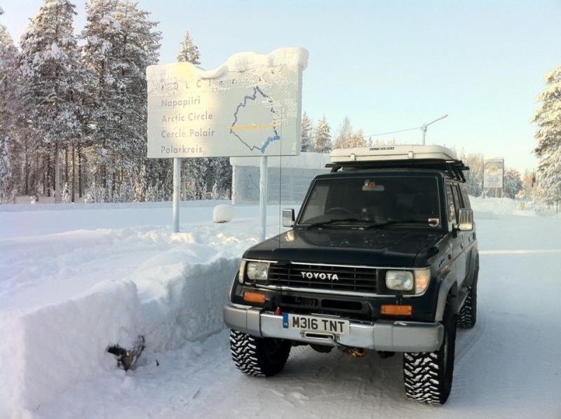

I'm only putting mine in for big trips, I'm off to the top of Sweden on 3rd jan and have lots to carry for our 2 week trip and I've also moved my batteries into the boot to help with cold starting. And might even take the roof tent!, :rolleyes:
Mine runs pretty light in the rear, just recovery stuff..
So a well laden truck will behave better....
So are we going to get treated to some Swedish 4x4 photo's in the New Year...:)
Maybe!
i am running it for the same purpose and under heavy load they work great.
Nice rig, that's what mine looked like about 6 years ago... Now its scratched, dented and always dirty. haha
