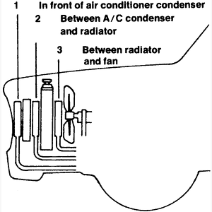

ATEB's kind of pricey. A decent tranny shopp should do it for a lot less. Its fairly simple. Buy a kit or a cooler and the correct hose and fittings. Some people put the cooler in front of the rad or behind it (if there is room). You'll get your best cooling in front but also be at a higher risk for branch or rock damage. If none of these work well for you, try to find another spot which gets decent air flow.

its not too hard Jeff...im sure with your girls supervising you...youd be able to knock it out in an afternoon. its pretty simple...just bolt it to the easiest location, usually in front of AC condensor. then just tap into the pressure (feed line i think?) and run the in/out of the cooler in before the line hits the tranny. done. thats how it was with my PS pump cooler anyway...tranny cooler should be the same. and if you're really stuck, you can just read the instructions :D
