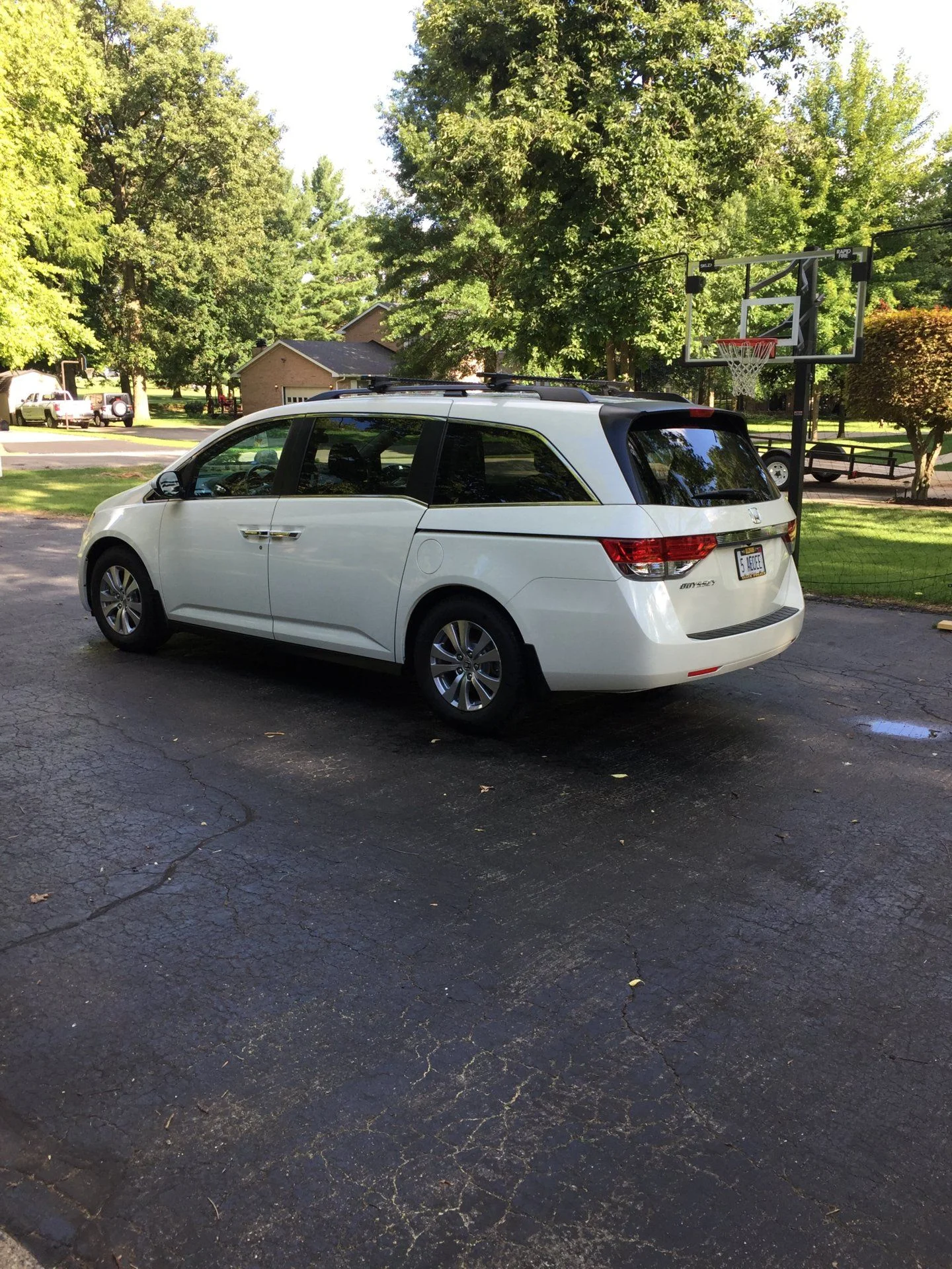

I have the Thule square bars that I always use. I’ve added black paracord to them which cut the wind noise significantly. Here’s the only picture I have of the square bars with paracord on my Odyssey. You might give it a try.

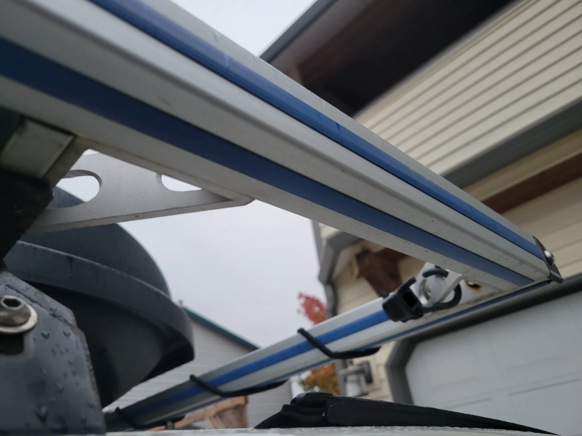

I havent taken advantage of the channels for mounting accessories or other rooftop gear. A 2x kayak rack is living up there now. But it is using the standard wrap around the cross bar clamps.

What are you using for kayak tie downs that bolt into the 8020 tracks?

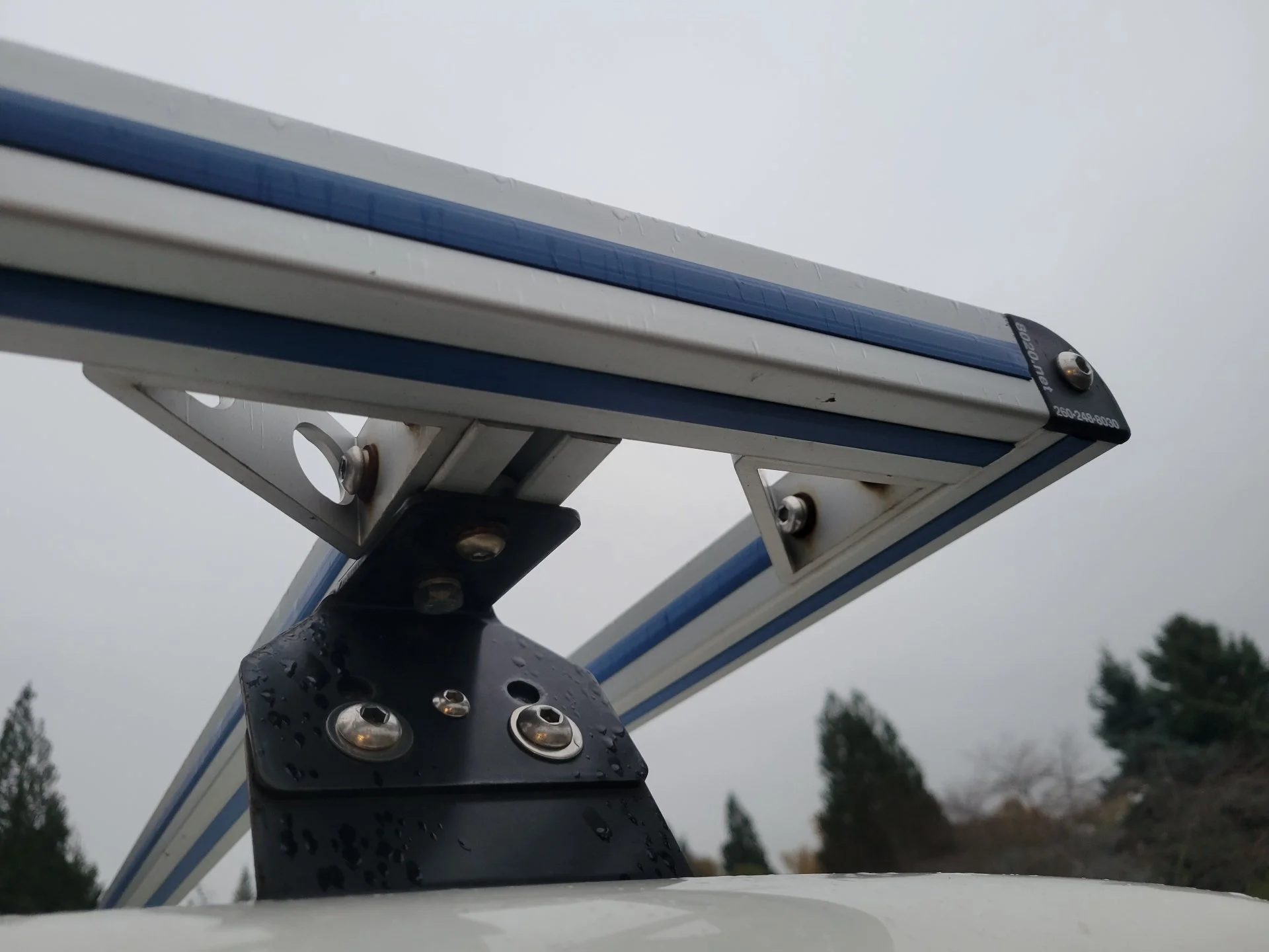

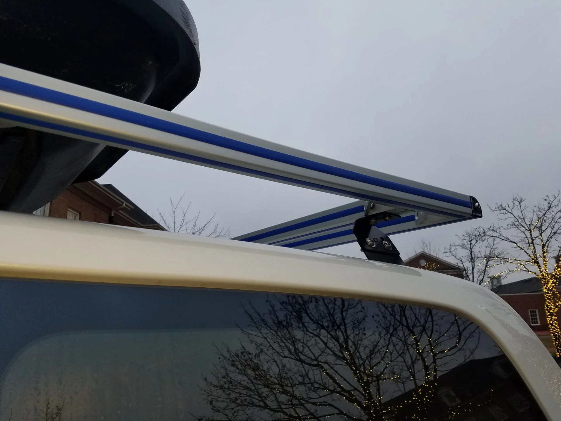

Couple of questions. @ylexot Do the channel inserts you have need to have an open end to be installed or removed? Also would you care to share some pics of the 4 outside corners of your rack? I have been considering building a similar setup and I appreciate any help.
@Nightbrew, not sure I completely understand the open channel question. The extrusions are open on the ends. I used Square nuts inside the channels to thread the bolts. The nuts bite into the inside edges of the channel and all you to torque down the hardware.
Here are a couple snaps of the corners. I used the triangular brackets at all the cross member joints. It is Hella stout. Somehow some non stainless washers got into my kit, which you can see if you look close. Someday I need to replace those.

Thanks. Maybe a better way to ask, do the inserts slide in from one of the ends or can they just be pushed in to the channel on its face? Or do they slide in, or just push in?
Ah-ha. The blue inserts just snap in from the outside. They can also be pulled out when needed.
I'm a little curious if they get brittle after a while. I have had these in for several years and haven't lost one, but you can see a couple are losing grip perhaps at the tail end. Someday I'm going to pop them out for an awning mount, then if all goes well, cut and reinstall. The blue ones are a harder plastic. The top has a black softer rubber insert to provide better slip resistance.
