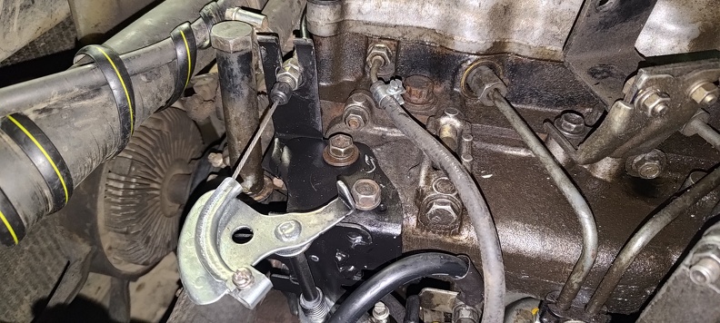

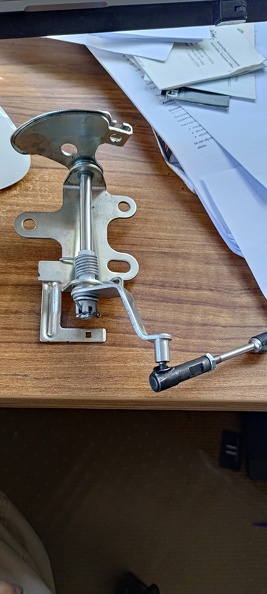

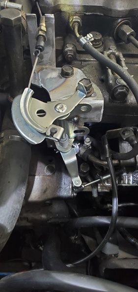

With the PS res getting a new home this meant I could try and track down a Megacruiser throttle linkage.. but they have since been delisted. I bought a 1hz throttle linkage which is very similar .. and went ahead and made a bracket to suit:
Megacruiser throttle linkage:
1HZ linkage:
My Bracket:

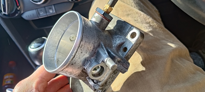

The point to moving the throttle linkage was to remove the boost leaks I was getting in the stock position.. so I got my intake tapped and plugged:

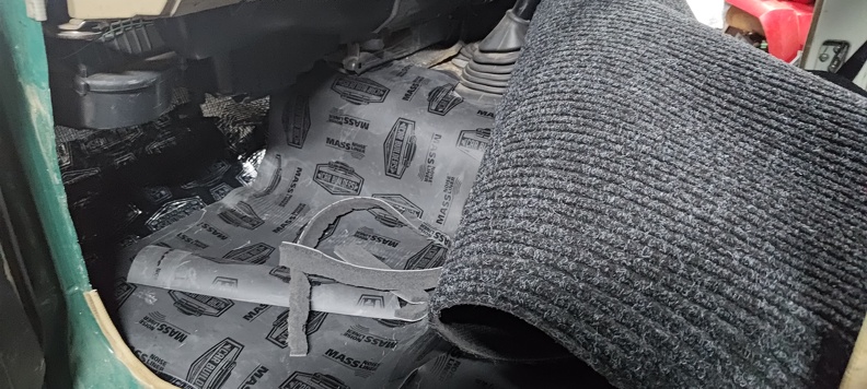

With a long trip on the cards I got the foam in the drivers seat (which came from the 80 so its 30yrs old) replaced.. and committed to carbuilders interior sounddeadening and mass noise liner, and marine carpet... the stuff that I had for rego was sad and didnt really do a good job, the wife would keep messing up the patchwork bits on the floor so it was time to upgrade:

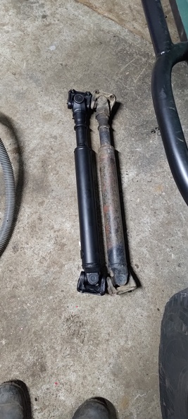

I had a spare shaft shortened after discovering I'd twisted another slip join on my rear shaft (the 3rd).. but have now figured out the correct working lenght so hopefully thats it for a while:
I'd like to get the dirty one re-done as the shaft is dented and carry that as a spare... I'll have to see how funds and time go.

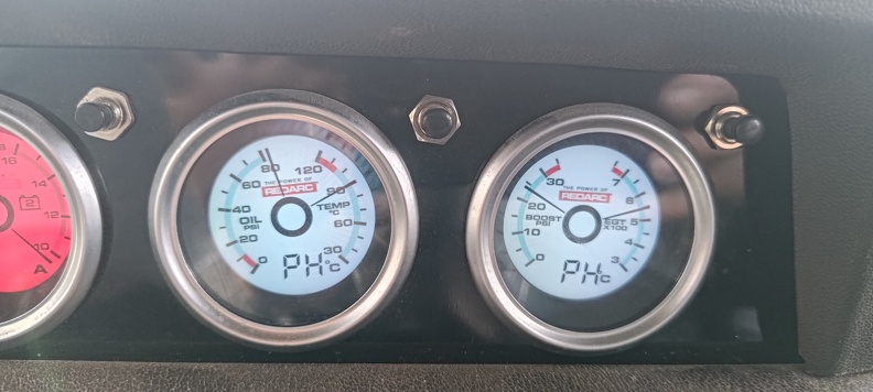

And here are peak values seen on one of those two drives I got in. I was still being very cautious having done quite a bit of work in the engine bay so need more seat. time before pushing it harder
1HZ linkage:
My Bracket:

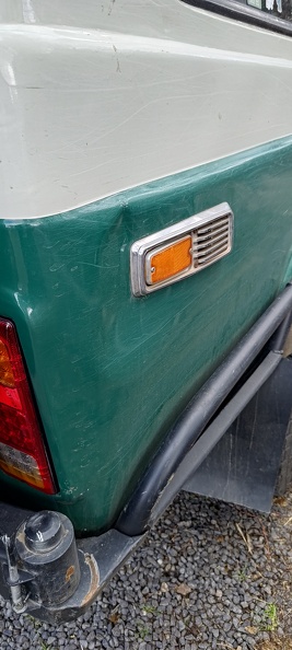

Okay, my take-aways from this post are; BBQ rack, pie warmer, and this pic:
Is that a 70 series 3rd brake light?
If so, what application?
I was looking at the one I put on my 40-series, and it did not look like it would work on my Pig roof line. I wonder if you have different angles on the rear of your roof cap w/ ambi-doors?

sorry to disappoint but this is just a photo from Koas website showing how the pie warmer hangs from an internal roof shelf. ill be travelling with Miss 11 so any tasty treats I can heat while we drive means food when we arrive at our destination.

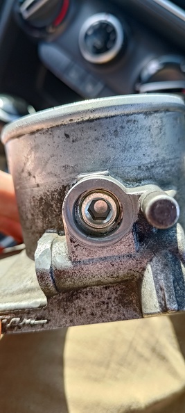

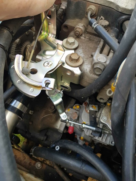

went for a long drive with the kids yesterday.. not happy with the first attempt at my throttle linkage as it puts it about 1/4 turn into its stroke so moved the linkage about 1inch away from the pump. this means the linkage is at rest at idle and the acc pedal doesnt need as much force.
1st attempt
2nd attempt

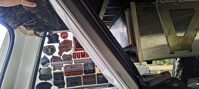

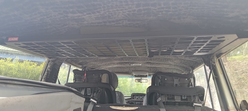

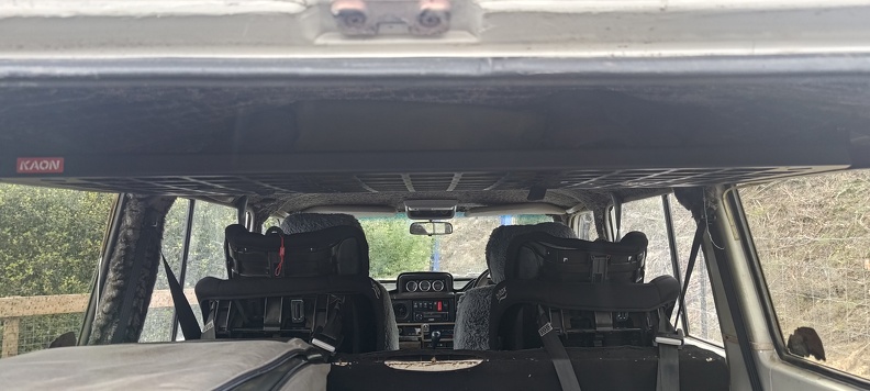

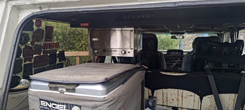

Rear cargo shelf installed..
It doesnt obstruct vision at all.. its an 80 series generic shelf with 65x35x2.5mm RHS on each side to make it fit the 55 roof..
With that in place I can now add the pie warmer!
Accessible with the rear door open and allows the fridge to open all the way too

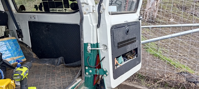

Got some 3mm haircell ABS plastic to do door trims.. here is a work in progress shot..
Also forgot to latch the rear before fixing the spring stopper on the spare tyres swingout.. :(
Going to try and get a football in there to pop it out..

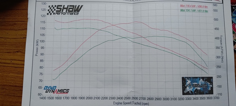

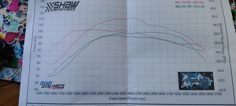

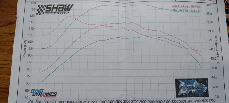

Lastly.. I got on the dyno today to see what the new injectors are doing re AFR's..
Definitely a lot richer (too rich after 2800rpm) than it was before..
20psi boost at 1500 :P

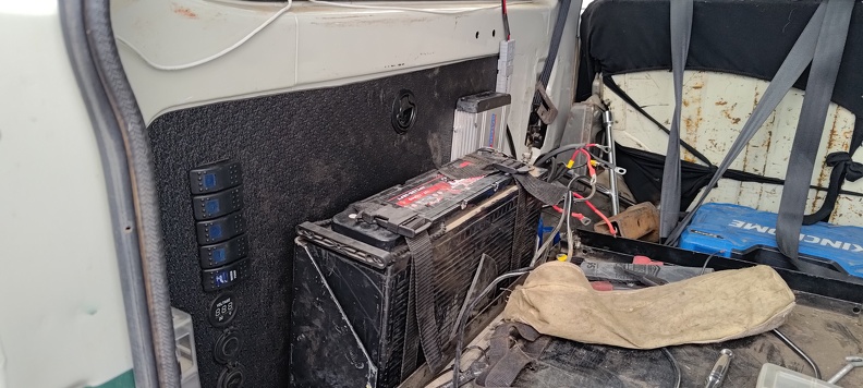

Bit more work on the interior this weekend..
I've still got to wire up switches/sockets yet but cables are run.
And hiding behind the interior panel..
