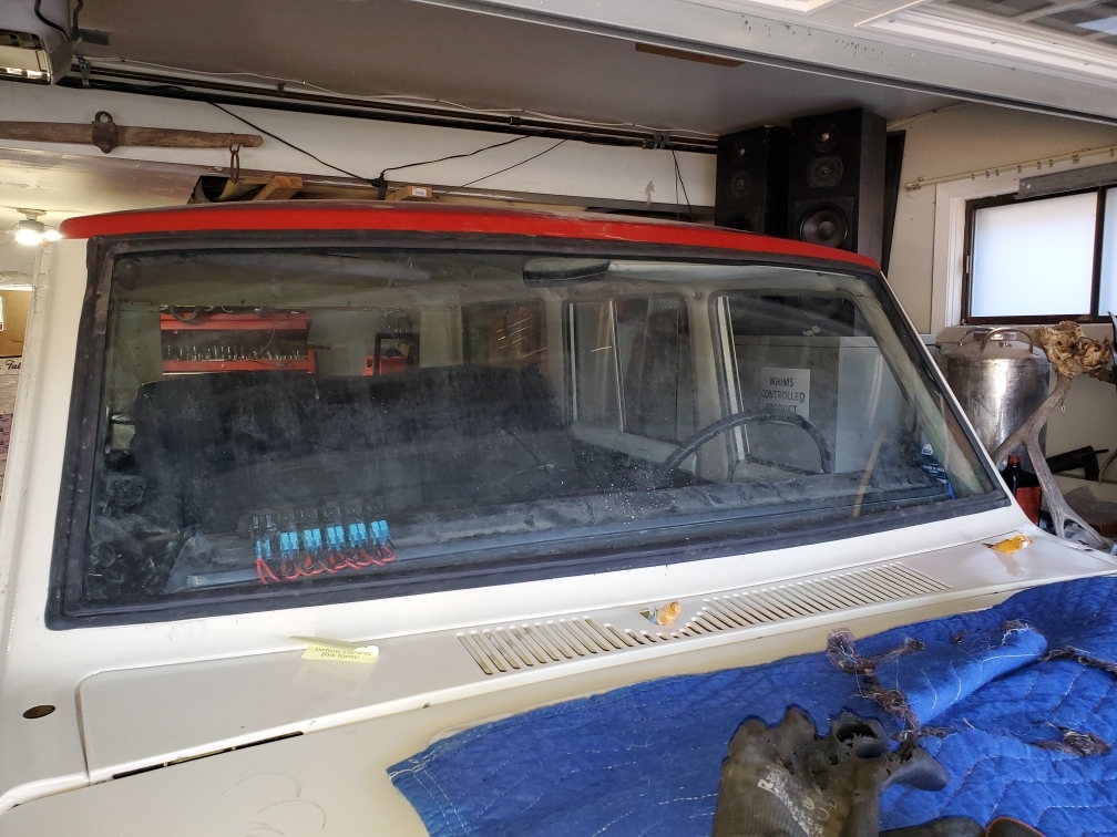

@brisveganbj42 no, mine was stock and the windshield was an early one - I posted to let you know that even if stock, they don't necessarily go in easy. I don't mind beating on a windshield, but it was so hard to find one I was afraid of it so paid a guy. I was also surprised that I had to pull the outer lip up after install to get the seal - never had to do that before either, almost would have been easier to rope the outside too. This is as far as I got mine (see top right) before I gave up.
