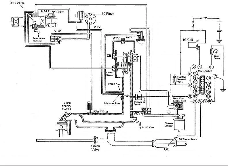

The short answer is, you can delete everything but these:
You can even delete the "computer", if you route 12v switched with the ignition to the fuel cut solenoid.

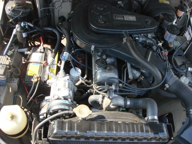

My '77 desmog went from this:

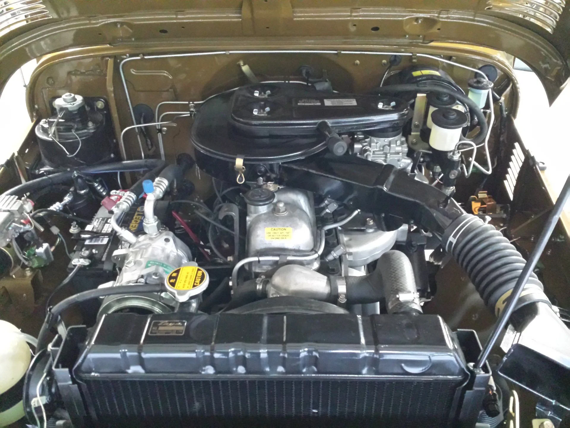

To this:
In the link that @iptman posted above, to @FJ40Jim 's desmog parts, his kit includes a plastic cover for that hole. Unfortunately, mine split and fell off after while. It's just open now; an extra source of air but still filtered by the air cleaner.
How do you figure that? If it's between the filter and the carb it is a filtered air SOURCE, not a filtered air inlet.
If your talking about the air pump port on the air cleaner assembly, that being open would be an unfiltered air source to the carb.
Uh, OK, I guess I'll have to go back and look more closely. I thought that the port comes in the air cleaner housing outside of the paper air cleaner, but it looks like you guys are right.
Those nylon caps can be had from McMaster Carr. You'll have to buy 10 probably but less than $10 for all and set for a while.
