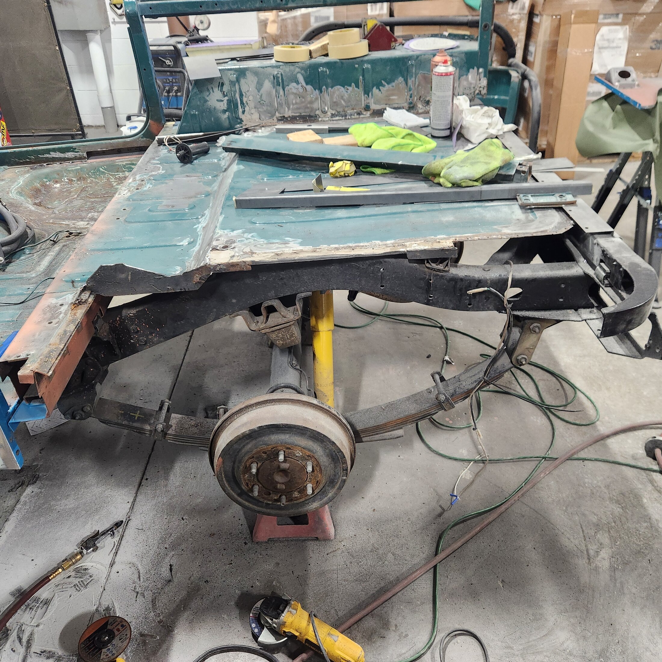

Where the front and rear tub meet a box that runs the width of the truck and incorporates 2 body mounts. The front lip appears to have good metal. The rear floor is rotted at this seam . The 3rd piece that incorporates the body mount is rusted especially on the drivers side.
I am looking for photos of what others have done to repair this. I have some ideas but previous experience on a specific repair is valuable. I can weld and fabricate so I'm not looking to do scab patches.

I sloppily cut out the main channel from the bottom. Then i was going to use something jeep cj bumper C channel and add gussets. In my search for a bumper, a friend offered to make/break some real thick sheet and made piece of C channel. I capped the ends and added gussets. I bolted top of it to the tub using the seat mounting towers holes and the frame mounts on the bottom. Pardon the crappy pic.
Looks good. I was going to do the repair that way, but decided to use the C channel and leave the cavity open so I could hose it out.

thats impressive to be doing that with the tub on the frame - i know from my own experience with this same issue. my floorpans were toast so they had to come out. crawling under the truck i could see massive rust in those seams so the only solution was to cut.
when i got the midbed side cut out the channel was FULL of dirt - 50 years worth - it sits in that channel wet and rots the point where 3 pieces come together, its a perfect rust breeding area. you have the channel support, the mid-bed and the floorpans all attaching right there.
