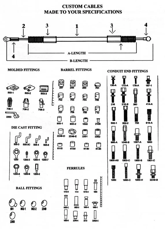

parking brake cable,
Lots of options here just about any automotive cable place could get you something made with ends that are close, we also have a few guys parting out a few rigs and there is a good chance one of them have something usable.
speedo cable,
I believe @LAMBCRUSHER converted a 60 cable to work, hopefully he'll be along shortly and get me straightened out, if not I know I've been looking for some hard to find speedo cable ends for one of my projects and I'll post the links here to a few of the companies I've found that make custom cables.

I want to say California Push-Pull makes custom cables...
Thanks for the info I'm sure I can get something to work. I dropped the springs off to be rearched and cleaned up Friday. I'm putting a powerslip locker in the rear end just for the F of it. I know these are some of the weaker axles but I'm running stock tires.
