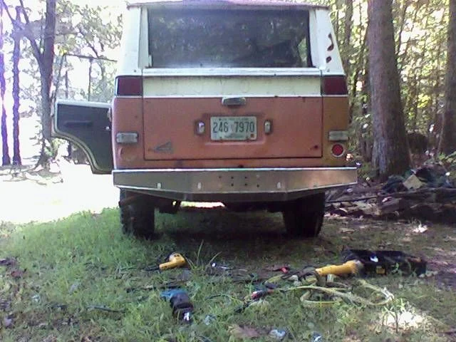

Here's an older picture before bumper, etc. You can see the extensions bolted on from the side. If you need close ups just holler.
Hey do y'all remember if the factory winch needs frame extensions on a FJ55? Anyone have pics of one mounted?
You need frame extensions or you need to modify the factory bumper or use a non factory bumper. Those are your choices.
It's funny I totally already bought the frame extensions didn't even remember. I found them and ground off those stupid factory rivets.
Also I found myself looking at some of the factory welds with wire and splatter and I was like did someone repair this frame? Then I remembered.....there wasnt any robotic welding in 1972 lol. I'm used to newer cars.
