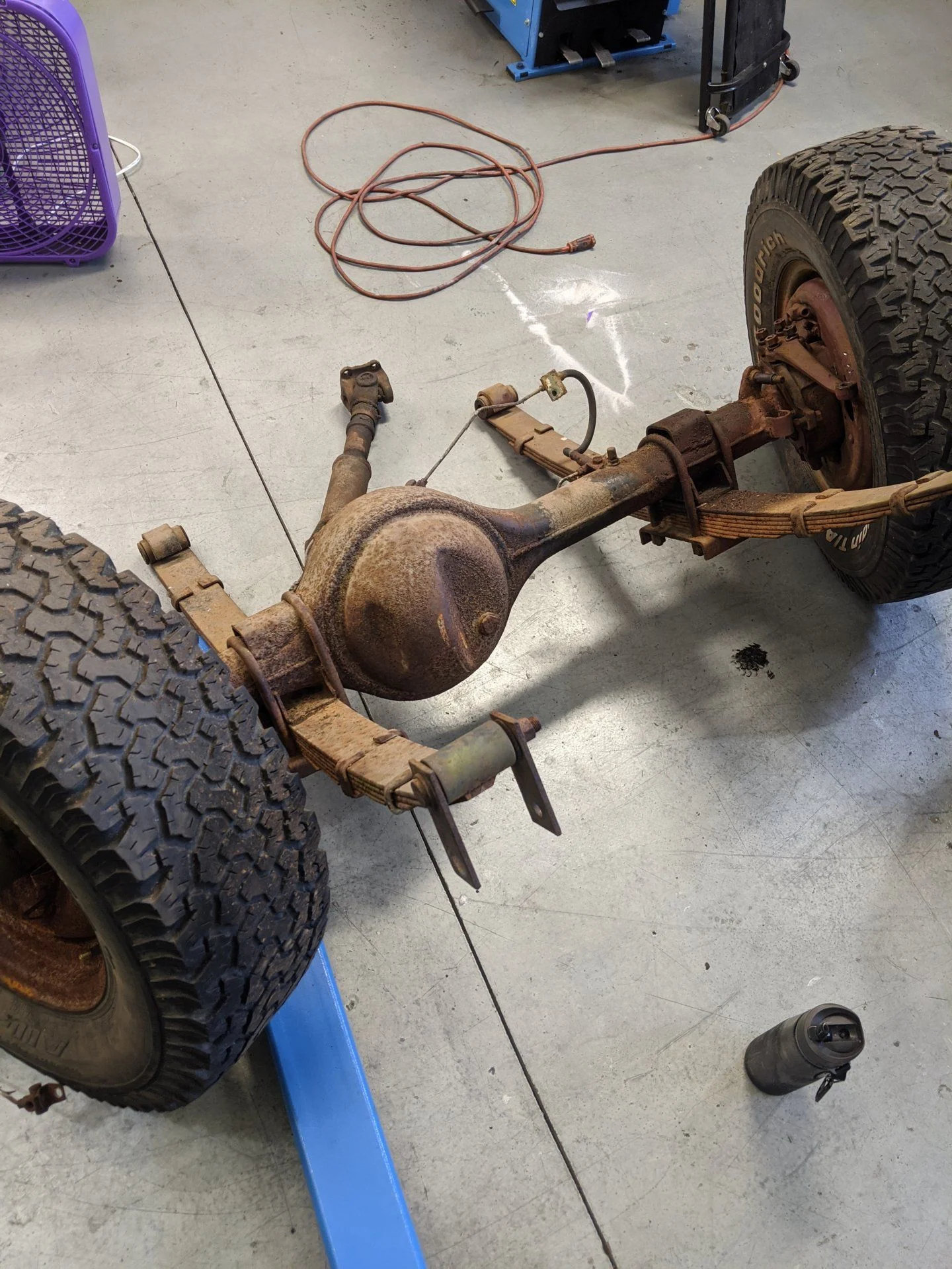

My first question is the leaf springs. They don't look sagged at all but I want to restore them, is there a guide or suggestions on taking them apart putting new stuff in and putting them back together or should I just sand blast and paint them as is and leave it alone?
Many years ago, I had my rear springs re-arched by a Blacksmith/spring shop. Had them add another leaf too.

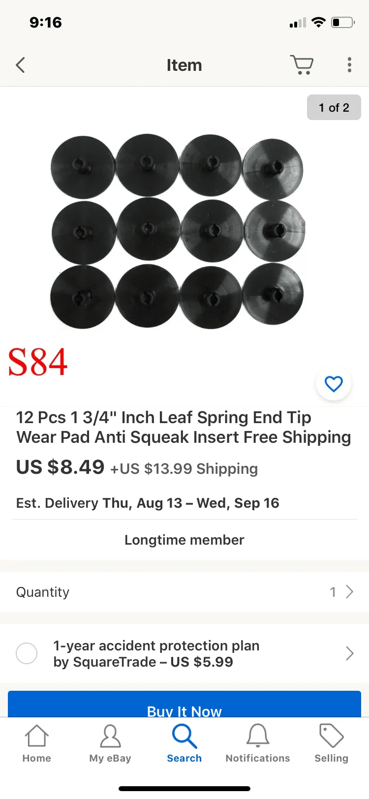

I can find “tip pads” pretty easily on eBay, but unless your springs are already drilled to accept those, not sure how much of an undertaking it would be to drill holes in spring steel.
This is what I could come up with in a quick search for teflon anti-friction pads. Looks like a roll of material you can cut to length and place between the leaves. I’m sure there’s some better stuff out there.
Morning Spyder,
Before we get too deep into this, what type of rebuild are you planning? Stock or modify as you go, bigger tires for more offroad stuff or just coffee getter. No sense to rebuild stock springs if you're going to upgrade everything else. I bet the stock springs have sagged over the years and maybe even have a couple cracked leaves in the packs.
