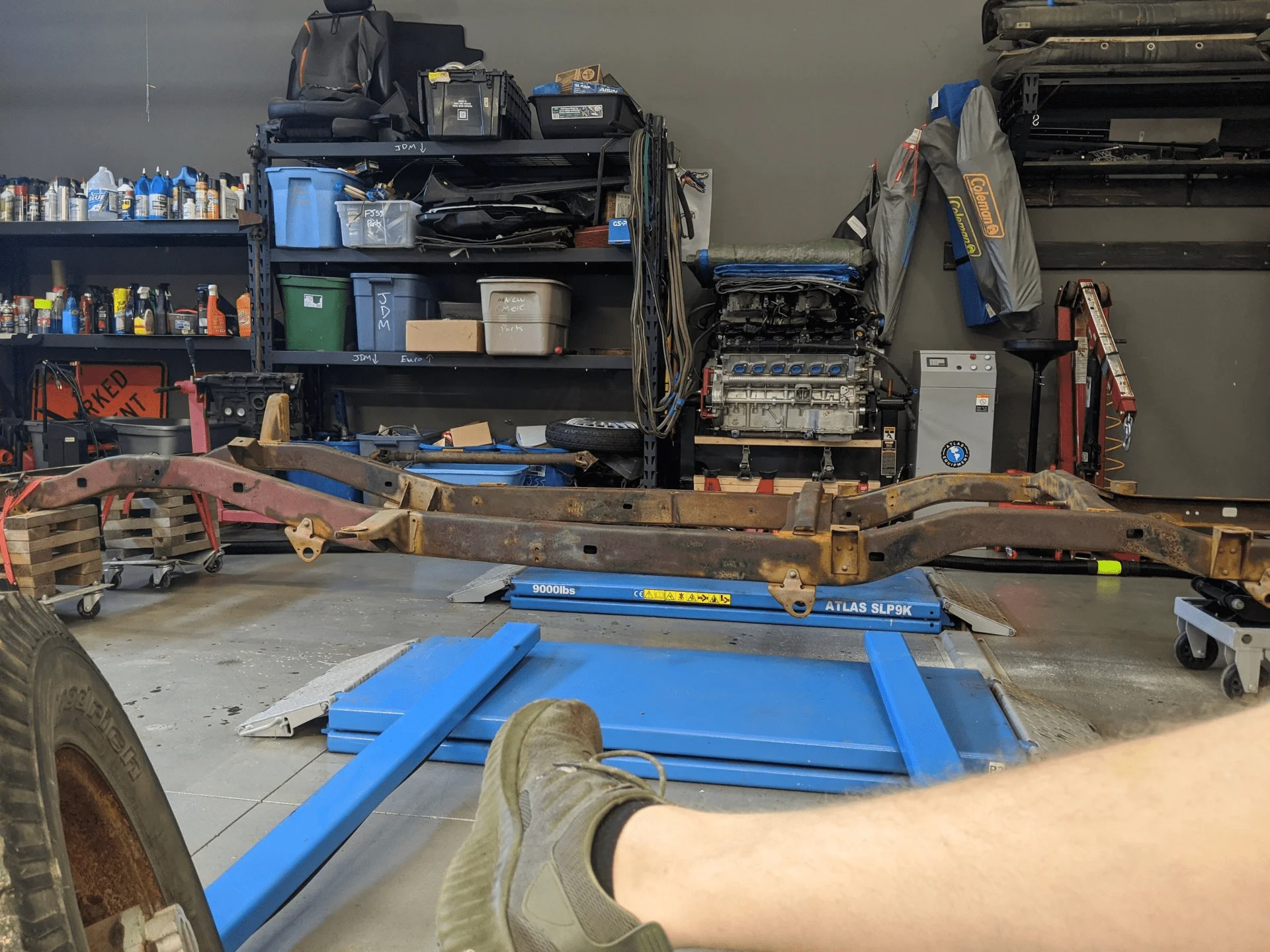

Why are we only seeing this now?
Kind of still being a DICK, he did give the pictures we asked for in a timely manner and didn't call Bob M names.
@mk1spyder is OK in my book, I’m still hoping he has a Lola T70 and will share those pictures too if we play our cards right.

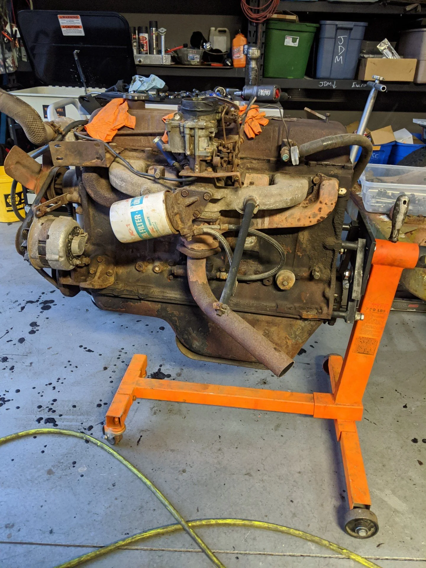

My main rig, and I really want to keep the kmart oil filter on the 1.5F lol

Days right. We don't don neakers here!!! Crocs,sandals or flip flops! Dems da rules 🙄! Oh and plenty o 😉 pictures undastoood🐷🤨🧐😒
Yep, get you some man-dels for wearing in the garage. That way the gentleman from NH @bobm will know you are of questionable lineage.

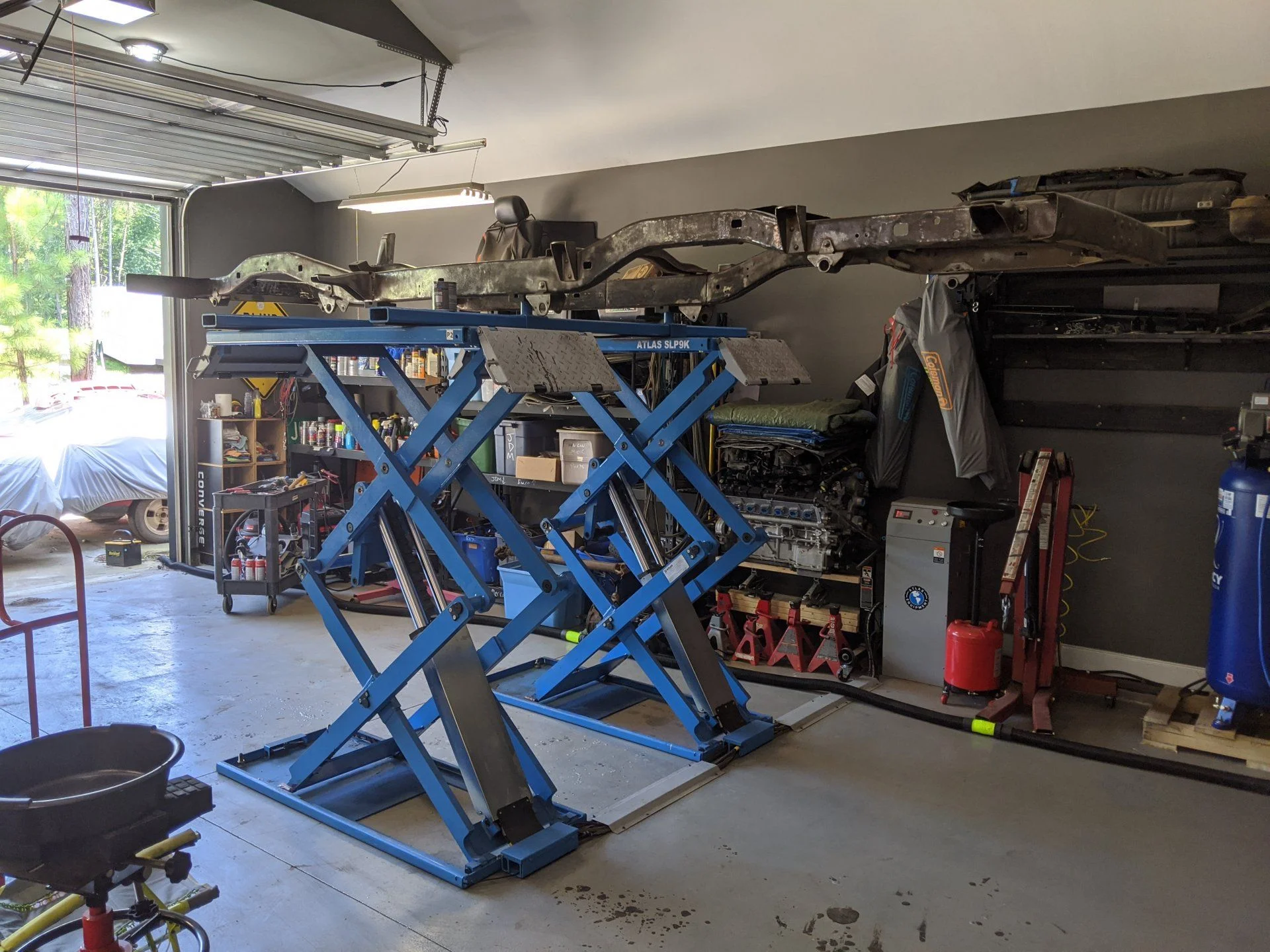

Tell us more about the engine we see back behind the Pig frame:
