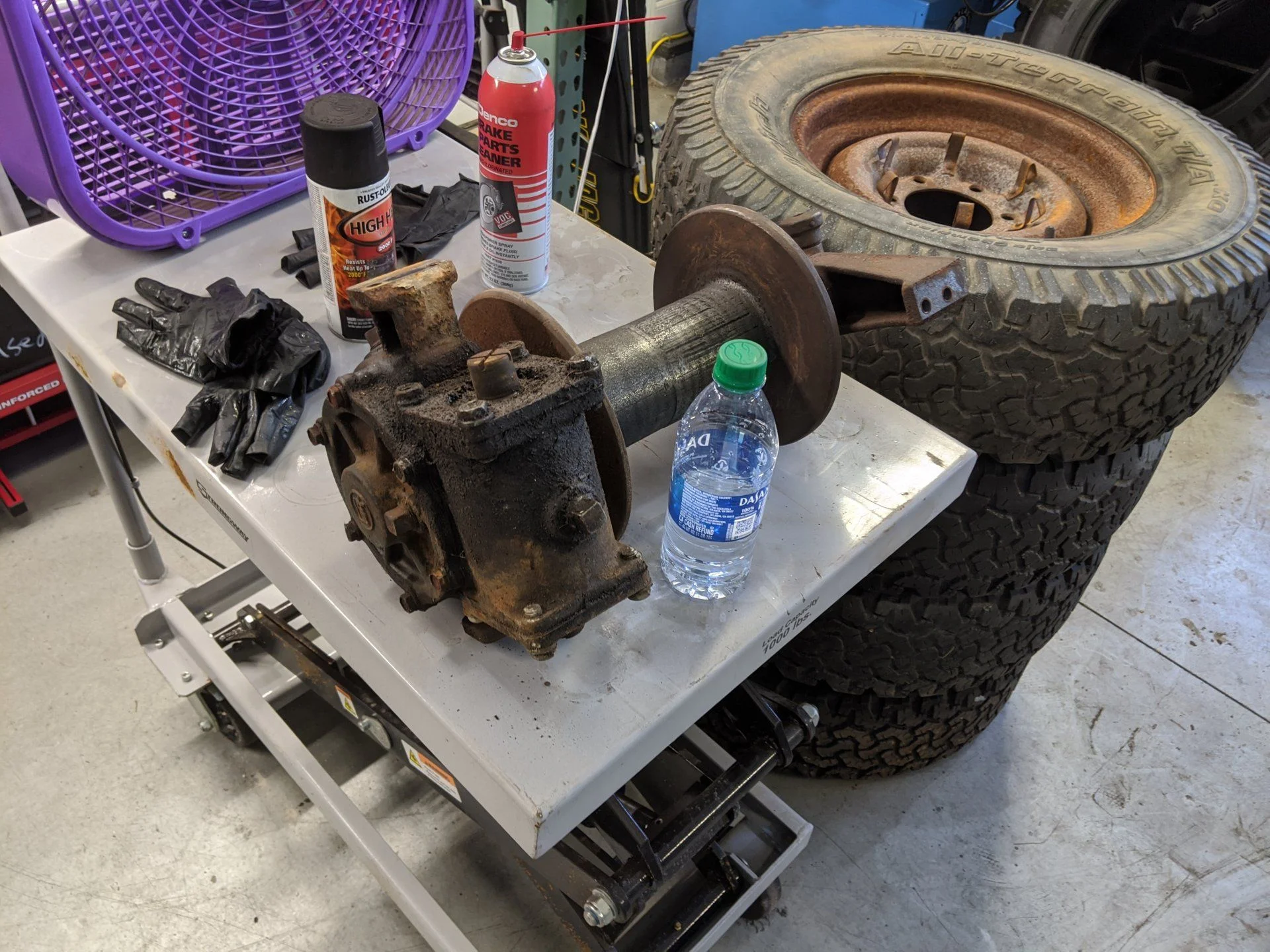

Does anyone make a rebuild kit or gaskets for the factory winch or am I making my own? It works fine.
