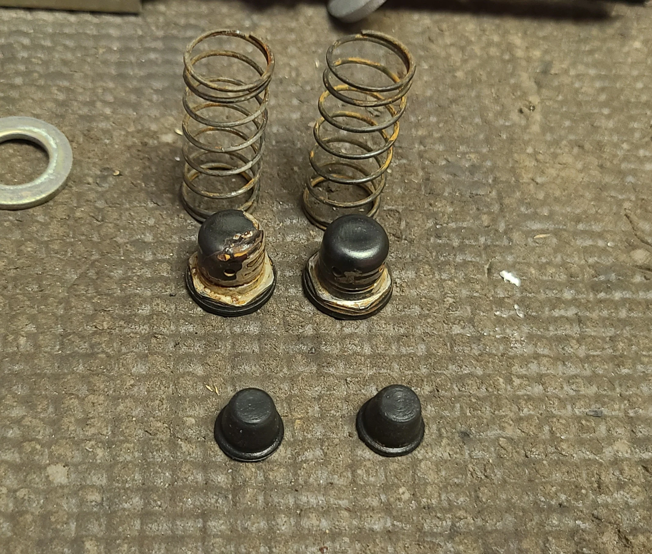

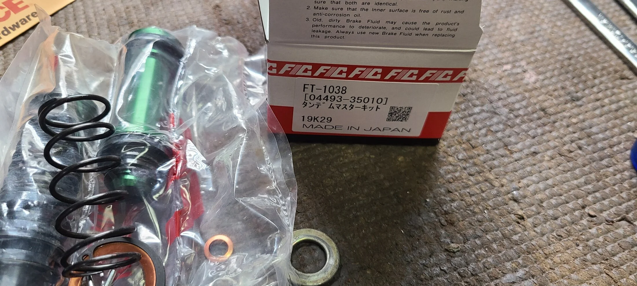

Ordered a rebuild kit thinking it would come with them but it didn't. Anyone out there have a bad master cylinder and wouldn't mind scrapping these for me? One of mine has a hole in the rubber cap.
Did you get an OEM kit?
No. Bought this kit that had what looked like pressure valves in the picture but are just caps of some sort.

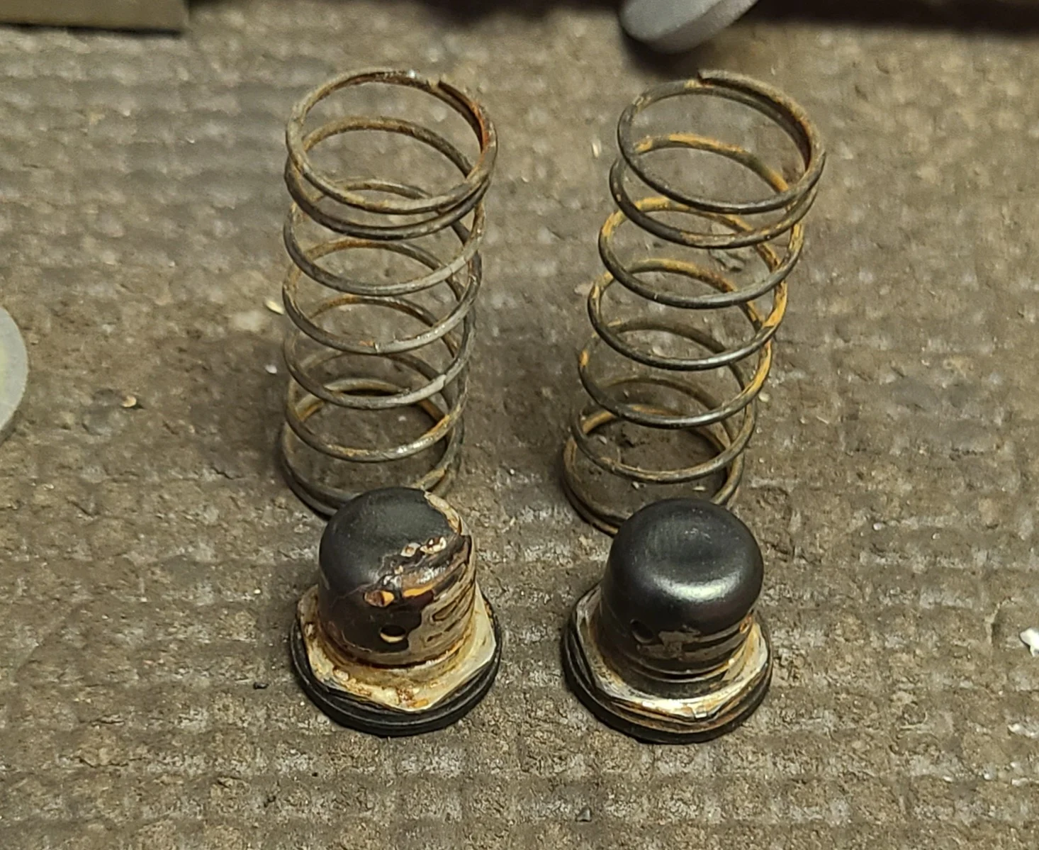

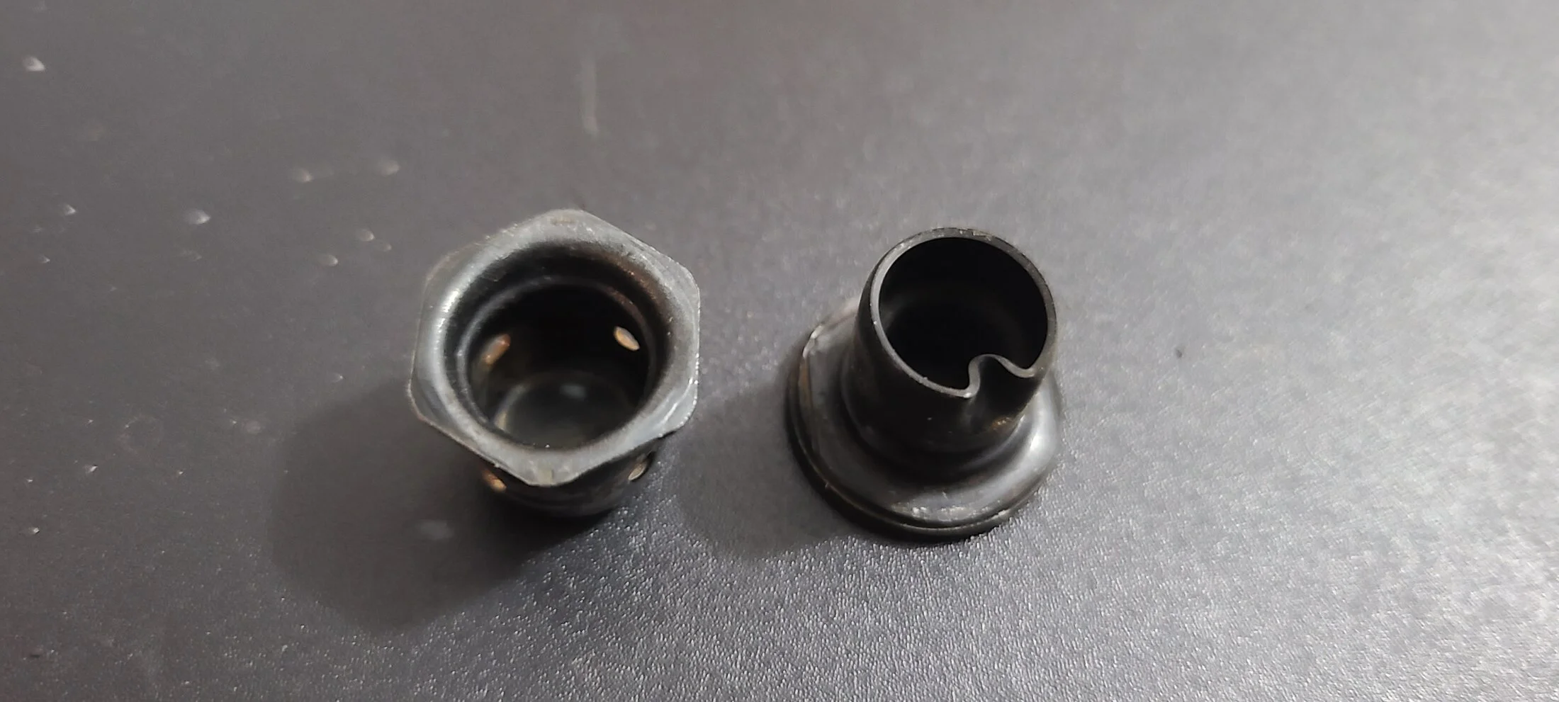

I took apart the valve and found that it doesn't have a hole in it. It has a crease that folds in instead of sitting flush against the body. I may try to rotate that liner 45deg and put the crease defect in between the two inlet holes.
