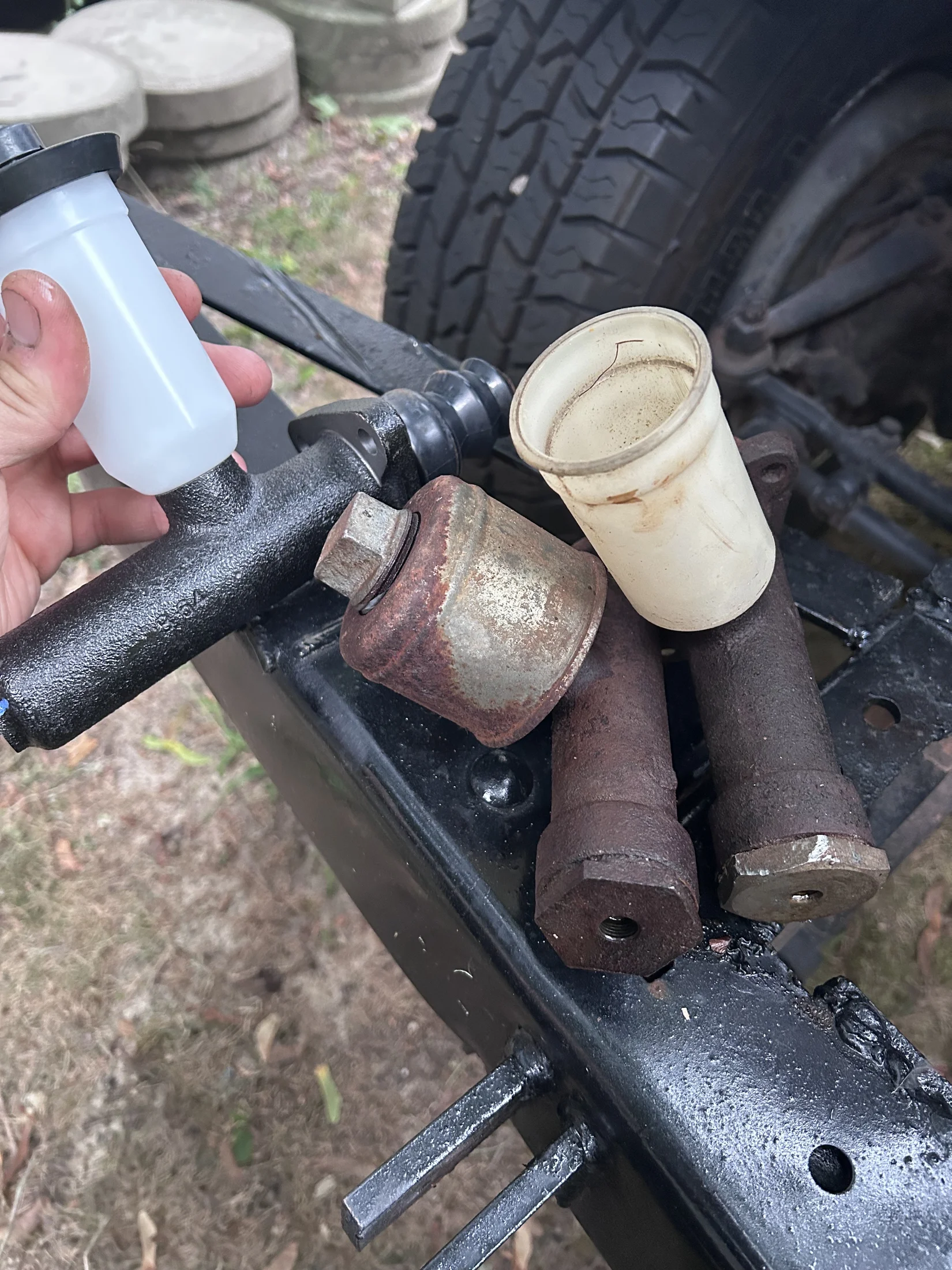

I've purchased 3 master cylinders hoping to get what I have (or something that at least fits in my truck) with nothing but issues. I purchased 2 Centric 130.44730 as this forum suggests will fit and I get a completely different part. I also purchased one from Man A Fre that said it would fit any 40 before '70, also didn't fit.
I have the tin cup style clutch master in my truck and cannot seem to source a replacement. Does anyone have one lying around? Bonus if you have a brake master as well. TIA.
What I ordered vs what I received:
What is the problem you are having? Is the fittings from the hard line to the master?
on my 64, I used Spector Off Road part # 018-01-KIT for the clutch master, it comes with the master(its a latter model part), new hard line, soft line and new slave. it gets rid of the 9mm(or were they 11mm) fittings. this also cured my hard clutch pedal because the master and slave were different bore sizes
its the 1st one listed on the page
for the brake master I am pretty sure I used Toyota OEM part# 47200-35011, which has the original 9mm fitting., I did not have to change the hardline.

The fittings up until 69 model year (so mid-68 build) were 9mm. All over everything. They switched to 10mm and haven't looked back. Don't bungle up yours as they don't come up for sale often. Either that or there's just a bunch on dusty shelves - it's a common swap for parts availability.
If your's passes the fingernail test for rebuild, that's where I'd go.
