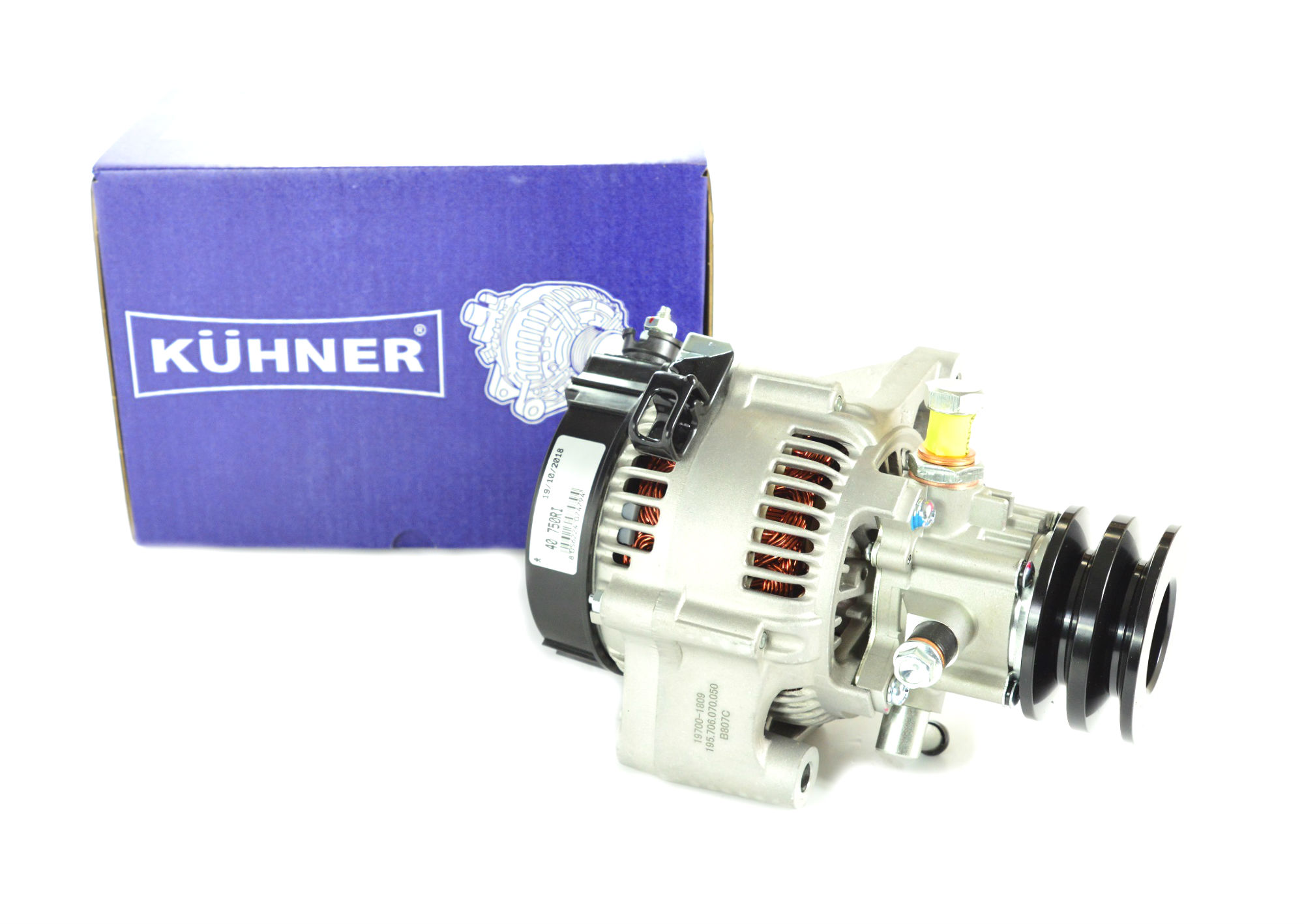

So, as it turns out, there was a 70A alternator offered on the 2LTE in the JDM cars the motor came in. This 70A alternator can be bought for a reasonable price here: Kuhner Premium Diesel Alternator 12V 70A - Round Plug
Has anyone tried this alternator in their LJ7x cruiser? Wondering if anyone has experience with it. Hesitant to drop the $$ without some sort of review. From the Megazip website, it appears this alternator is longer (to accommodate the larger stator).

Thought I'd update here. The vacuum pump on my OEM rebuilt 55A alternator was starting to make some very unhappy noises on morning cold starts. So I broke down and bought this alternator. Price was really quite reasonable thanks to the hurting british pound. I installed it on Saturday.
The body is substantially longer than the original, but I can say the alternator fit well. It does come within a few mm of the oil feed fitting on the engine which feeds oil to the vacuum pump.
The only issue was my original alternator has a round plug, but the new one was oval. I swapped the plug/regulator between the two which was simple and seems to work just fine. I did have to trim the cover a bit (soft aluminum) to fit the round plug.
This swap was a great investment. The extra current is very noticeable, and my voltage gauge doesn't dip at idle with high electrical load anymore. I think I've got better vacuum too, as my brakes feel much better than they were. I think the extra current will be good when I tow (charge) my RV next summer again too.
Some pictures:
