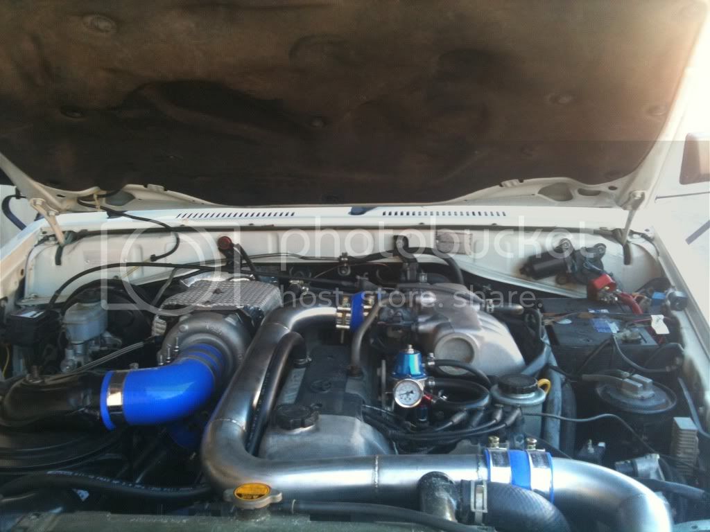

Like the title states, I'm looking for pictures of a 79 or 75 or any other 70 series that runs the 4.5 1FZFE engine. I am looking for as much detail as possible for a point of reference for my 79 body onto a 1996 FZJ80 with 1FZFE frame and drive-train build.

if you want some side on shots with measurements yell out ,
Hey clint is that a stock FZJ air box lid? What is the diameter of it? Does it take a Ryco A340 filter like most other cruisers? I am thinking of getting one to use on my BJ74 for slightly better flow rather than the squashed type standard one.
The one on the left is fj hzj hj and has a large squashed area as you can see, the fzj intake size also has larger diameter intake on the lid and also air box intake, I can't remeber the size of the fzj lid intake but i cut the end of and welded a 3" pipe in it to suit turbo intake which is also 3"
welding the lid is a mega pita as it's really thin metal
the air box intake is also bigger on fzj ,
the hdj also run smaller snot
not sure on vdj?
