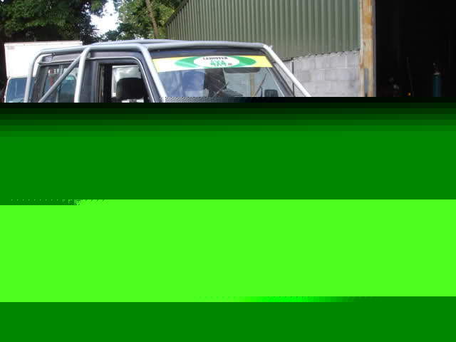

This has to be a new record. i built this cage during the week for a customer, he picked the truck up on Friday, and flipped it on Sunday :bounce2:. it was only a light roll, and everybody was ok, cage did its job and saved most of the body work.
Its a full exo cage, bolt on design with 4x2 rock sliders. its on 5mm foot plates and is held down with 19mm bolts, two per point and bolted on eight points. four on the sliders, two on the rear bumper and two on the front. its made from 1 7/8 tube for the main frame and 1 3/4 for the supporting bars and the front end.
heres the pics, and a video of the roll, :biggrin: enjoy, :beer:

Ahh I can see the bolts on the lower ends of the bar work.
