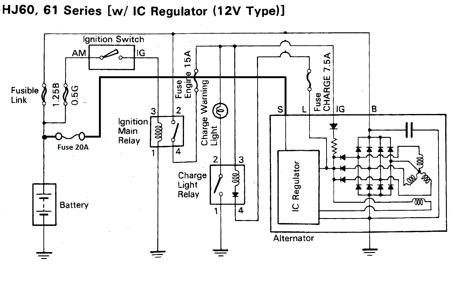

Could you send your electrical connection drawing?
The externally regulated alternator wasn't working and the voltage regulator was aftermarket so I pulled the pin on a new internally regulated alternator.
This is my current wiring to the best of my knowledge I haven't split the loom to trace each wire but the wiring inside the loom looks original and is colored correctly according to wiring diagram inside my manual. I have only added the sense wire with a blade fuse.

This is the alternator I'm working with and I don't think B+ would run through the 16AWG sense wire and pigtail without melting it but 20Amps does seem like a lot...
