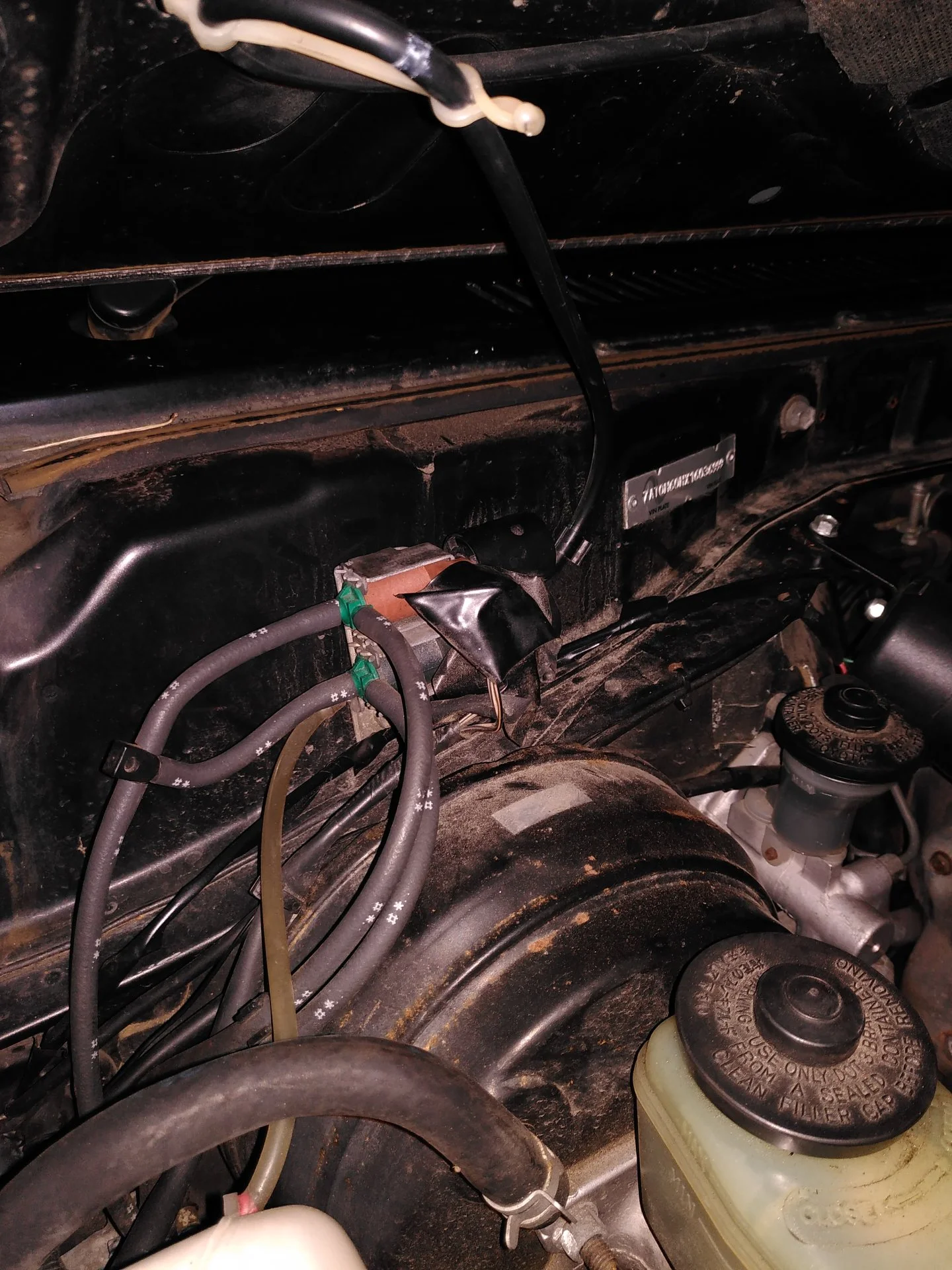

Hey, have you got any pictures of this? My transfer case won't engage and I guess the vacuum lines is where to start!
Thanks in advance!
The hose that splits into two to each vsv is the vacuum source. The other two hoses will engage or disengage 4wd depending on which one gets vacuum. Just connect vacuum source to one or the other using a small coupler.
