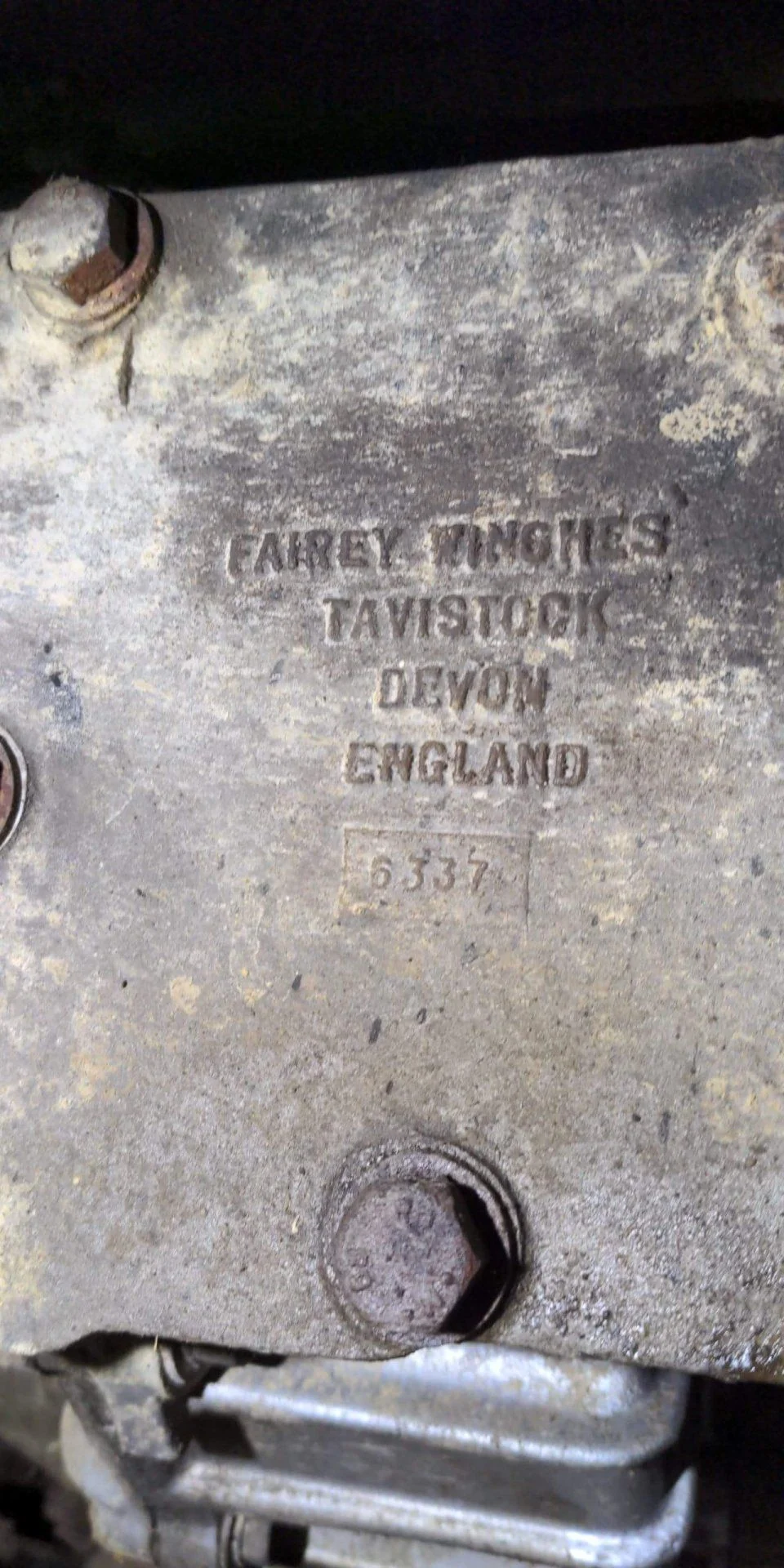

I have a 84 fj60. The guy I bought it from told me the original owner hated the 5 speed and got a 4speed with a overdrive installed. I know nothing about this overdrive. The picture attached is of the side of the tcase. I looked up that company and they seem to have been popular with Land rovers. The transfer case look stock aside from this plate and having a 3rd lever inside the vehicle. The tcase is leaking and I need to reseal it. I'm wondering if this would be a toyota transfer case with some aftermarket inner workings, or if the whole transfer case is aftermarket? Would anyone know? And where to get gaskets and seals for it. Thanks
Toyota transfer with a Fairey Overdrive, they were somewhat popular over here.
Okay thank you! I just wasn't sure what to look for as of gasket replacement. But being a toyota one it makes it easier to get gaskets. Shot in.the dark, but would you know why a guy would want to remove the original 5 speed and put in a 4 speed and a overdrive? Doesn't make sense to me
