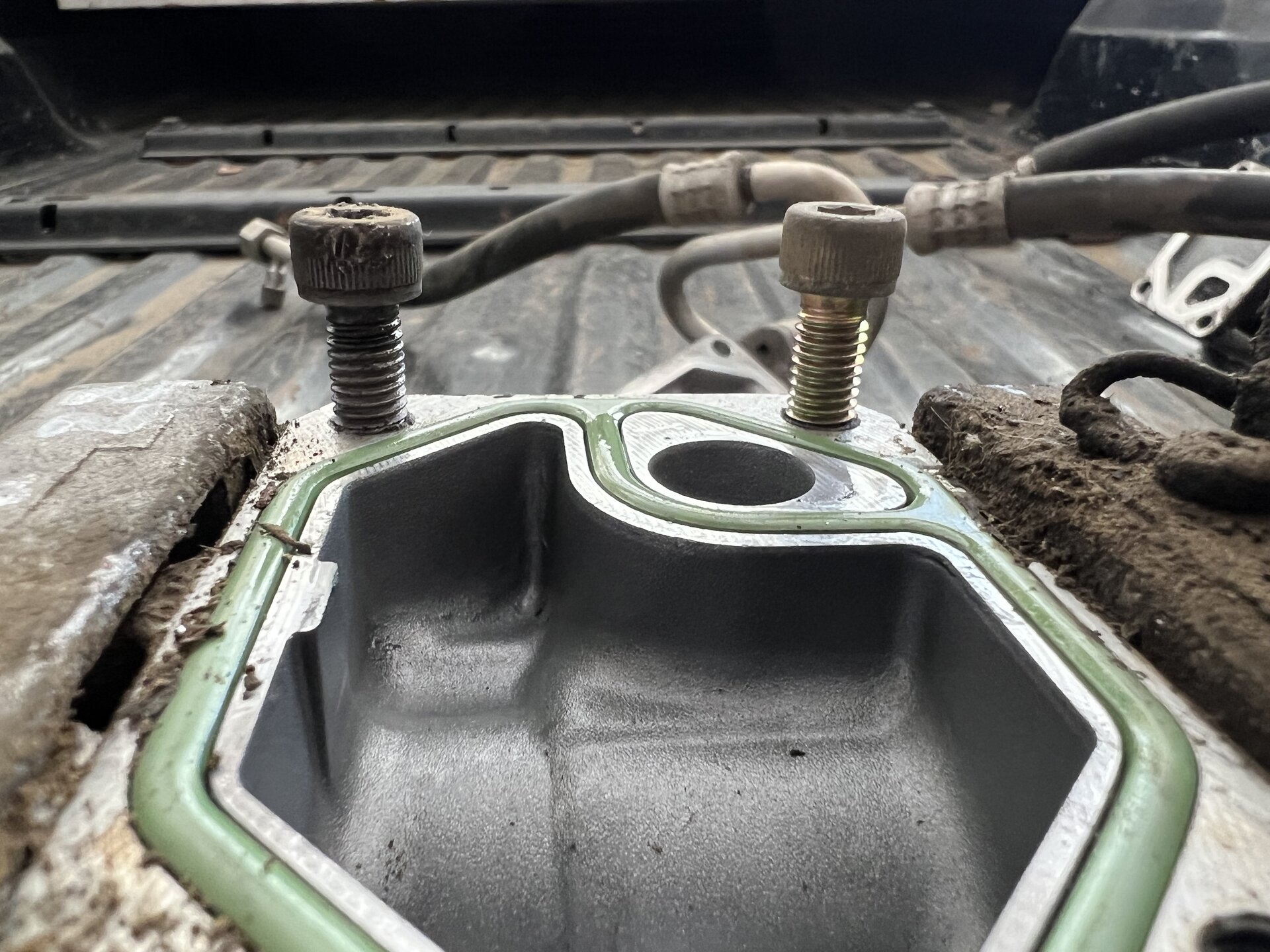

To add some more AC information, you can use the top plate off of a 1989 22re AC compressor with at least a 1998 4Runner AC compressor for the 3RZ. It’s a direct bolt up and even the threads for both compressors are the same. In all the photos the 22re compressor is on the left. For the photo with the top plates, 3RZ is the top and 22re is the bottom.
I will update later this week if there are clearance problems with TOS 3RZ motor mounts.
Installed the TOS mounts, the top photo is with the 3RZ compressor (Denso part 447200-5450). Bottoms photo is the 22re compressor (Denso 147200-0202), all four bolts line up as well.

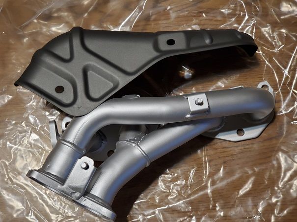

Since you brought up the header type manifold on the late 3RZ. The cast manifold used in the pre-2000 trucks was prone to cracking. In 2000 Toyota went to a header style that looks just like the Doug Thorley, but is significantly less money. Mine have been ceramic coated.
Exhaust Manifold, 17141-75080
Exhaust Heat Shield, 17167-75100

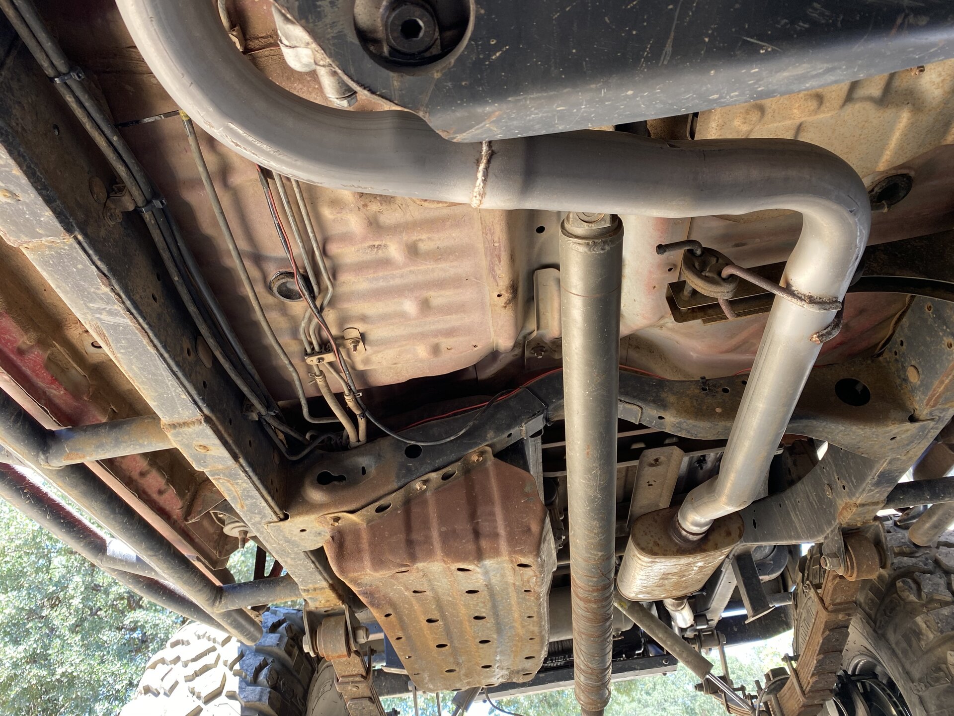

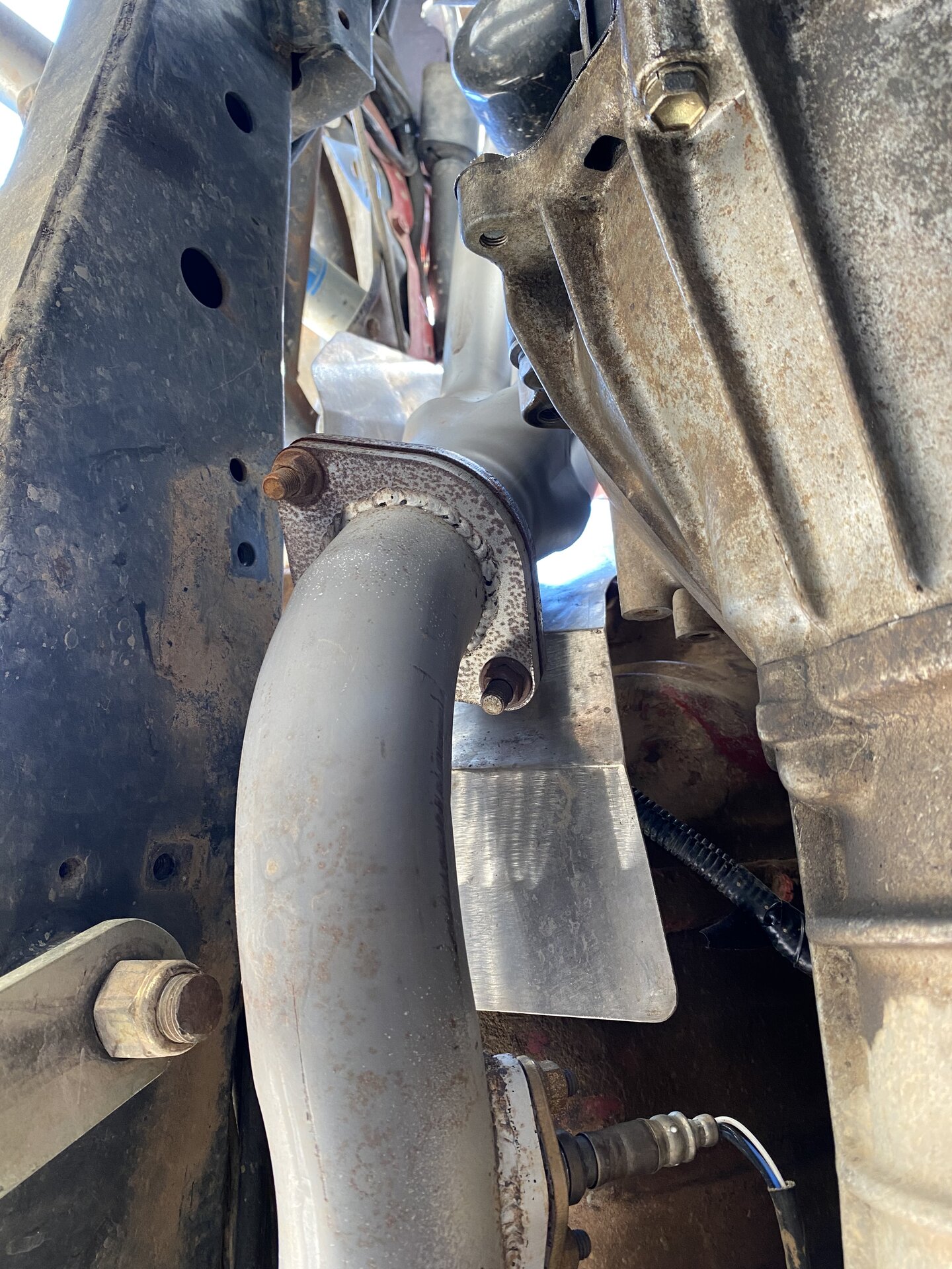

Exhaust system pics in the quote below using LCE 3RZ swap headers on a 3rd gen pick up. This unit passed CA BAR smog referee inspection.
Some notes for success:
Ref wants to see catalyic convereter in the original spot. Their standard is the inlet flange being +/-3" of OEM distance on the donor vehicle.
O2 sensors must be in original location (distance) from cat flanges AND must have correct angle orientation as donor vehicle.
After the post cat O2 sensor, you can run it how you like.
edit to add: When speaking with the ref on the phone I asked him how he determines the location of the cat and the distance of the O2 sensors. He said they look at the exhaust diagram from the manufacturer and eye ball the cat locations/distances from the OEM header flange location. They then "eyeball" the +/- 3" figure for the O2 sensors. He was specific that clocking orientation of the O2 sensor does need to be roughly same as OEM.
