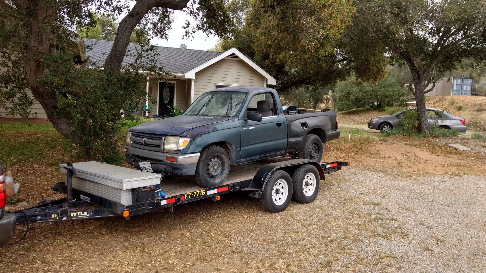

Donor truck 2001 Tacoma Prerunner Auto that had been rolled but only had 25,000 miles.

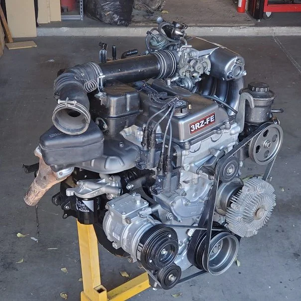

My goal was to keep this motor as stock as possible so it could not only be reliable but easily and accurately serviced via obdII scan tools. I live in California and need to have it pass the Referee.

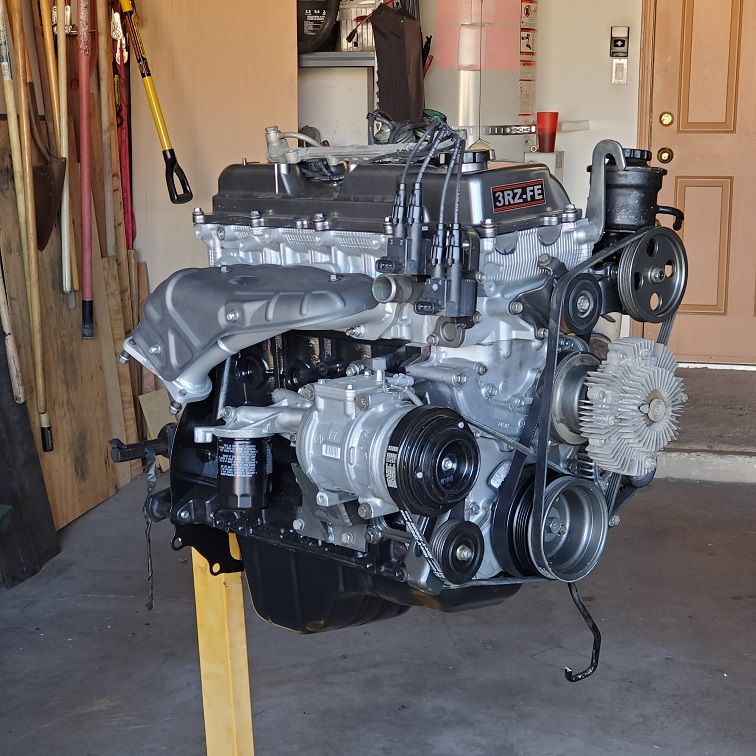

3rz/2rz Types
From what I've learned, there are three main versions of these motors with possible slight differences throughout
95.5-97.6- distributor
97.6-2000- 2 coil pack
2001-2004- 4 coil (COP) 2 cats, header type manifold
(4 coil started in 2000 in California)

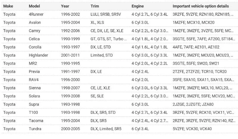

Here is a junkyard list of all Toyotas that use the same valve shim discs.

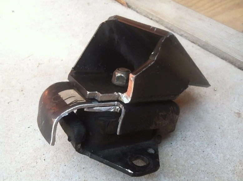

Motor mounts
Some people buy them, some people make them. it's up to you. I prefer the TOS ones.

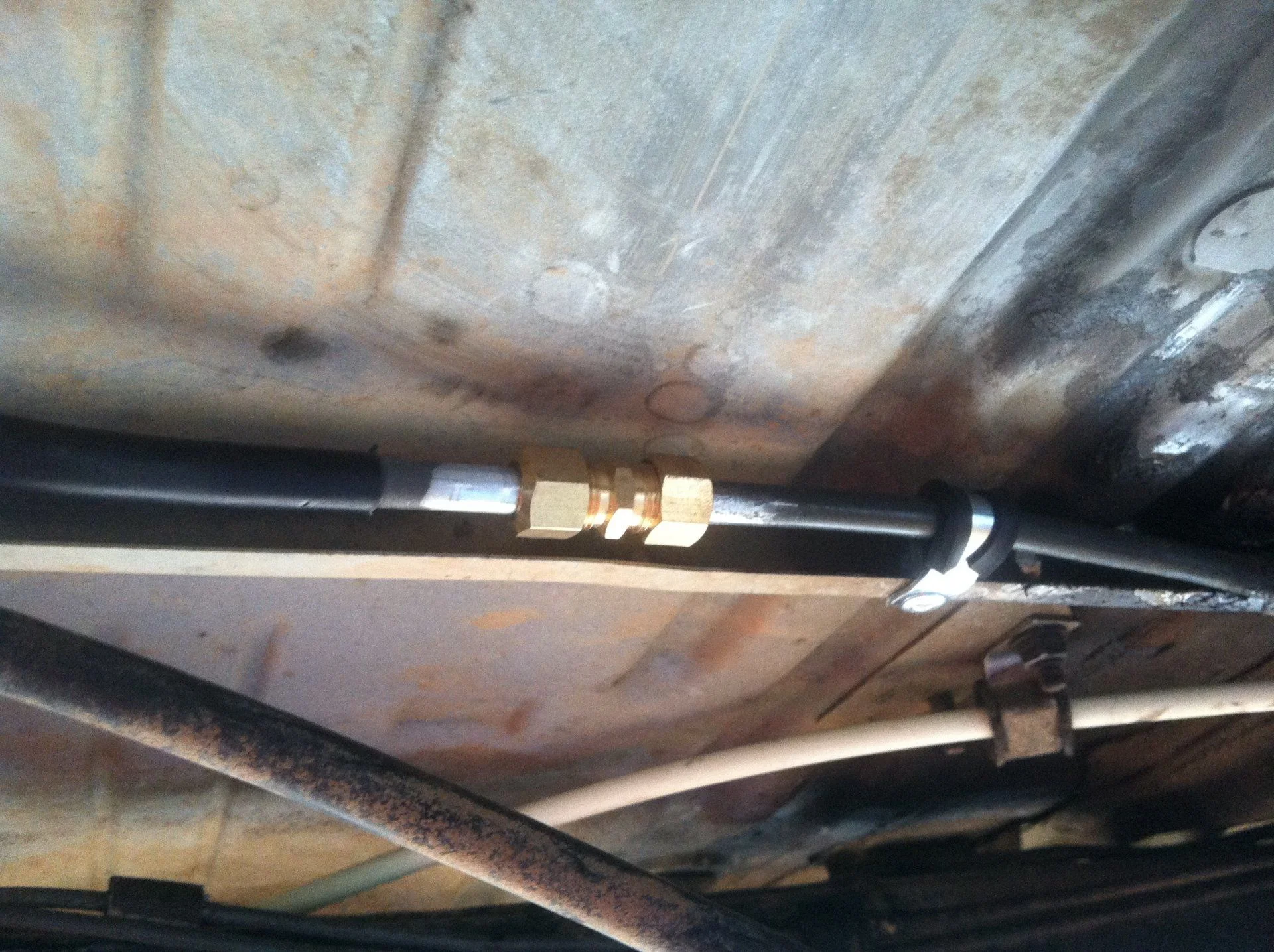

Fuel Lines
-I used the gas, vent, and return line from the Tacoma however you can buy a 5/16 line and a 5/16 fuel line compression fitting just remember to remove the coating on the Toyota line down to bare metal before installing the fitting(high pressure line)

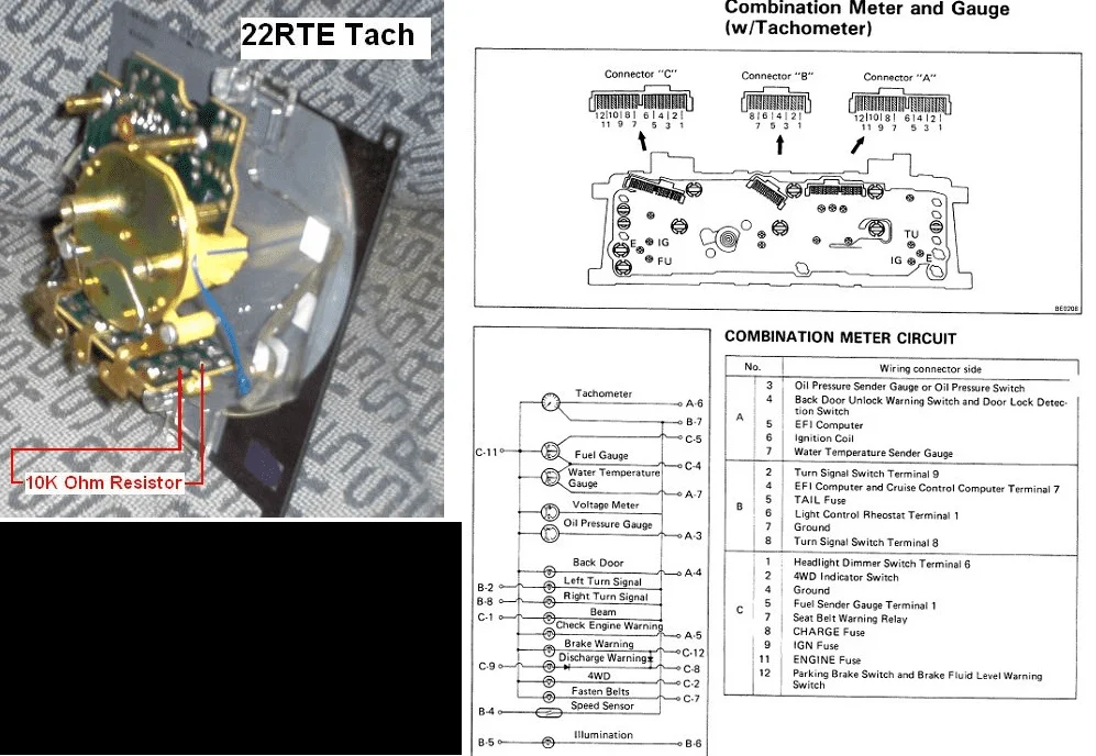

Tach gauge and Vehicle speed sensor
I used the 10k ohm resistor mod to get the original tach to read correctly.
The speed sensor wire (VSS or SP1) should be connected to the 3rz ECU. It is easy to find on a 22RE as it originally went to the 22RE ECU and cruise control computer. I have heard that a lot of toyota gauges have the VSS built into them whether it's used or not. On my truck it was a green wire/blue stripe connector B pin 4 on the gauge diagram below. My VSS signal is created in the cluster from my speedo cable, many other trucks have an electronic sensor
at the transmission which is wired into the cluster which then creates the VSS signal. It may take additional work to get a VSS signal if you are swapping clusters and/or transmissions. You're not going to be able to wire an electronic VSS sensor into a cluster that has a speedo cable input but you may be able
to add an electronic VSS to a trans that had a speedo cable originally.

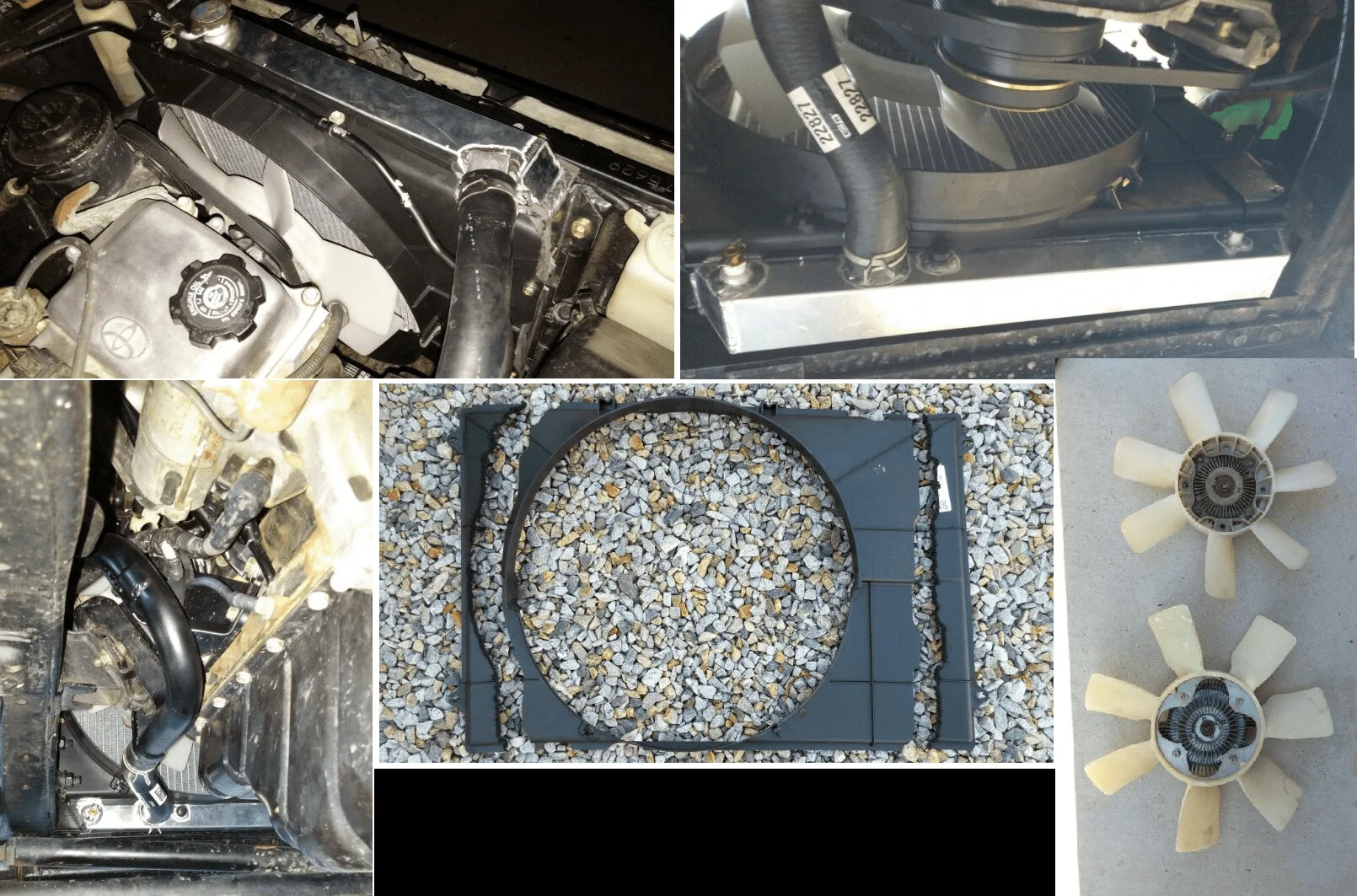

Radiator & Fan
I used a three row aluminum radiator for a 2wd 3.0 pickup (dpi-1190), a 2wd 2RZ fan shroud modified to fit, and kept the 3RZ fan. I originally used the 22RE fan, clutch, and shroud on the 3RZ but it got hot a couple of times, the larger 3RZ fan/clutch/2rz shroud fixed the issue. I made use of the 22RE cooling pipe to get around the alternator and used custom hoses top-gates 22808, bottom-gates 22827, and I think gates 22361 for the pump to pipe elbow.

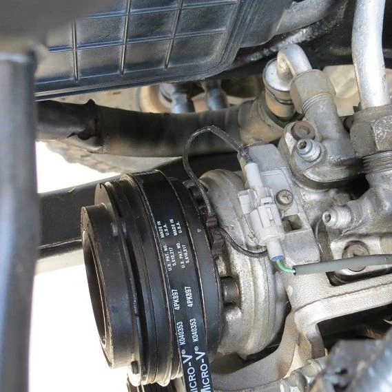

If I was to do the AC over again, I would go with R-134a and use the original 3rz compressor(already has correct clutch/pulley) and have custom hoses made(or swap the compressor head if possible) to connect it to the 85 evaporator and condenser.
Here is my original version:
I knew I wanted to retain the R12 A/C and discovered that Toyota used many different sized compressors on 22RE motors some will only line up with 3 of the holes on the 3rz bracket but mine(85 runner nippondenso 10p15c) lined up with all four holes however it did not clear the TOS motor mount. Luckily I was able to shave the mount and part of the motor mount cap with no structural degradation in order for it to fit. I never had to break atmosphere on my A/C as I kept it all original. If I was planning a 134A conversion I would use the Tacoma compressor (oil is different(PAG vs mineral), flush the system, replace the rec/dryer, expansion valve, and all O-rings, add PAG or Ester)
There are ester oils and universal oils that could be used and can mix with mineral oil, unlike PAG. Do a search on PAG vs Ester so you can decide the best option for you.
For the pulley I was able to get a compressor from a 1986 MR2(10p13c) and use the pulley from it because it uses the same style belt as the 3rz. It was a direct bolt on but it is a larger circumference than the 3rz pulley so a different size belt is needed. I used belt size K040353-4PK897(later spaced compressor out for hose clearance and used belt K040365-4PK927).
This is the part needed (MR2 pulley-four seasons 48828) if you can't find an old MR2 compressor (may no longer be available)
1985 TOYOTA MR2 1.6L L4 A/C Compressor Clutch | RockAuto - http://www.rockauto.com/catalog/x,carcode,1276769,parttype,6572

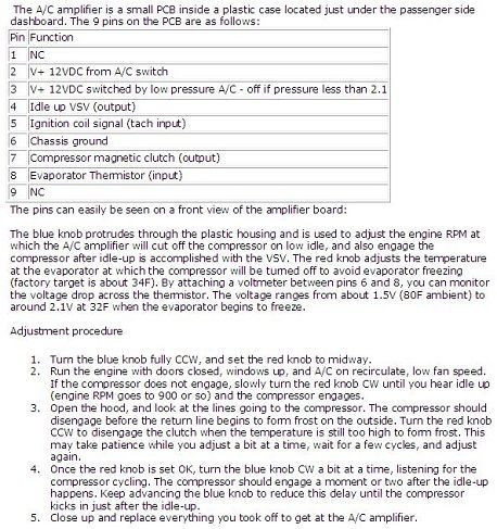

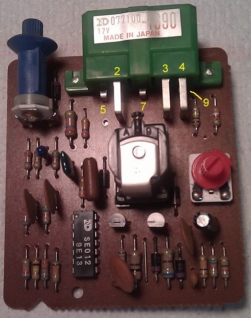

The AC amp on older Toyotas is controlled by a button on the dash and will work if it gets a tach signal from the ignitor. The idle up is achieved through a vsv valve and intake manifold vacuum switch with an up/down adjustment dial. There is also an idle up signal sent to the 22RE ECU which I think simply tells it to ignore the high idle condition.
ACT and AC1
The AC amp on newer Toyotas is controlled by a button on the dash and the ECU. The idle up is electronically controlled by the ECU most likely with the IAC valve.
The Tacoma ECU connects to the Tacoma AC amplifier using the AC1 and ACT wires. AC1 and ACT connections were not found on the older (22RE)ECUs. From what I have read, ACT is controlling whether the amp should be on or off based on the ECU knowing if the engine is running ect. The AC1 signal comes from the AC amplifier and lets the ECU know the AC clutch is engaged which prompts it to increase rpm's.
The challenge was to use the old style amplifier with the new ECU. I did not connect the ACT wire (cap it off or remove) as the old amp uses the tach signal to operate.
The next problem was the idle up, if I connected the old vsv output (blue)wire to the AC1 (blue/yellow) wire, the engine would idle up when the AC was on, but not idle down when the compressor shut off. After some troubleshooting, I found that adding a 3k ohm resistor inline was enough to trick the ECU into idling up and down correctly.
The benefit to using the old style amp is that it is temp or freeze/thaw adjustable vs the new style amp(factory setting only). You could swap out the amplifier if you choose but you'll need to know the pin locations of both to wire correctly. For example, you won't need to connect the tach but will need to connect AC1 and ACT.
I had to adjust the AC amplifier a bit as sometimes frost would build up and the ac would shut off. I was able to re-adjust the ac amp using the instructions in the pictures below.

Now may be a good time to replace an old ac compressor anyway, you could just buy an MR2 denso 10p13c (471-0136)with the pulley/clutch included and it will bolt right up. It uses R12
1985 TOYOTA MR2 1.6L L4 A/C Compressor | RockAuto - http://www.rockauto.com/catalog/x,carcode,1276769,parttype,6628
the denso 10p15c (471-0133)compressor was used on 4runners and some celicas and has bigger pistons but the same outer dimensions. the denso 10p13c is what you'll normally find on (older) pickups. they are interchangeable however the 4runners came with a 2 piece condenser(denso477-0133) the 15c will cool faster/better.
if your 10p series compressor leaks from the body or shaft but is otherwise good you can buy seal kits for it. aftermarket replacement compressors or even newer densos don't come close to the quality of the older units, if you have a good one keep it and reseal it. here is a good write up for that procedure

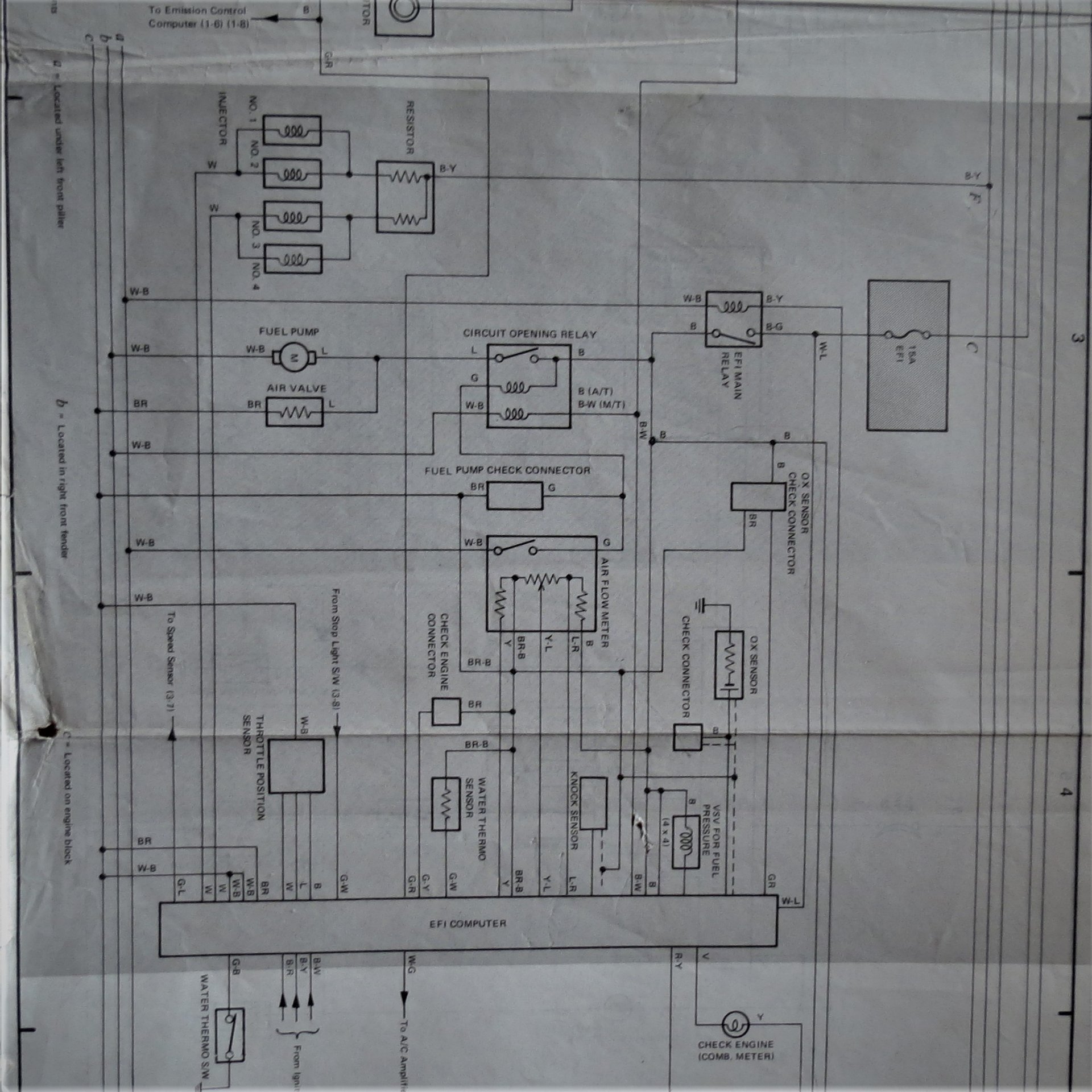

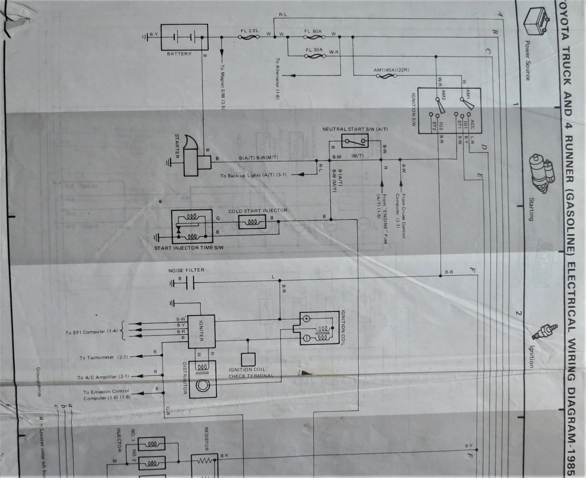

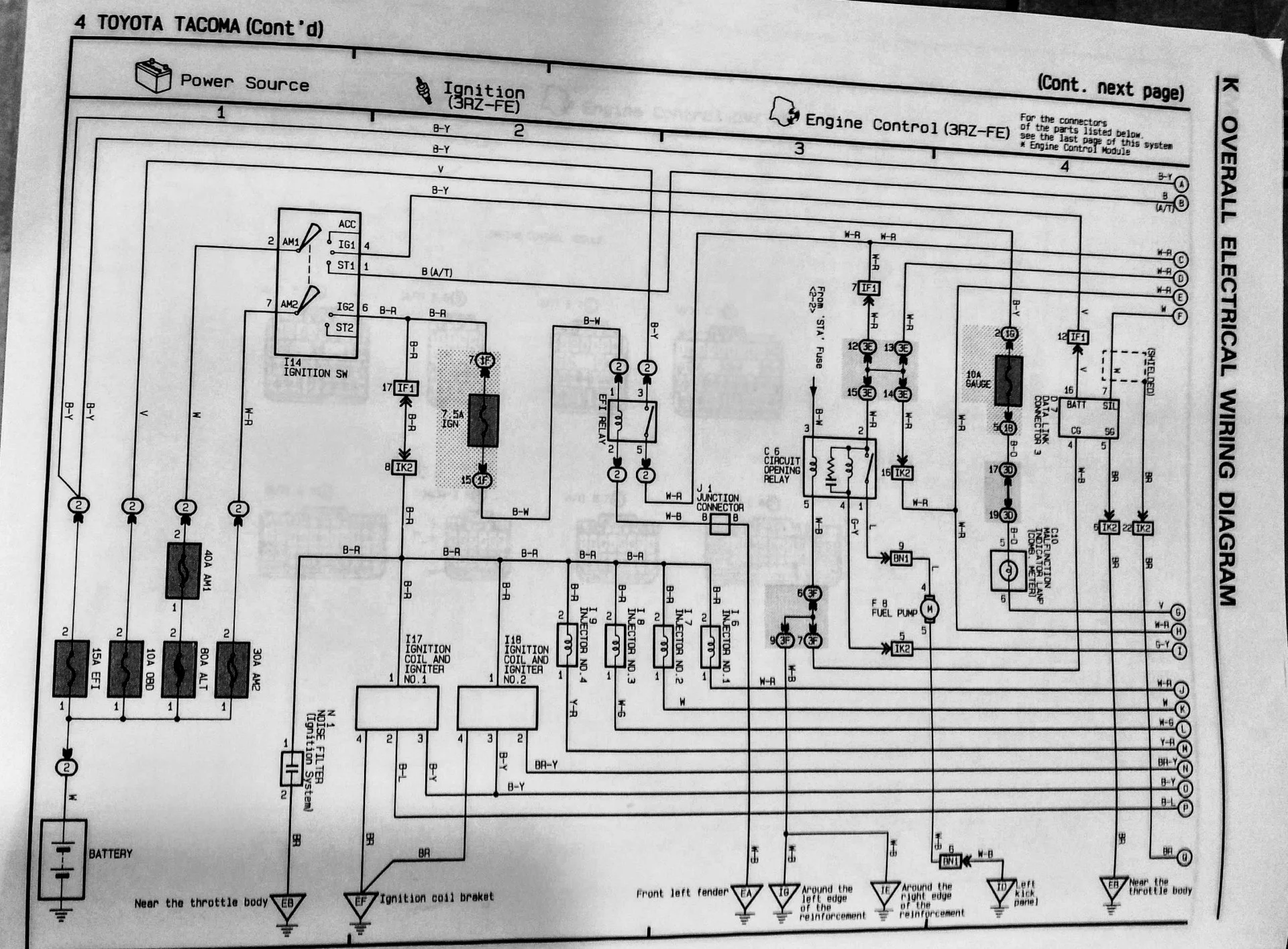

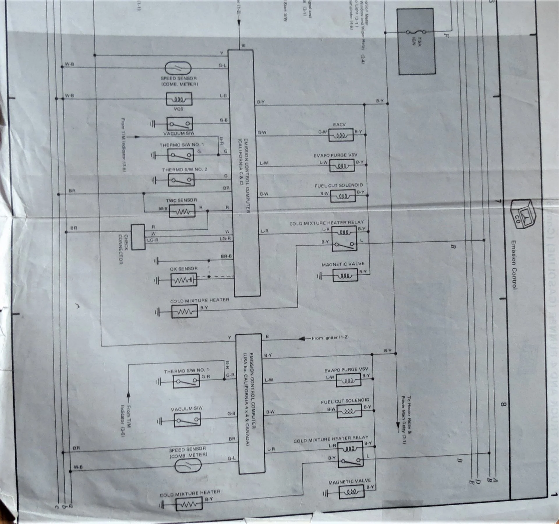

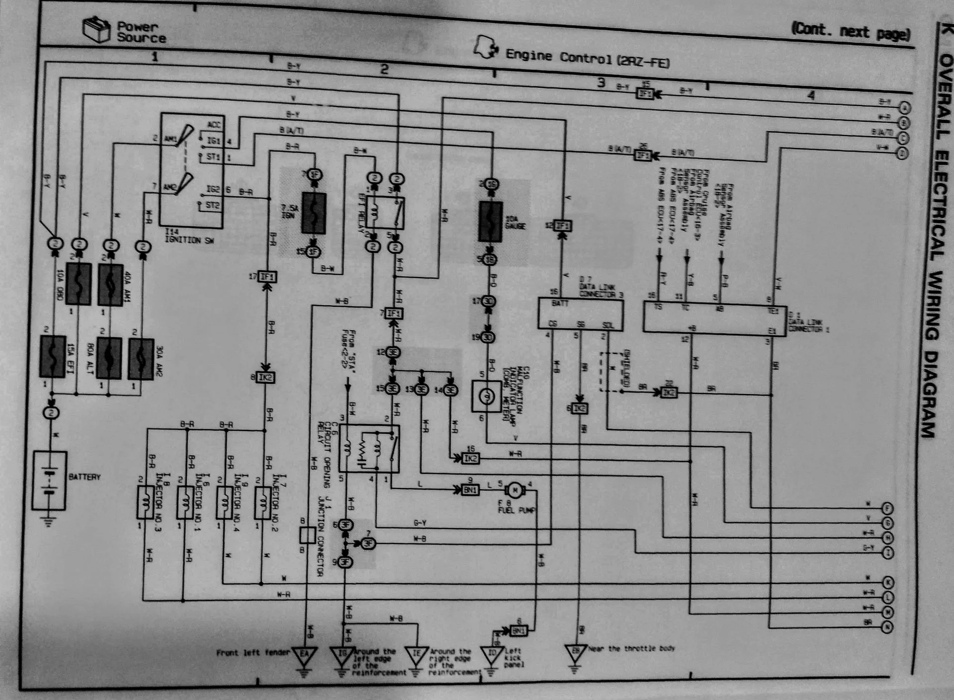

WIRING 22RE to 3RZ

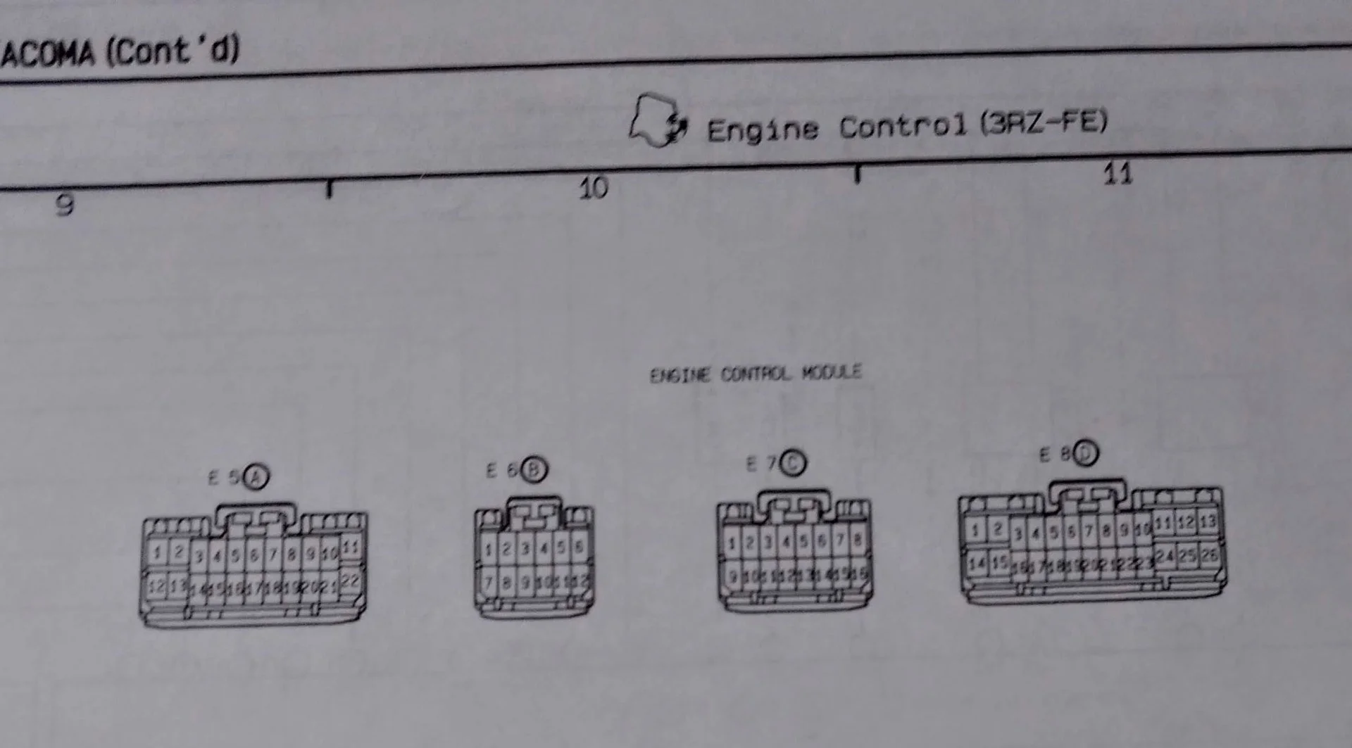

The wiring diagram I created should work for 2001-2004 3RZ Tacoma(possible 2000 California ECU) to a 1985 22RE.It may be helpful for other years as well. This diagram is intended for a swap that retains the 22RE under hood and inside fuse boxes and adds the Tacoma under hood fuse box. Because I retained the 22RE fuse boxes, I did not have to use the wiring loom from the taco fuse box that goes into the drivers side firewall (except for the thin green starter wire that goes to the starter relay.) This wiring diagram retains the 22RE EFI relay and the circuit opening(fuel pump) relay. don't forget 4runner ricks 10kohm resistor mod(see pic) to make the tach read correctly.
I found out recently the starter relay signal wire in the Taco fuse box may be black/white instead of green on some models. Truck plug 1 may contain 2 small black wires, use black with red dots for EFI power to pin 16 of E5 plug
To try and state the wiring simply, there are 2 main plugs where most of the conversion wiring will take place, the E5 plug and the IK2 plug(pics below). Most of the other plugs are contained within the engine harness and plug directly into the ECU. Pay close attention to what was connected(including fuses) to the battery on the 22RE and make sure you repower all of the feeds to the cab on both driver and passenger sides.
truck plug 1,truck plug 2, (called 4runner plug in plug pics) and the 22RE ECU plug can all be found in the passenger kick panel. They are what’s left after removing the 22RE engine harness. The IK7 plug is a companion to the IK2 plug and is part of the taco engine harness. Mine(Ik7) only had 2 wires in it that were for the rear o2. The 22RE harness included the reverse light and 4wd indicator wiring, the 3RZ harness does not, you will have to run those wires. The circled numbers on my diagram pertain to plug pin #s.

E5
The E5 plug comes off the 3RZ ECU and is used for things like powering the ECU, providing an output for the check engine light, AC amp, OBD plug and accepting an input for the stop signal(brake), starter signal and vehicle speed sensor.

2001 tacoma 4x4 manual to 1985 4runner 22re sr5 pinouts
Key = pin * color * description * destination
E5 ECU plug
1 * black/yellow * EFI power * EFI 20A fuse
2 * none 3 * none 4 * none 5 * none
6 * violet/red * check engine * purple wire 4runner plug 1
7 * black/white * starter signal * thick black wire 4runner plug 1+hook to taco starter relay green wire(or black/white auto vs manual) in Tacoma under hood fuse box
8 * none 9 * none 10 * none 11 * none
12 * white * OBD signal * D7 plug pin 7
13 * blue/yellow * AC idle up * blue wire 4runner plug 2 use 3k ohm resistor inline
14 * none
15 * green/white * stop light * green/white wire 22re ECU plug
16 * white/red * EFI power * white/red IK2 plug pin 13+black(red dots) 4rnr plug 1+rear o2 white/red
17 * none 18 * none 19 * none 20 * none
21 * green/orange * speed sensor * green/blue wire 22re ECU plug pin 10
22 * none
IK2 plug
1 * black/red * ignition2 * connect to black/yellow pass fender used to go to underhood resistor
2 * none 3 * none
4 * white/black * ground * ground
5 * red * obdTC * red D7 obd plug pin 13
6 * none 7 * none
8 * green/yellow * oil pressure gauge(use 22re sender) * yellow/black 4runner plug 2
9 * brown * ground * ground
10 * yellow/red * water temp gauge * yellow/green 4runner plug 2
11 * light green/black * tach * light green/black D7 obd plug pin 9+4runner tach solid black wire can be found at A/C amp(if your truck has no A/C the plug for A/C amp is still there behind & above glove box) or you can find it in driver fender also solid black
12 * black * rear o2 * rear o2 ground
13 * white/red * EFI power * white/red E5 plug pin 16+black 4runner plug 2 this is going to original EFI fuse driver kick+rear o2 wht/red
14 * brown * rear o2 * rear o2
15 * none 16 * none 17 * none 18 * none 19 * none 20 * none 21 * none 22 * none
23 * brown * ground * ground
24 * light green * A/C clutch * black/white 4runner plug 2
25 * white/blue * fuel pump * splice into green wire at circuit open relay behind pass dash speaker
26 * none
D7 OBD II plug
1 * none 2 * none 3 * none
5 * brown * ground * ground
6 * violet * OBD power * 7.5A fuse
7 * white * OBD signal * E5 plug pin 12
8 * none
9 * light green/black * tach * IK2 pin 11
10 * none 11 * none 12 * none
13 * red * obdTC * red IK2 plug pin 5
14 8 none 15 * none 16 * none

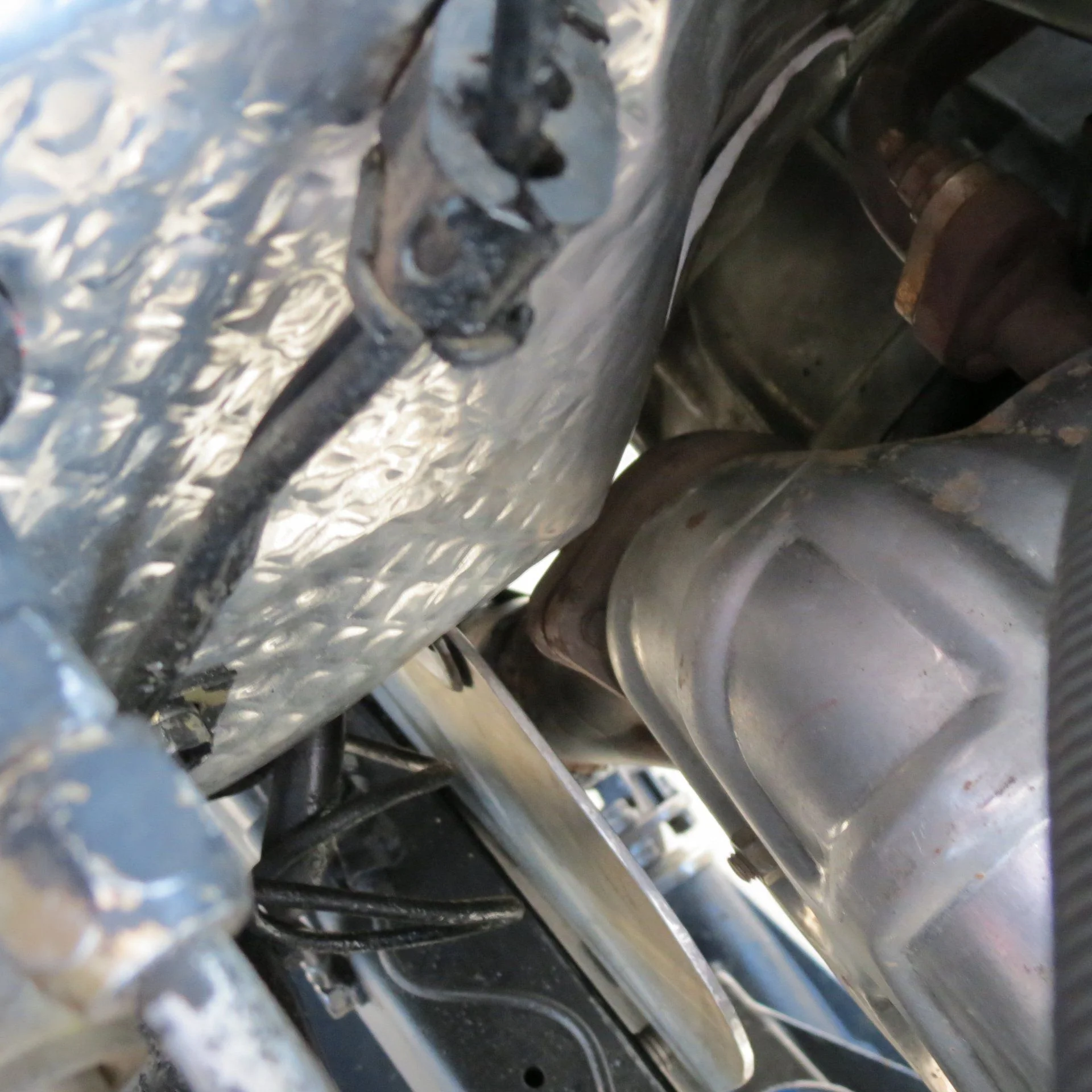

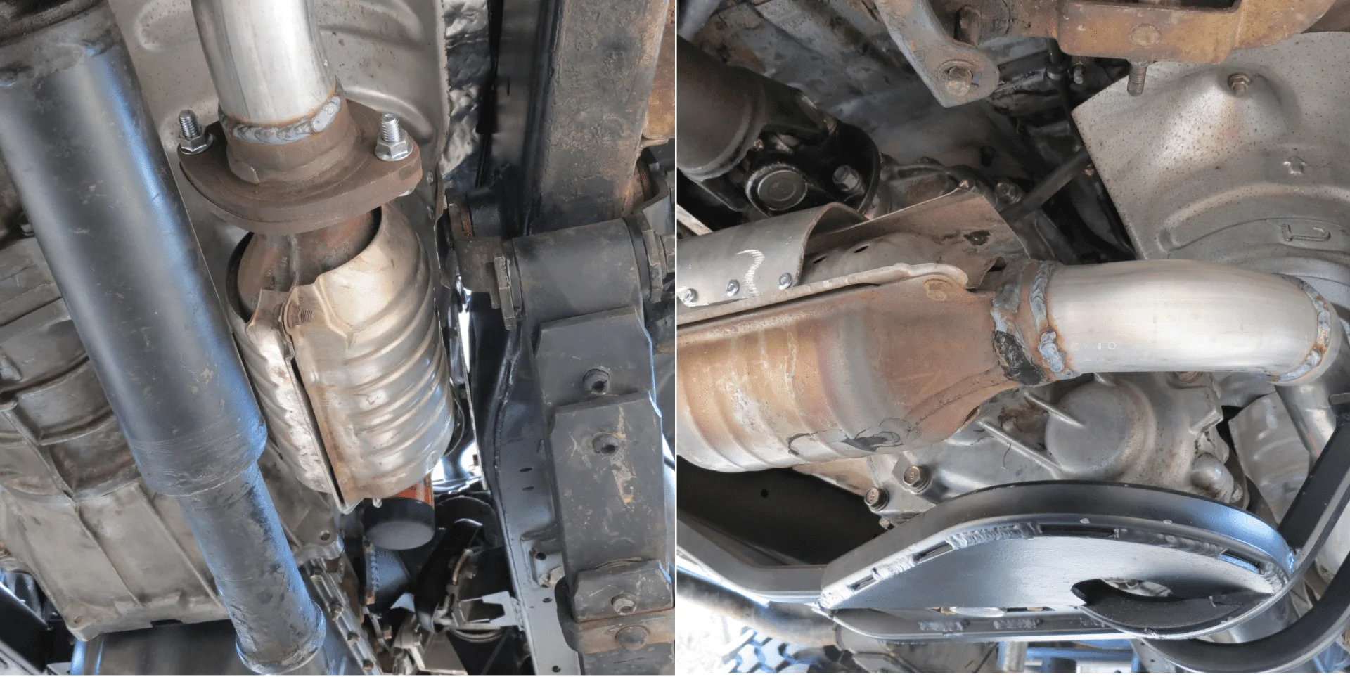

I'm curious how you did the down pipe off the exhaust manifold. I have the original down pipe from the donor that runs to the cat. I also have just the Y piece and I'm trying to decide which would be best to clear the firewall.
How did you route the exhaust? Did you cross over to the driver's side? If so, how?

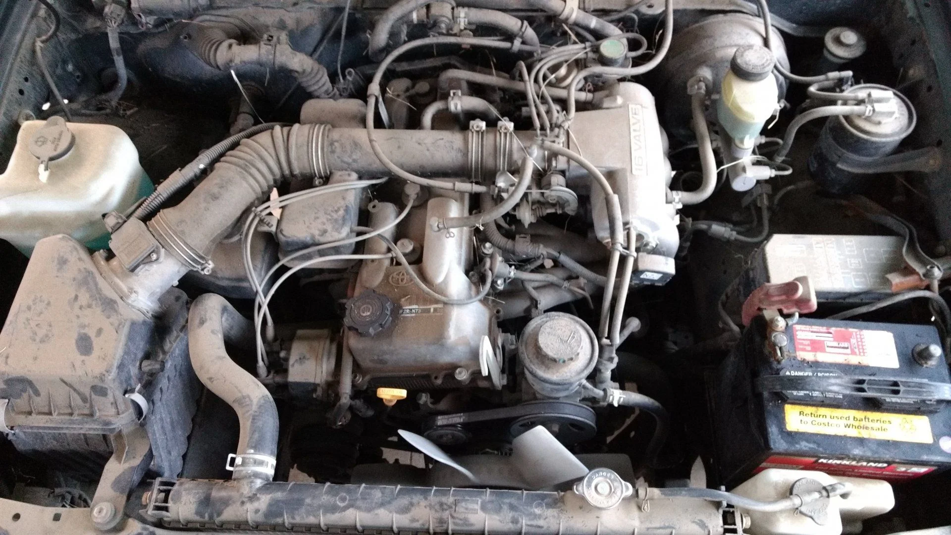

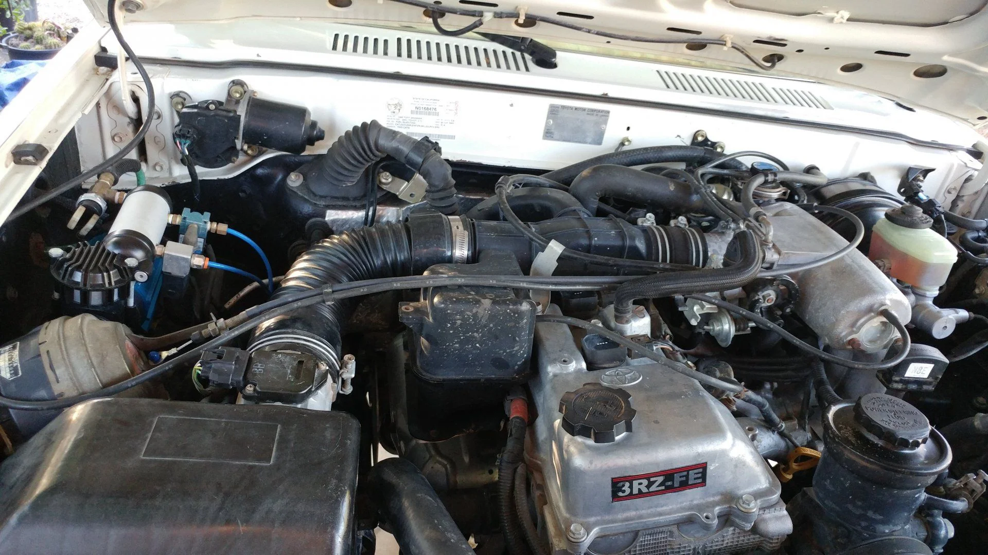

Another question. The hose off the resinator to the air box. Was that also off the 3.4L? I remember you suggesting the 3.4 airbox, but when looking at the boneyard trucks there was something about the MAF on the 3.4 that didn't look right.
This is the best pic I have at the moment of the air box connection. I am using a modified T-100 air box with an aftermarket flex hose. I removed the resonator that used to be close to the MAF. Thanks for the 3RZ-FE sticker. I was told the 3.4 airbox was ideal but I don't know how the MAF ties into it.

Exhaust Manifold, 17141-75080
Exhaust Heat Shield, 17167-75100
Since you brought up the header type manifold on the late 3RZ. The cast manifold used in the pre-2000 trucks was prone to cracking. In 2000 Toyota went to a header style that looks just like the Doug Thorley, but is significantly less money. Mine have been ceramic coated.
WOW! that sure is purty. Might as well start a list of part numbers here.

A/C parts
compressor-------denso 471-0133(reman 10p15c)
condenser--------denso 477-0133
rec/drier----------denso 478-0101
expansion valve--denso 475-0101
O-ring kit---------four seasons 26751
MR2 compressor pulley--------four seasons 48828(no longer avail)

just bought another "rolled taco" (wife is not happy). This time it is a 1997 2wd 2rz manual with AC and power steering. I'm going to put it in my 1990 pickup or 1987 4runner and will use this thread to document progress. If anyone has the ECU FSM wiring diagram page for a 1997 2rz let me know.
never mind, got the diagram
1997 2RZ ECM diagrams
