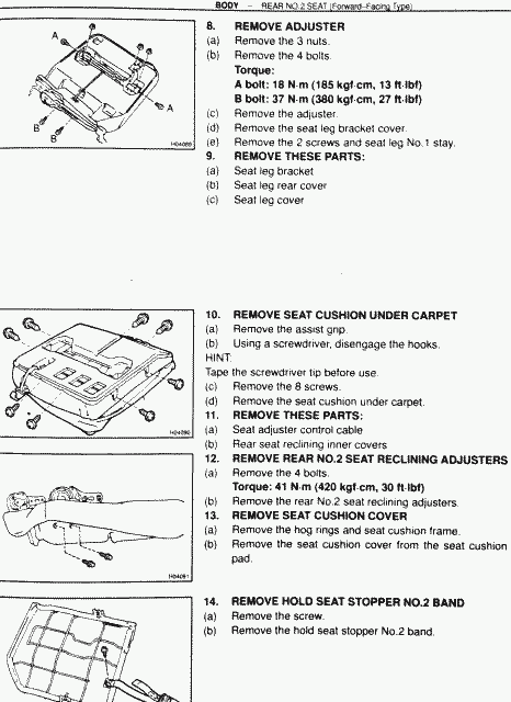

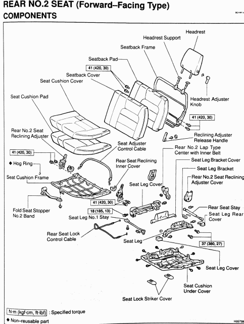

Anyone out there know how to take off the "bottom" cover of the passengers-side third row seat? My release latch has broken and I need to get in there and do some surgery. this would be the underside of the lower seat cushion, where the floor latches are. Thanks in advance...DarkStar
Your release latch has broken? I know i had a problem with the lever at one point. Check on the side of the seat that is closer to the outside of the vehicle. Check to make sure all the little pins and such are working properly. I had to pop a little pin back in place for my lever to start working again.
Thanks I will check it out. My thinking is that the cable that the lever uses to control the latch has stretched, because everything else looks in place.
See 3 pix. - Looks like a bit of wrenching...
uHu....THANK YOU SOO MUCH!!!!!!! That really helps!!
