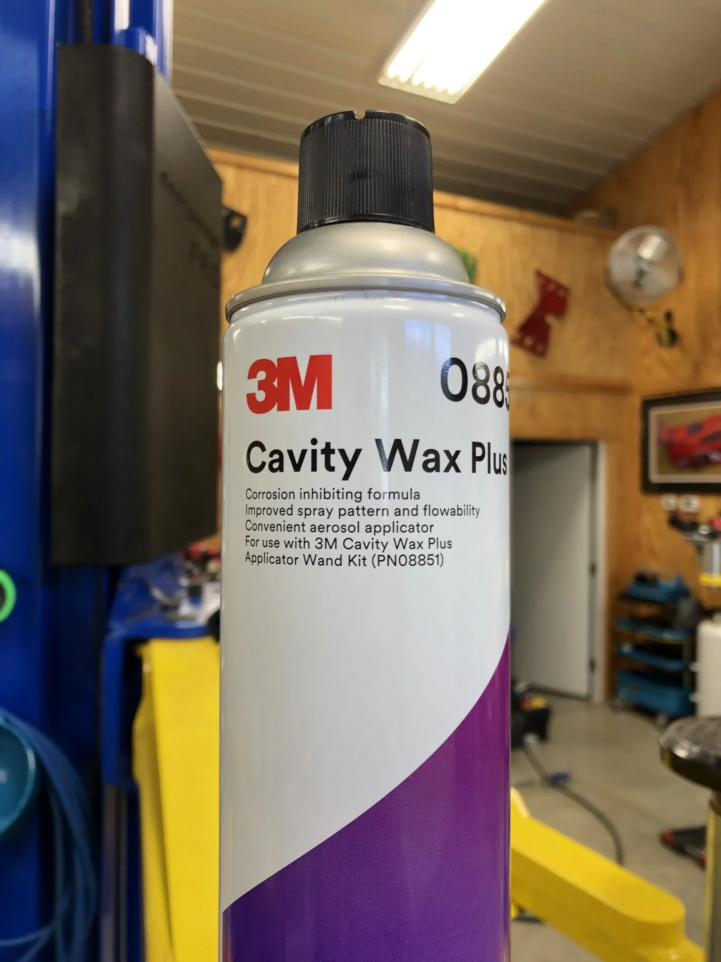

On the shelf was a display of 3M Cavity Wax as seen in the photo. I've got a 1974 911 that was treated to TUF KOTE DINOL (dinotrol) back when it was new and it's never ever rusted anywhere. The white plugs that were inserted where invasive injections were performed are still there.
So I'm a believer in anything that can inhibit or stop rust from occurring. I've done my fair share of penance over the years with rustoration work. For me the worst offenders have been Z Cars and Porsches. If you've tackled a rotted 356 o Z Car you know where I'm coming from.

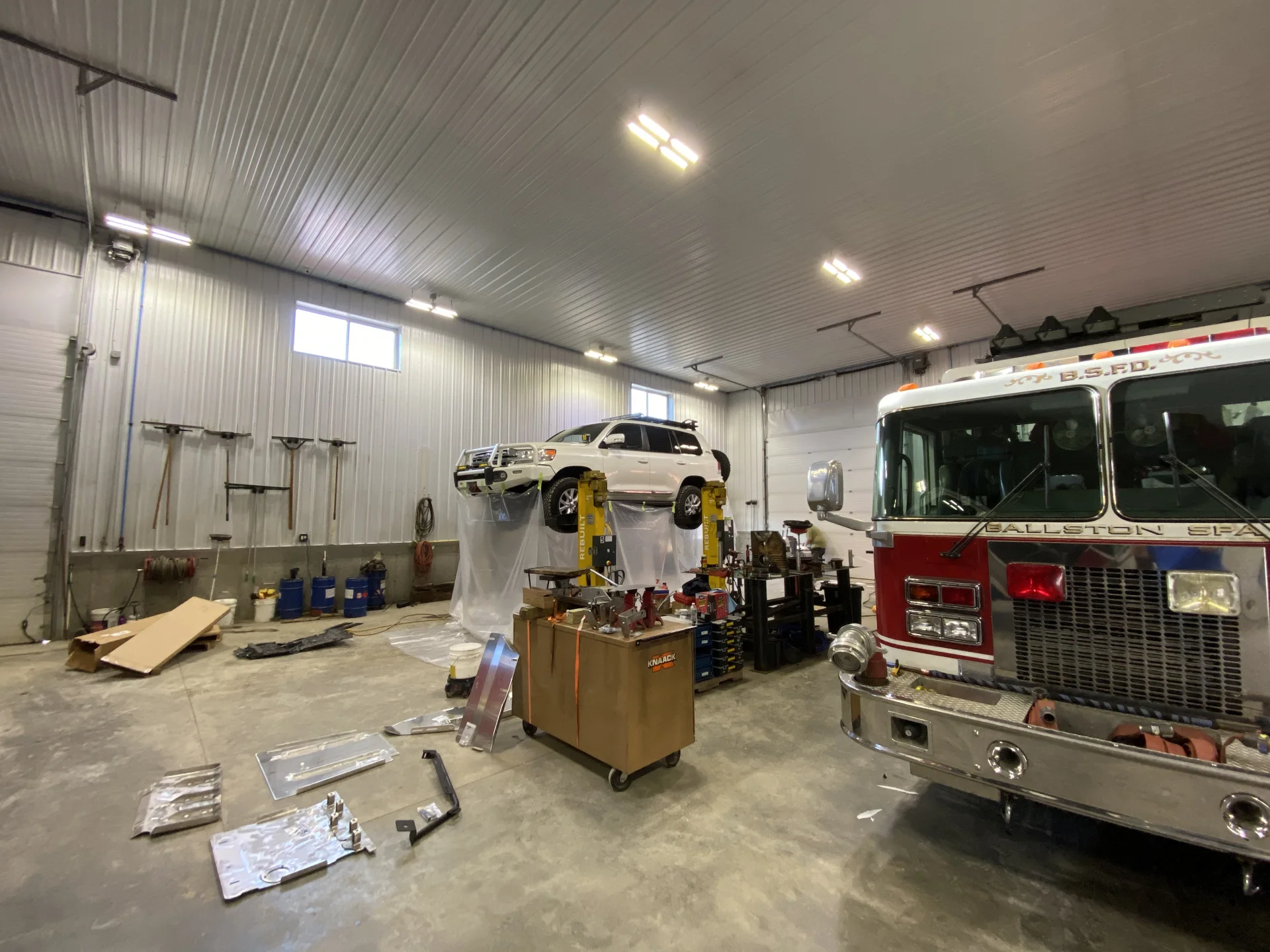

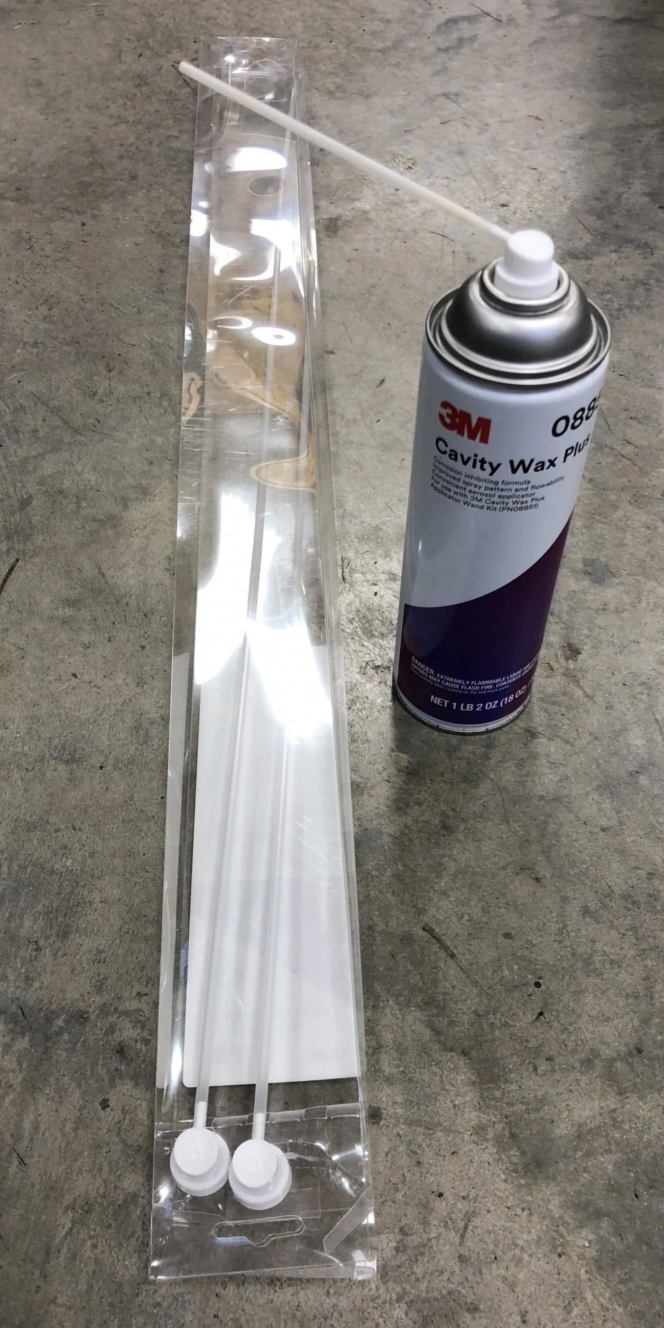

I ended up buying the 3M product and the wand kit that's part of the program. Two of the wand will do a 360º pattern. I did a little on the Land Cruiser while I was working on my tow hooks but
need to make better arrangements for seepage onto my floor. The car has no rust whatsoever other than small scaling seen on welds and it doesn't amount to a hill of beans. That doesn't
mean I won't go all-in for a inside the frame rail spray as well as door bottoms and inner body. When I get there I'll post photos.

I like the 360 degree spray pattern on the end of the 3M wand kit. That could make a difference in hidden areas. It does seem like it would limit distance, though.

You can get the same wand for fluid film rattle cans in different lengths. They also make a similar wand extention for the cup gun. Same goes with WoolWax. They have multiple kits for sale that include these. They also sell them separately.
