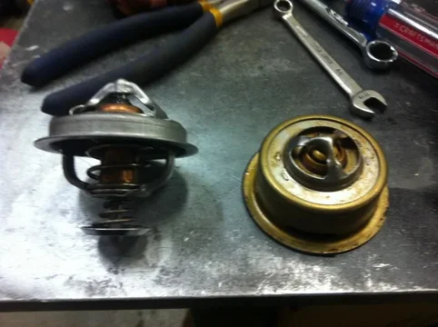

On the left is the 82C unit that was in my 42. Since I got her back on the road a month ago I have been suffering and complaining about the lack of heat. Local temps have been -10C to +15C and with the winter front down the engine would only pass the "cold" mark when at highway speeds. Very cold rush hour commutes where I could only hit 70Km/h. I know the 3B runs "cooler" than a 2F but there had to be something wrong.
On the right is the unit I bought for the engine rebuild on my BJ45 conversion. Got it at 4Wheel Auto.
My fellow RMCLA members said right off the mark,"check the thermostat". Procrastination is a bitch.
