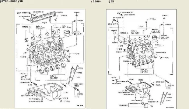

Just checked the EPC and it appears August 1988 was the changeover time when the 3B went sleeveless:

PS. This comes from BJ60 information but I suspect other models followed suite.
thanks a lot guys! Those are great pictures lostmarbles. Is the rotary pump also lubed by engine oil like the inline pump is?

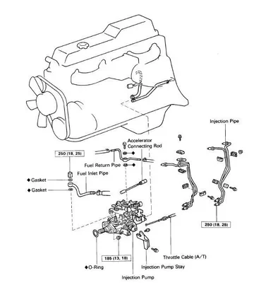

No. It relies on the lubricity of the diesel fuel.
This is the image used in the Aug 88 FSM for describing the removal of the injection pump. As you can see, there are no oil lines:

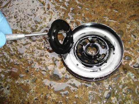

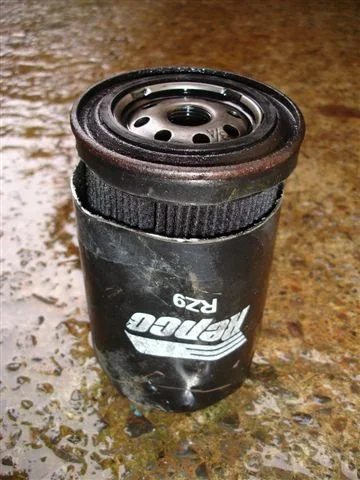

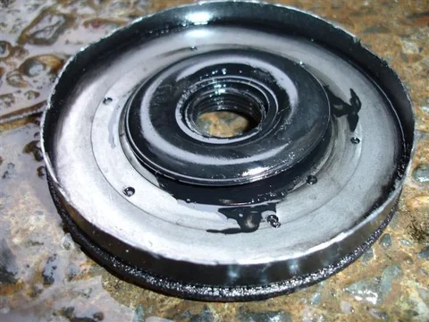

Every filter should have it's own inbuilt anti-drain/anti-syphon valve:

I'm not even certain that the valve I pointed out on the filter itself would prevent draining to tell you the truth ... especially when a filter is upside-down.
