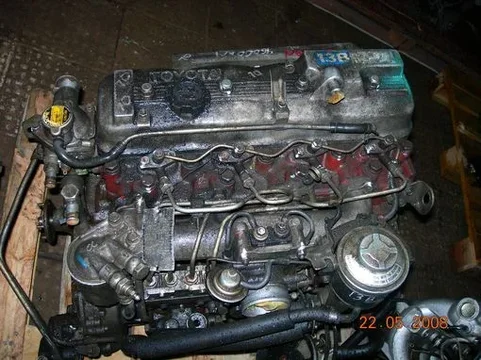

We all tend to make statements based on what we're personally familiar with seeing.
But here's a 13B (without the T):
And I think 13B or 13BT can come with a rotary pump too (just as a 3B can)!
:cheers:
