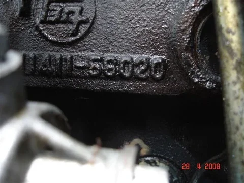

And you'd expect such a number to be useful when ordering parts for your engine (to determine the manufacturing period - for example). But NO!!!! Engine Australia asked me for this casting number instead (to source the correct parts for my engine):
