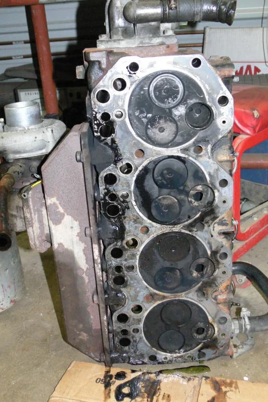

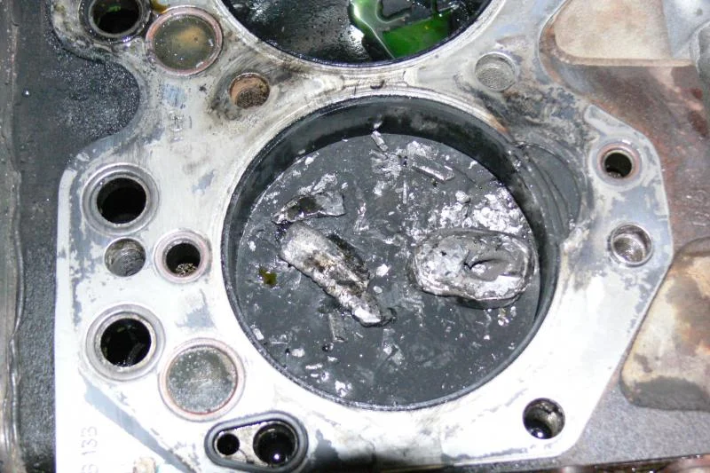

Final diagnosis
I spent the afternoon pulling the cylinder head as my last step in diagnosing my engine problem. I wanted to make sure I had covered all possibilities before taking that final step - basically cautious!
I guess I could have/should have taken the plunge right away! Catastrophic failure of the precup in cylinder #1. I was pretty sure that was where this was headed after I disabled the valves and the interference was still there.
Of course the piston is toasted along with the cylinder sleeve in that bore. First look seems to indicate that the block is OK where the sleeve is destroyed.
Time for an overhaul and with as many Kms as I have on this engine I am going to go for broke unless I can find a good used engine. Actually have thought about a 13 BT before transplanting this 3B into a very nice FJ out of Texas. I am so happy with the results of last winter's project that I want to be sure of my reliability factor!
One concern I have is in finding a machine shop to work on the block. Any thoughts from someone with experience with this? A good machine shop should be able to do the work regardless of the engine type or are there special considerations for the Toyota diesel?
Pictures follow for any that are into Cruiserporn. Thanks again for all of the suggestions.

Ooof, ugly. Bummer man.
A question - your pictures look like the precups are recessed into the head??? They should be flush, whats going on there?
