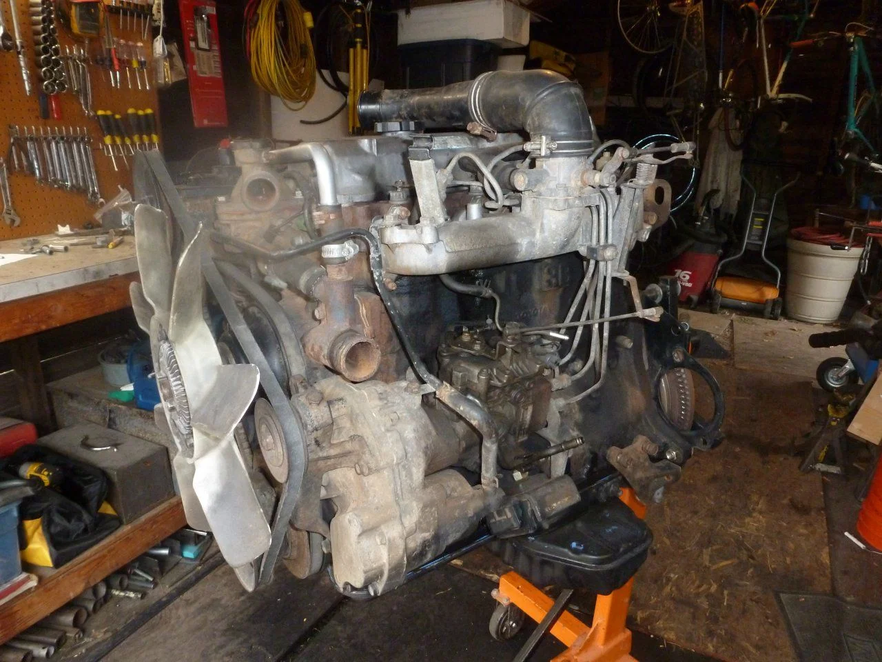

You can see the vac and ps pump on the lower RH side of this 3B II , which is a newer version of the 3B. I think it has a bigger crank and more cam bearings. It also has a rotary pump.
p1050063-jpg.1357246
Yeah ok that makes sense. Do the 3B II's all have the later valve cover ?
Any idea what year they were released ?
Lots of info about the entire range of toyota diesels on wiki
Yup, the mark II B's and 3B's have the finned alu tappit cover, But Thats Not All, folks, 5 bearing cam and the vacuum pump thingy, but also under piston oil squirters, and a 10 bolt exhaust outlet, which takes a 14B turbo manifold in case you ever want to turbo.
