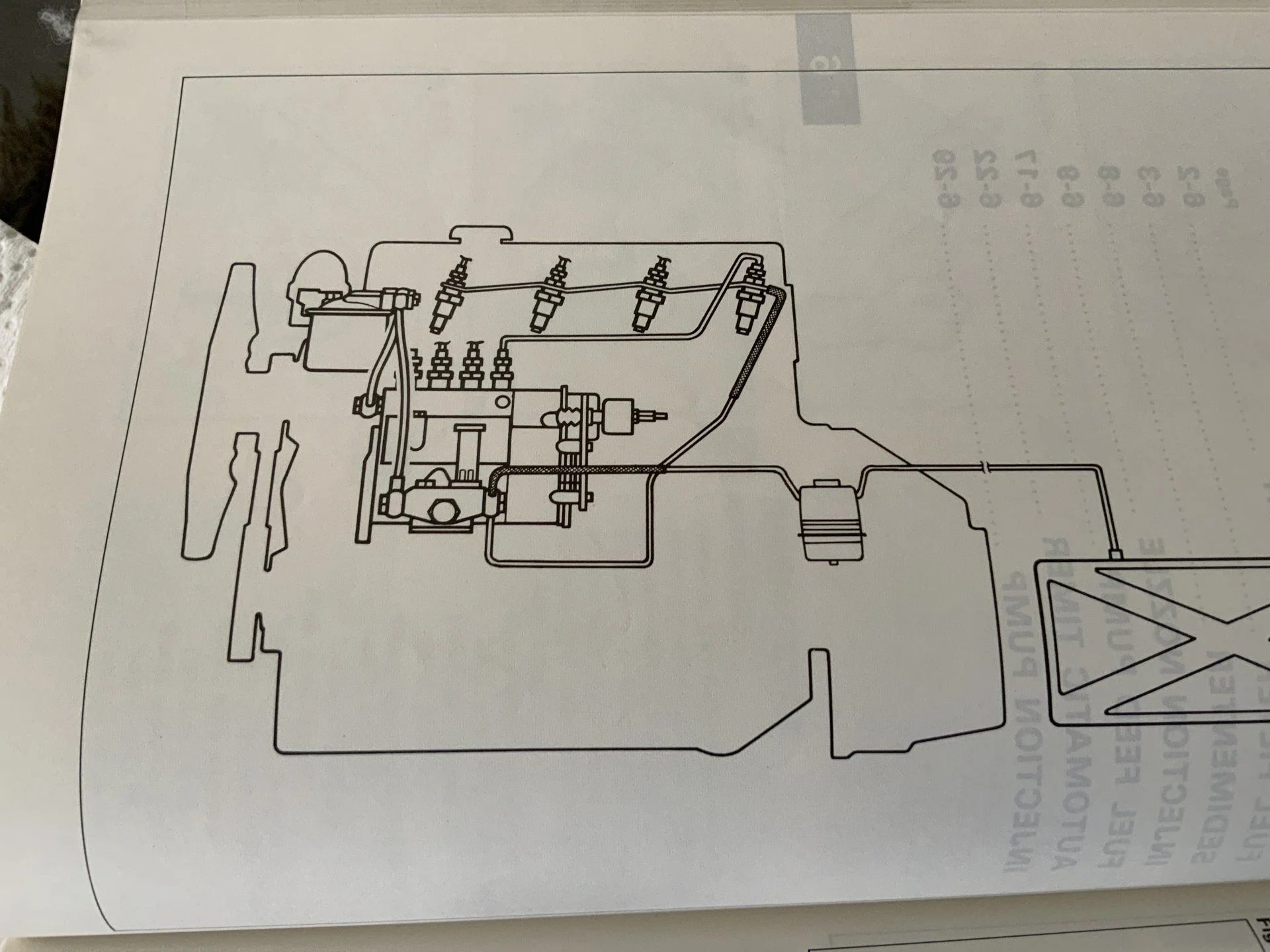

It sucks air , its not from mechanical failure. I have bled the system several times and have had air come out .The issue ,I have is that it's really hard to know where it's coming from, I'm going to buy some clear hose and connect between the tank and return lines to see if it's at the return or from the tank. One last question, is it posible for it to be the tank itself? I looked at the tank and there are two hoses near the fuel filler cap and a single hose which is the outlet that i have replaced ,what are the other two near the filler cap? This is a RHD bj42
Found the leak it's the return hard line.I can't see how it comes off ,any one know how to do it without removing the pump?

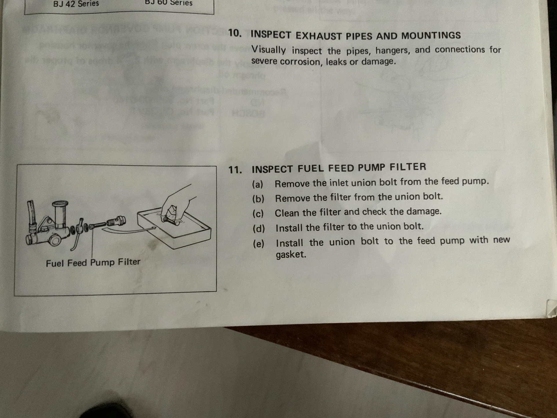

The only fuel return line on a 3B is the weep line which connects the injectors to the double nipple banjo fitting on the inlet to the fuel feed pump.
Remove the inlet banjo (hollow) bolt retaining the fitting and remove. Anneal and check both copper washers before reinstall, and check the filter element inside the bolt. It’s not a difficult job, checking the filter there is part of routine maintenance.

How are you trying to get the inlet banjo bolt out? What tools are you using? Get a box end or a socket and a flex bar, and sometimes a few taps on the free end will get it loose.
I see on your other thread you’ve got the bolt out. Check to see both line brackets are undone, it should come out.
