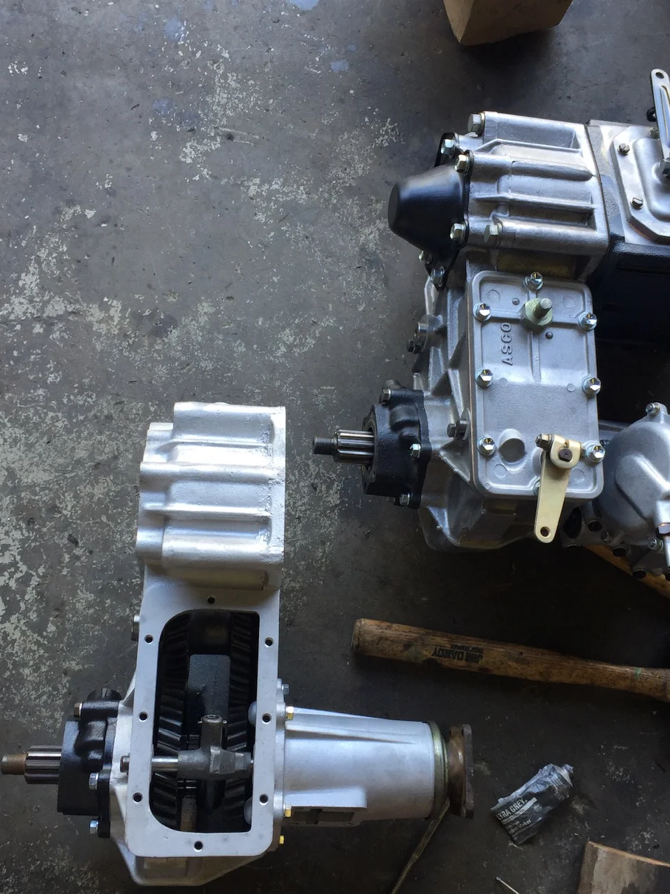

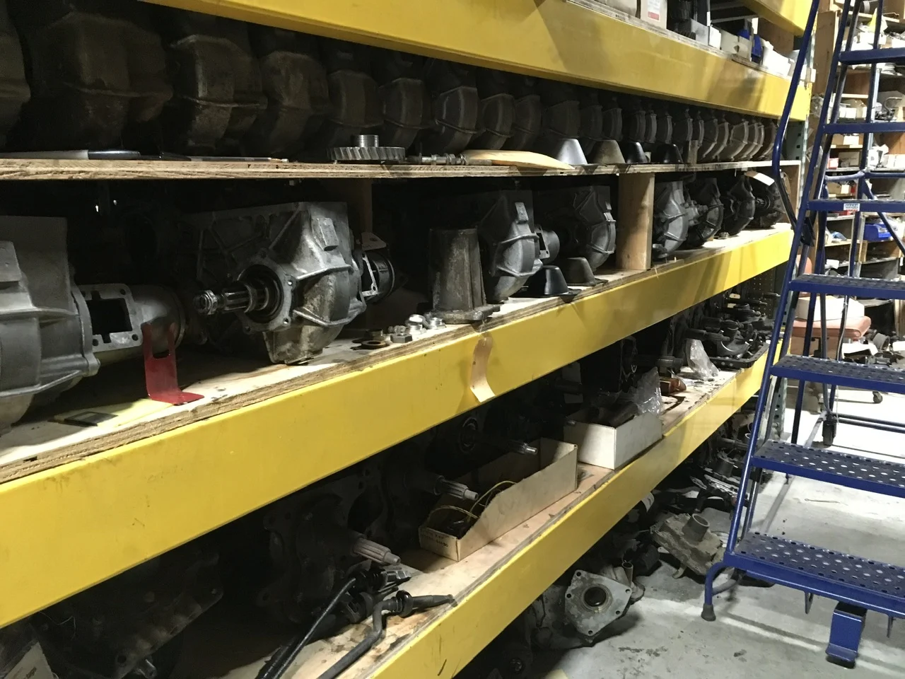

I have several of each in Burbank. I have been rebuilding transfer cases since 1987.
