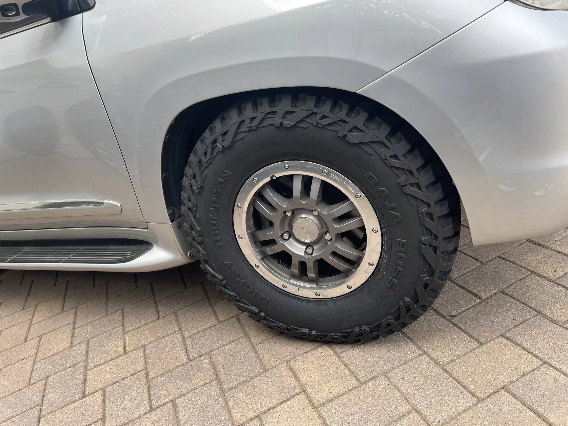

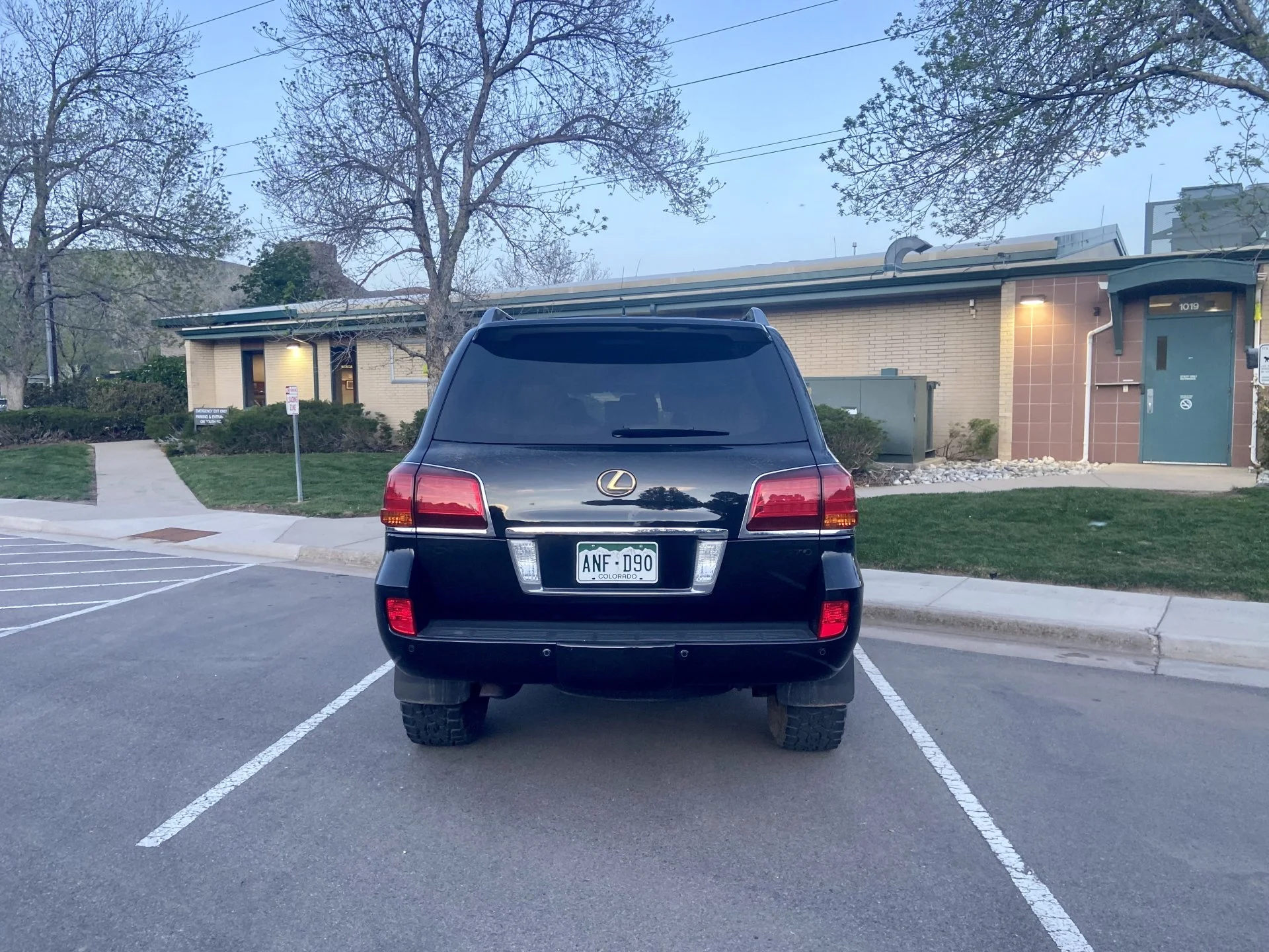

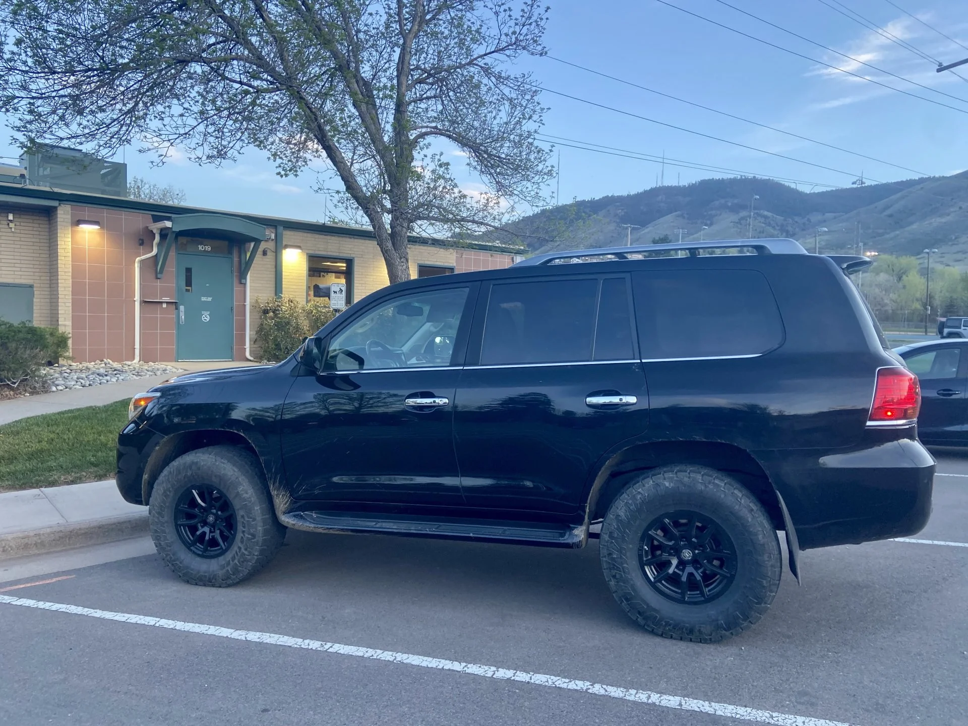

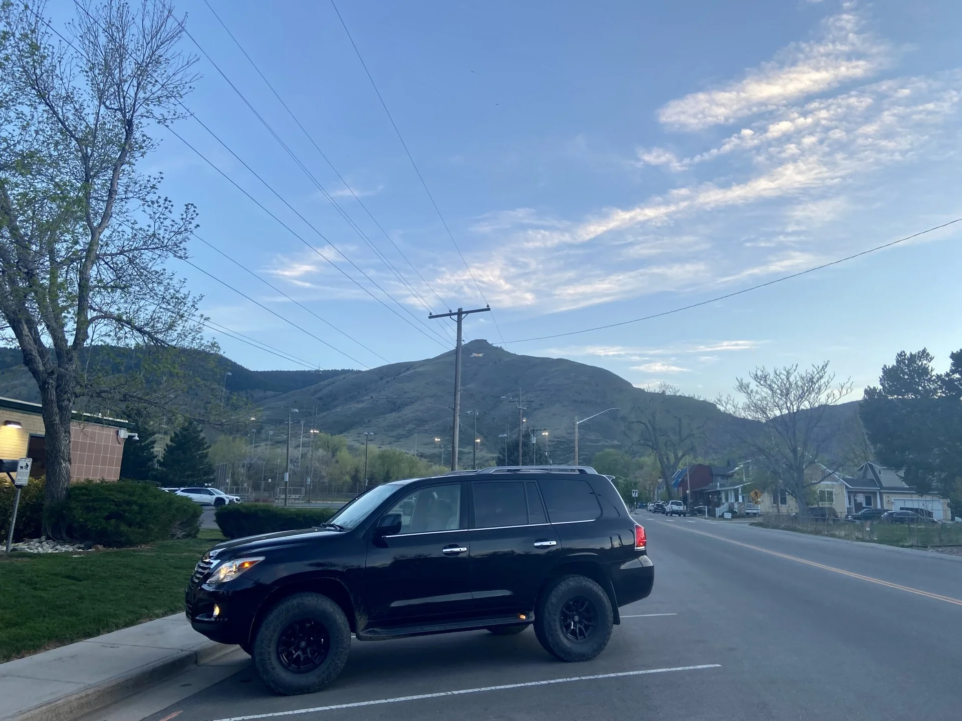

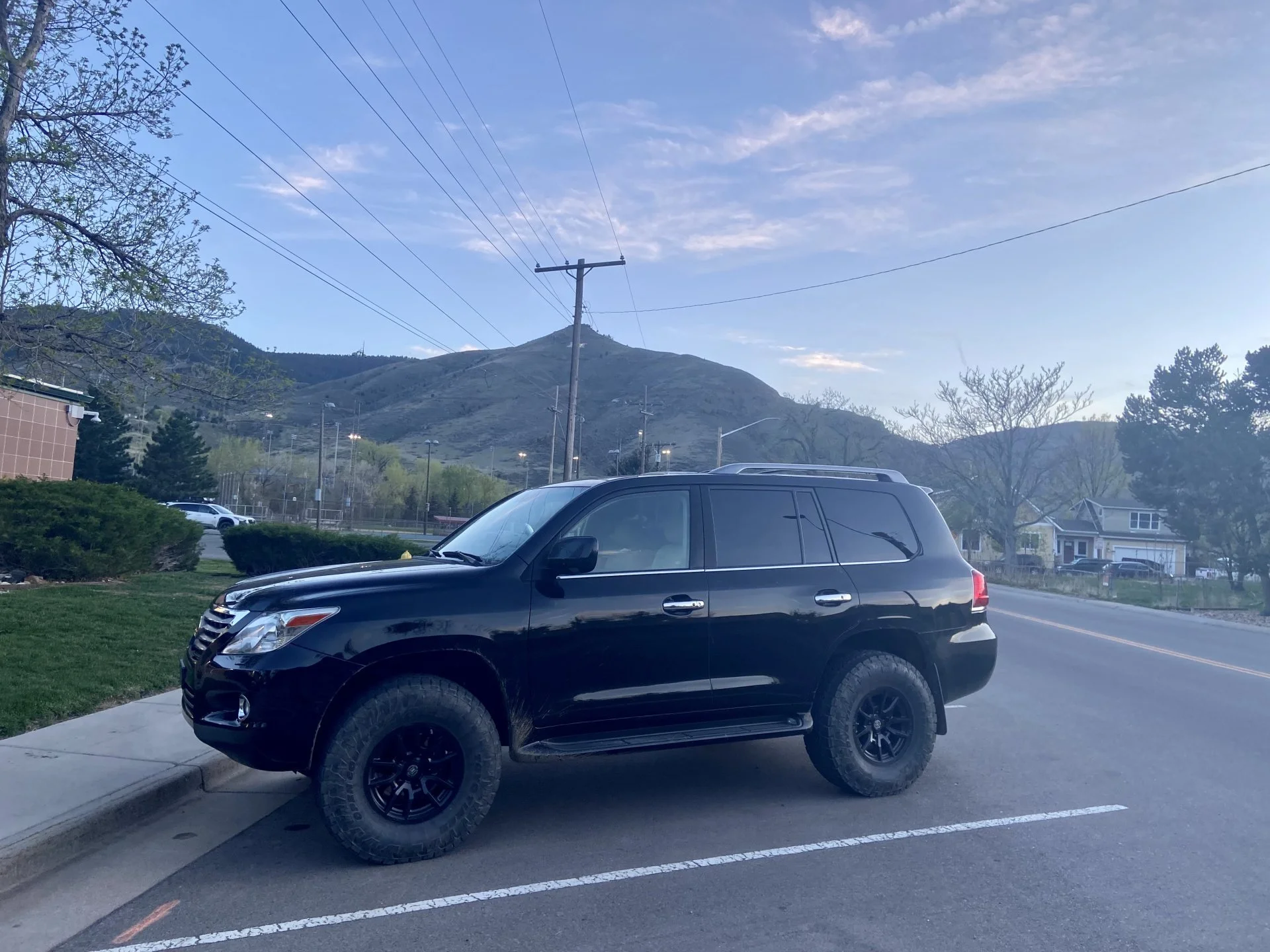

How it going ladies & gentlemen I took the plunge on the 35” Baja boss super happy a very light rub on the front splash guard. The lx570 doesn’t have the kss it uses the ahc so there’s no interference with the sway bar. 💪🏽😎 super happy with the purchase and stance of the truck. No wheel spacer either.

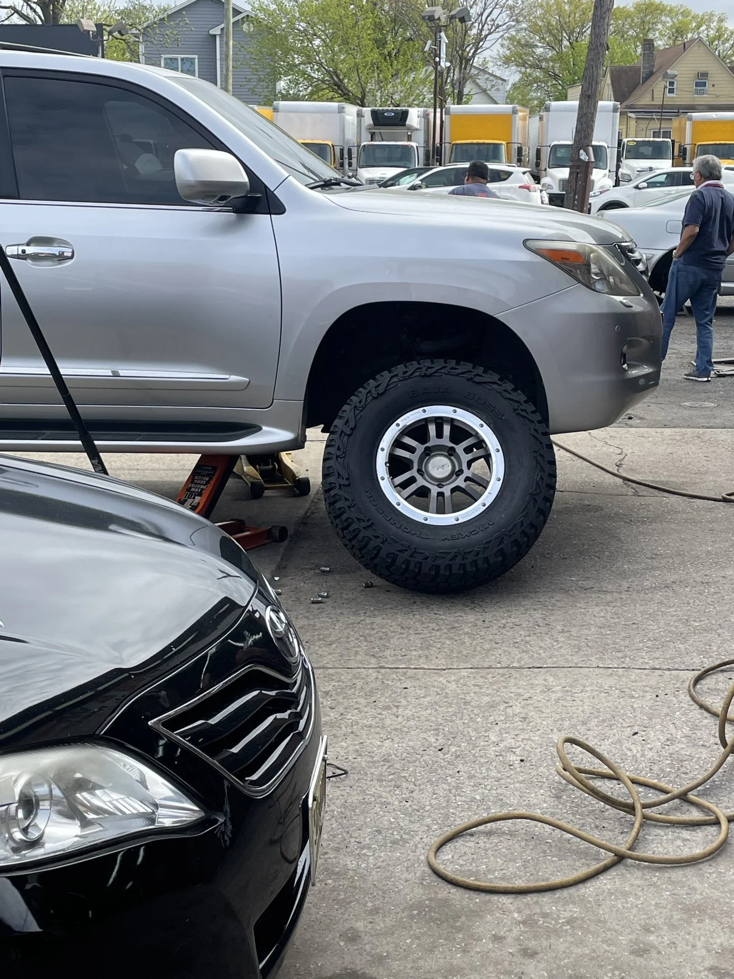

I have these exact tires ordered for my 200. They look great. I can’t wait for them to come in.

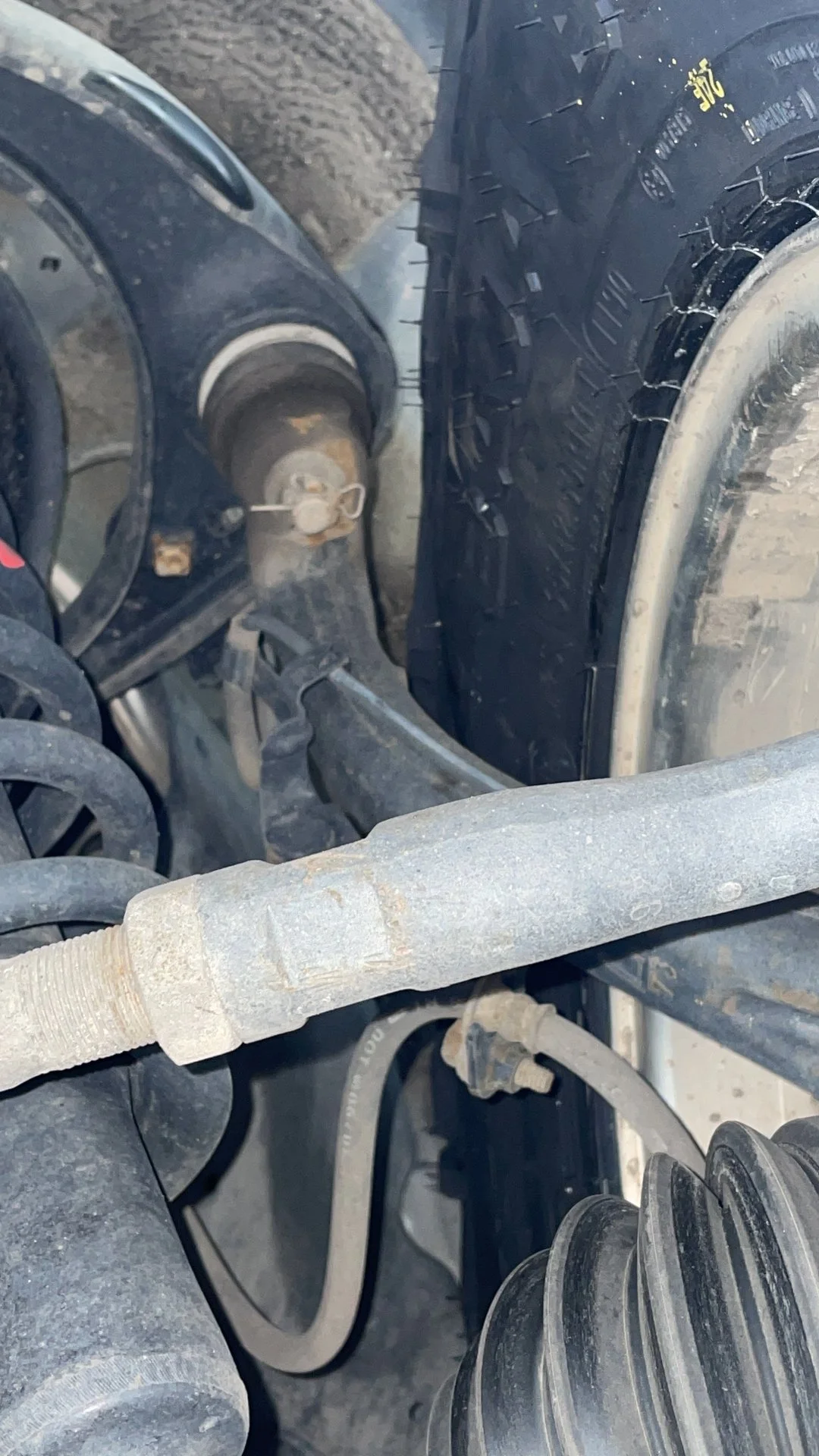

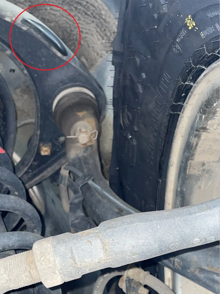

You'll want to watch this area and it's something you'll need to address. The Baja Bosses being an aggressive tire, and 50mm offset, is going to have some pretty bad interference here. It's going to be full stuff with steering dialed where the problem will show up. You can already see the witness marks showing clearly where the issue is and it'll get worse with more compression.

Thanks I figured that there was going to be some grinding since those Baja boss the side bitters are huge! I was biting my nails cause I thought for sure it was going to rub on the UCA. It when the guy placed the tire I put my hand in the back before he lowered the truck. That was a relief that I was able to drive it home to start the other modifications. But in super happy with this mod. I’m definitely doing the uca mod on mine. 💪🏽😎 I’ll post pictures when completed. 🍺. I happy that I didn’t have to do the body mount mod. I wanted to keep it as sock as possible. At least that part of the frame.

My 295/70/18's rubbed the sway bar quite a bit an almost ripped the front of the rocker off leaving the discount tire even with a 1" spacer. I'd be shocked if yours don't rub under flex/reverse. I'm frankly astonished that you fit a 12.5" wide tire on 50mm offset! Be sure to flex it out.

I think most UCAs have a good chance at fixing the clearance there. If I'm staring at them right, they generally have their structure well above the ball joint. Whereas the stock ball joint is nested deep into the structure.
Also note that because UCA generally try to correct for caster, they do so by locating the upper link further rearward. That's kind of the opposite of what you want, meaning you want both UCA and LCA to move the tire as forward as possible, to clear the body mount. Ideally, the UCA will be about stock geometry, and you'll want to have the LCA adjusted forward to achieve the right caster, as this configuration buys the most clearance against the bodymount. Something like the SPC probably gives you the most choice to get that combination.

I just can’t cut any further back than the door hinge, otherwise it can all go away up to that point 😉

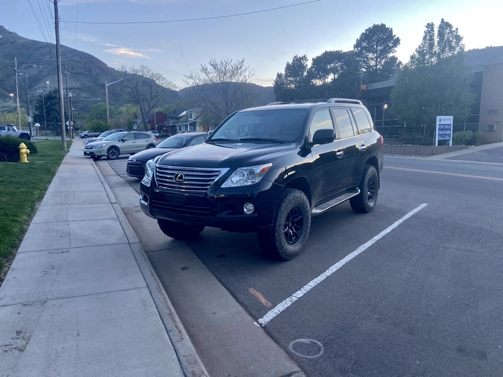

I guess I can join the club. 285/75r18 Terra Grapplers. I don't love the look and I'll probably go wider, and possibly move down to a 17" wheel whenever these wear out. Good deal on CL is how I ended up with this. No lift, just rearranging the plastic liners around the front tires. 1" bora spacers.

I just can’t cut any further back than the door hinge, otherwise it can all go up to that point 😉
Does the fendor bolt on and off or are there some spot welds to drill out?
Fender unbolts pretty simply. Just need to create a new bottom attachment point since that’s now been cut off. Nutsert and new angled support leg should work.

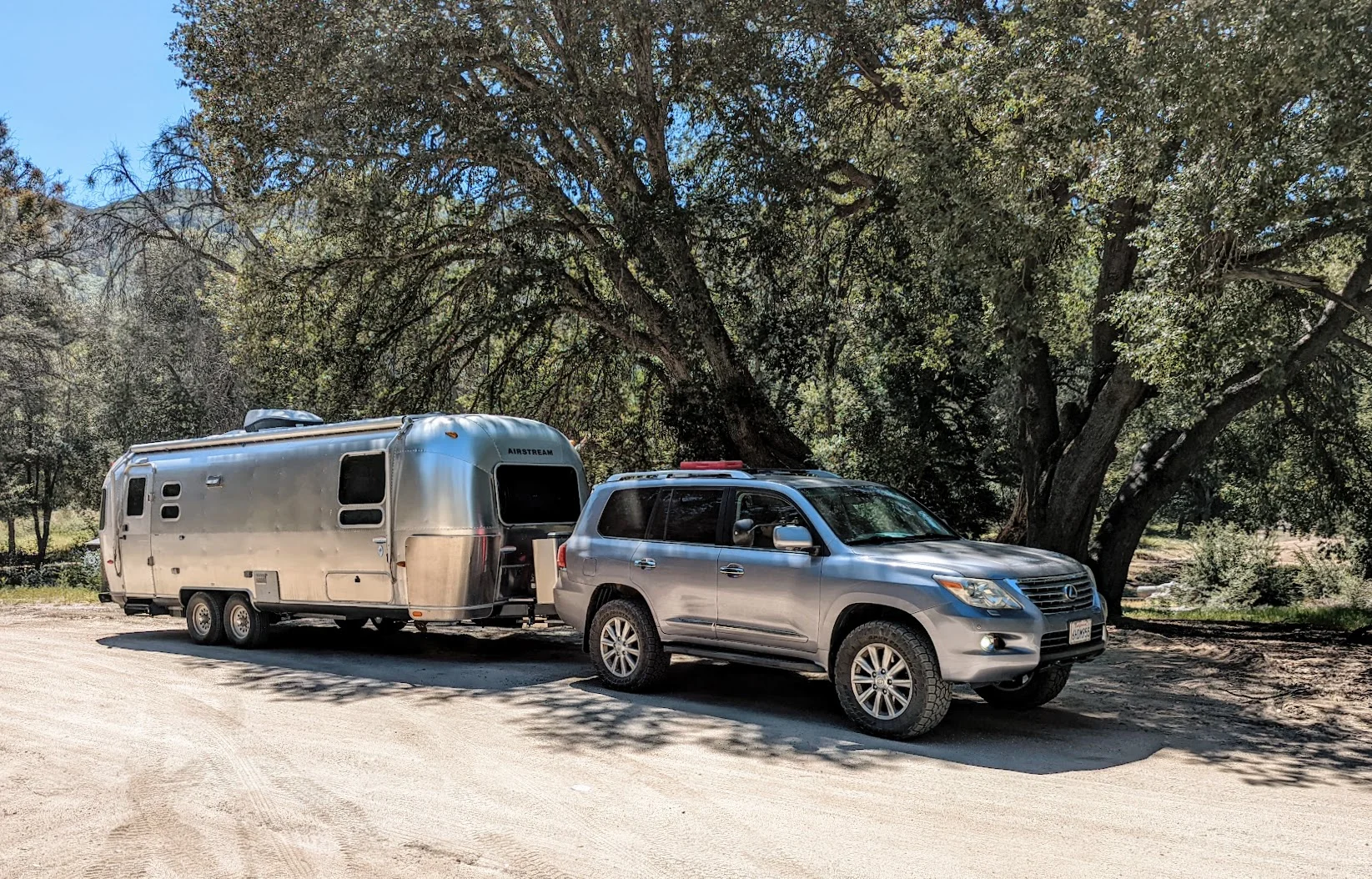

One of my hesitations in going to larger and larger tires has been towing performance and stability. Especially when towing or exceeding the upper end of factory capacity. Can share that she still tows with confidence. Re-gearing with 4.3s correcting to practically stock gearing, bigger Tundra brakes to correct leverage and increase heat capacity, with minimal lift and offsets to keep as much factory geometry as possible.
My trailer is lifted 2" and use to drawf the LX. At least in presence. With 35s, not so much. The 33s did tow with a tad more stability, but I think that was as much just having less sidewall. I inflate the 35s about 8PSI more for towing which gets me back some stability. I would say the 20" wheels, especially in larger and larger tire diameters, is pretty key to maintaining stable towing performance.
Now @MTKID has me wondering if she can tow well with 37s?
As I’m sure you know, larger (or smaller) tires basically act as their own quasi “re-gear” and the effects are inescapable without a corresponding actual gearing change. And… as usual, its a matter of degree…where subjective thoughts on what constitutes an acceptable compromise.
So as usual, the only sure answer is…
