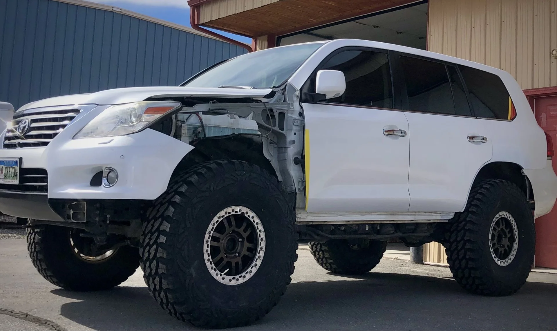

I have 37/12.50/18s on mine.
Yea ... I'm going to need some more details on this bro!

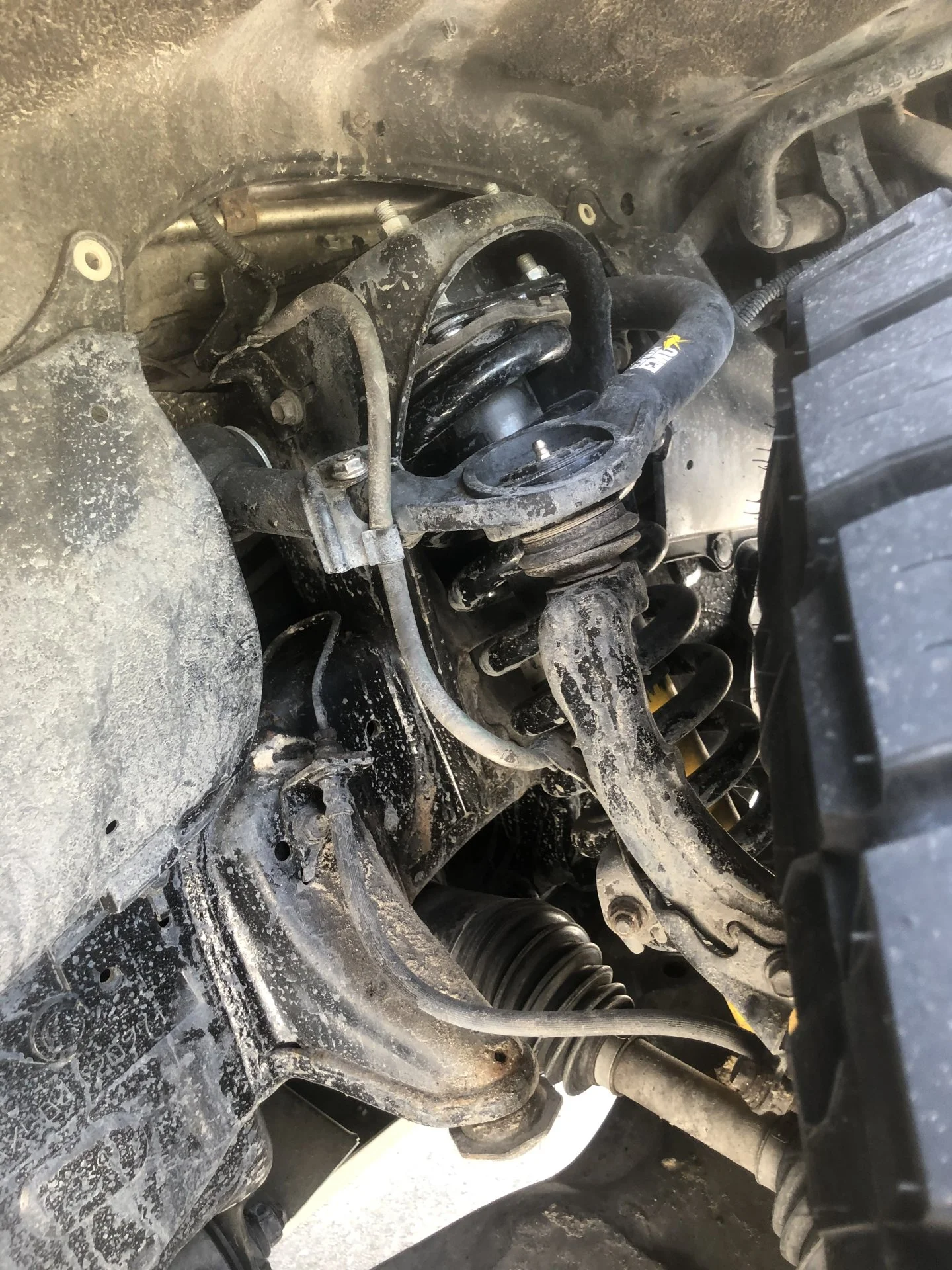

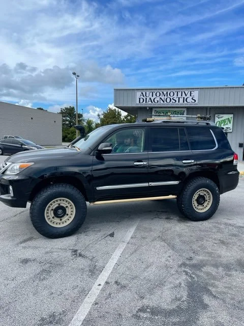

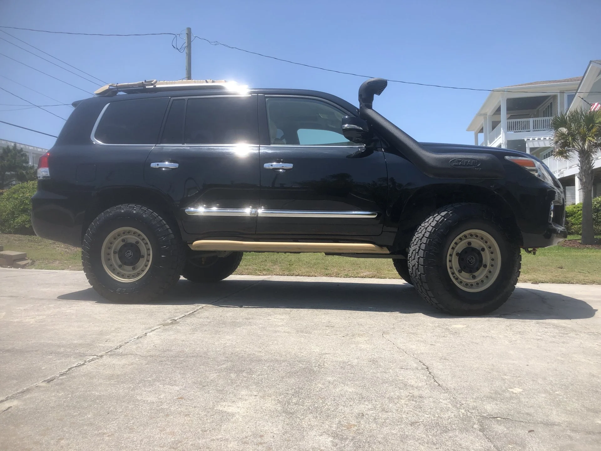

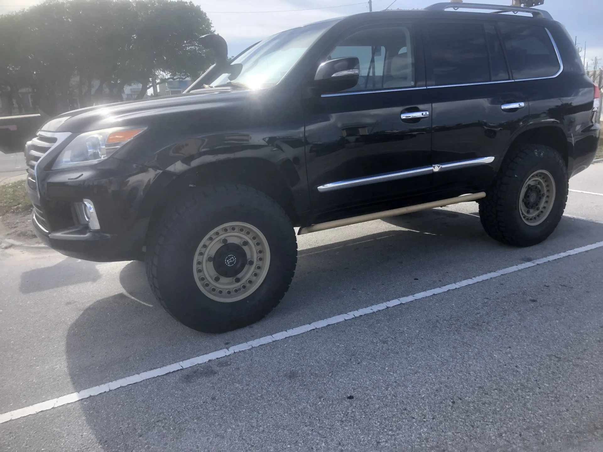

Well here it is.. 37 inch TOYO AT 3s. I will post step by step on the how too later. Bumpers are back ordered, but will be here in about a month.
So far- diff drop, sway bar relocate, 2.5 old man emu, 2 inch leveling kit On front, modified front body mounts, modify OME upper control arms, trim plastic out of wheel well, 30mm off set wheels, and a few other things.
No fender trimming. They do not rub. No additional spacers

Wow insane set up, way to go!

Way to go. Definitely will need more details. Interested in what you had to do with the upper OME arms?

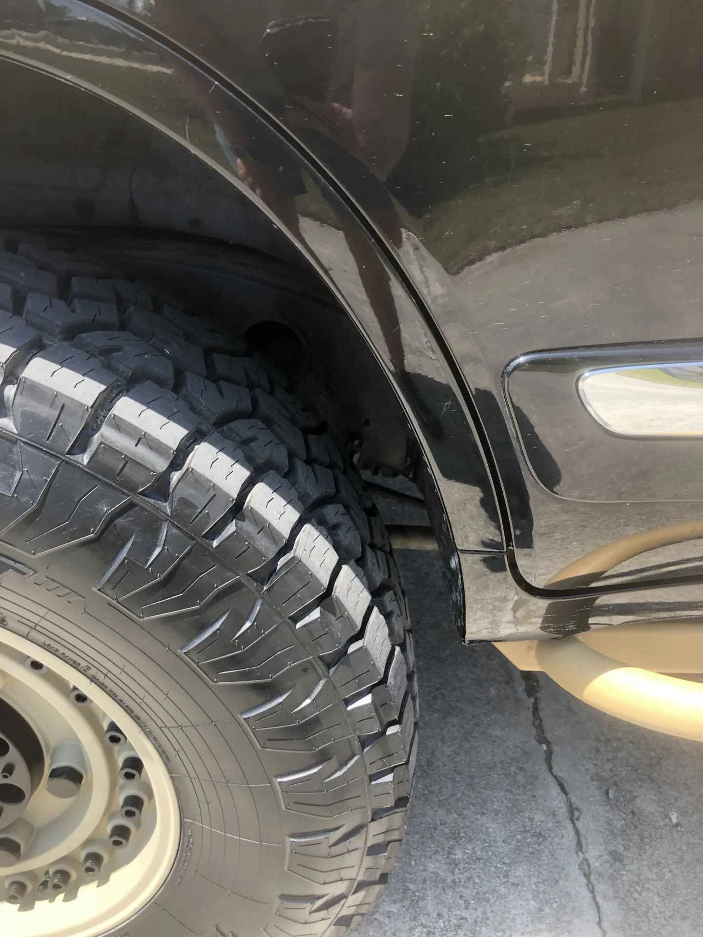

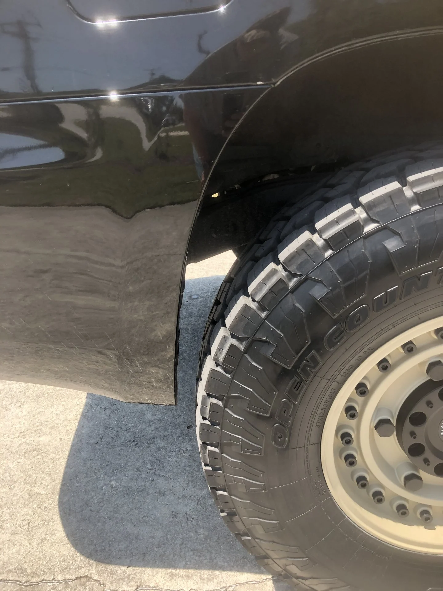

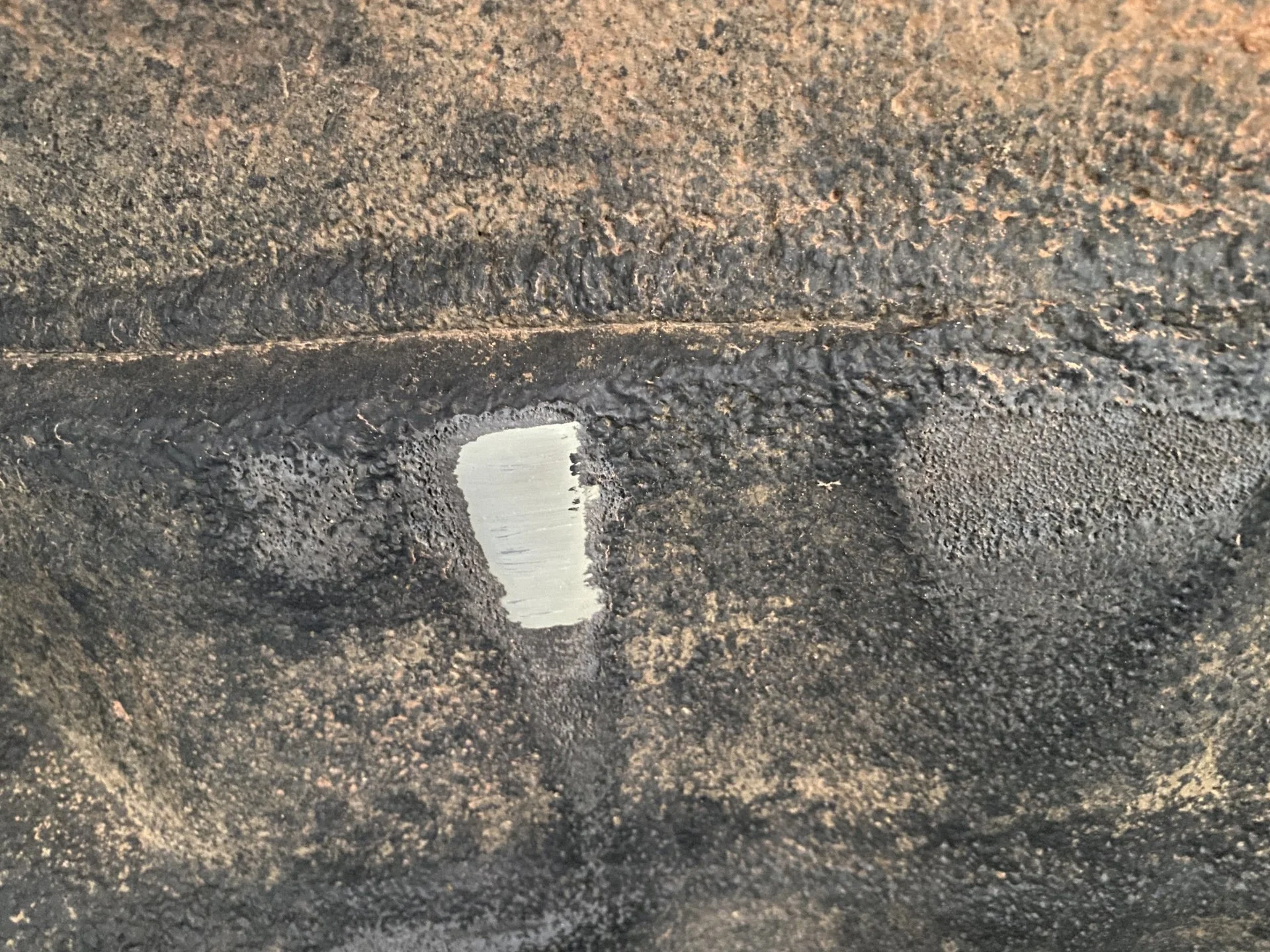

I just don’t get how they don’t rub when fully flexed. Rear especially. 35s run plenty
Had it out for the first time this weekend, had no run issues. Seems to be plenty of space in the rear with the wheels I have, and the OME Heavy suspension.

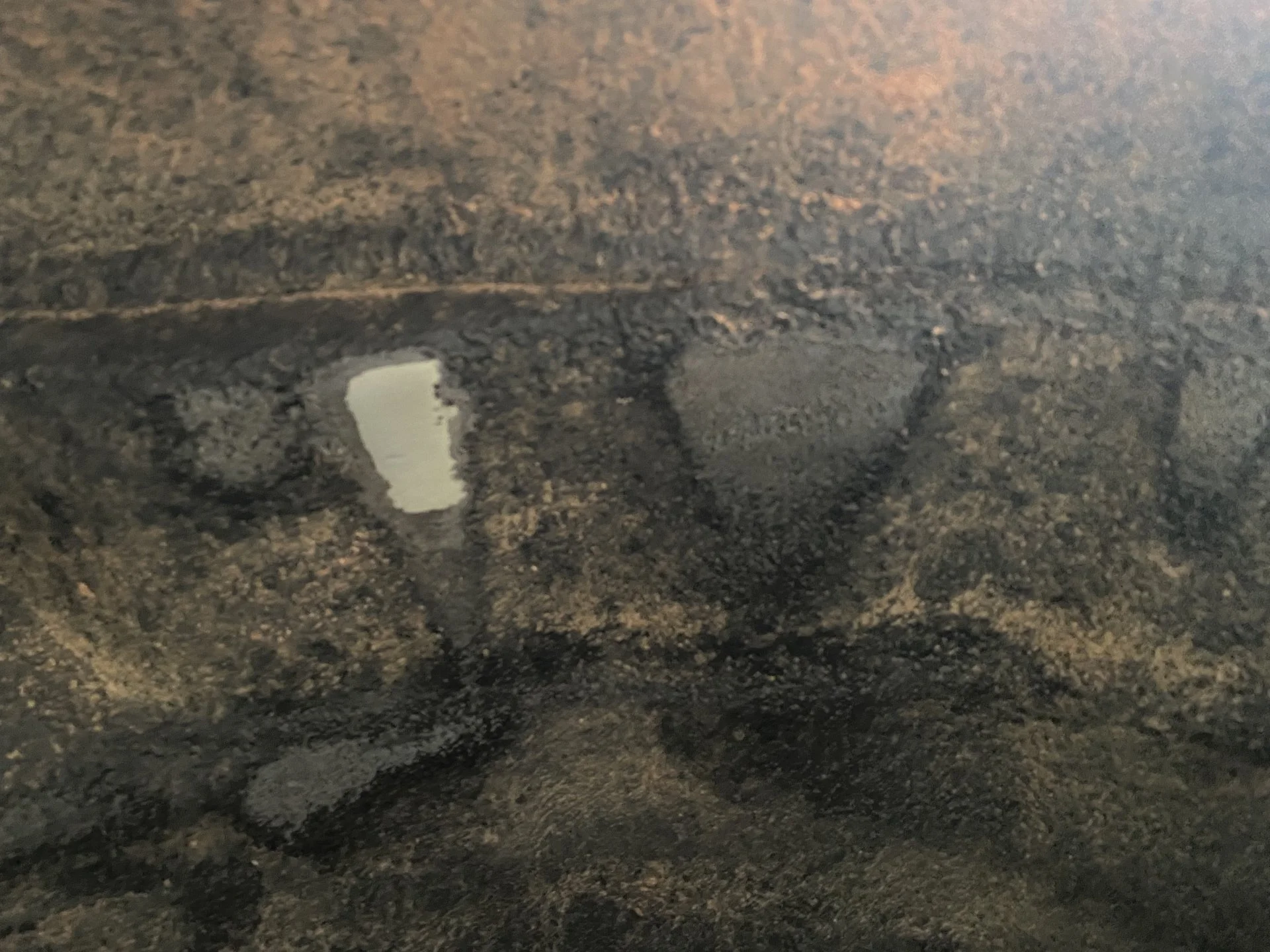

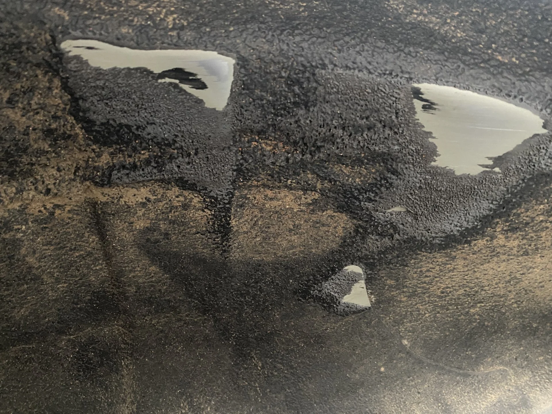

Dang, it must have been the heavy springs not having you bottoming out on your bumpstops then. Or you weren’t completely flexed in the rear. A full week in Moab had my rear fender wells looking like this with 35’s.
