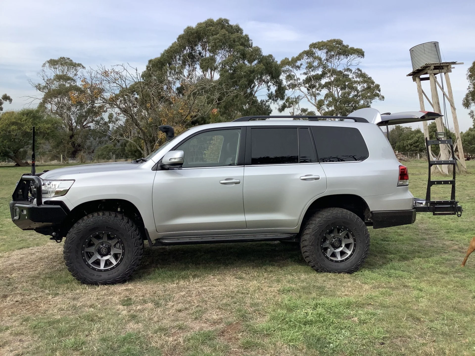

Here in Australia we are not allowed to use spacers, so its important to get the offset correct, the Icon Rebounds I used are 17” +25 with 315/70R17 MTRs
This is great as we have largely identical setups. No rubbing? Did you relocate the KDSS?
Still a little rubbing on the KDSS arm looking into a relocation kit, Blackhawk UCAs and alignment solved most problems then a bit of heat gun

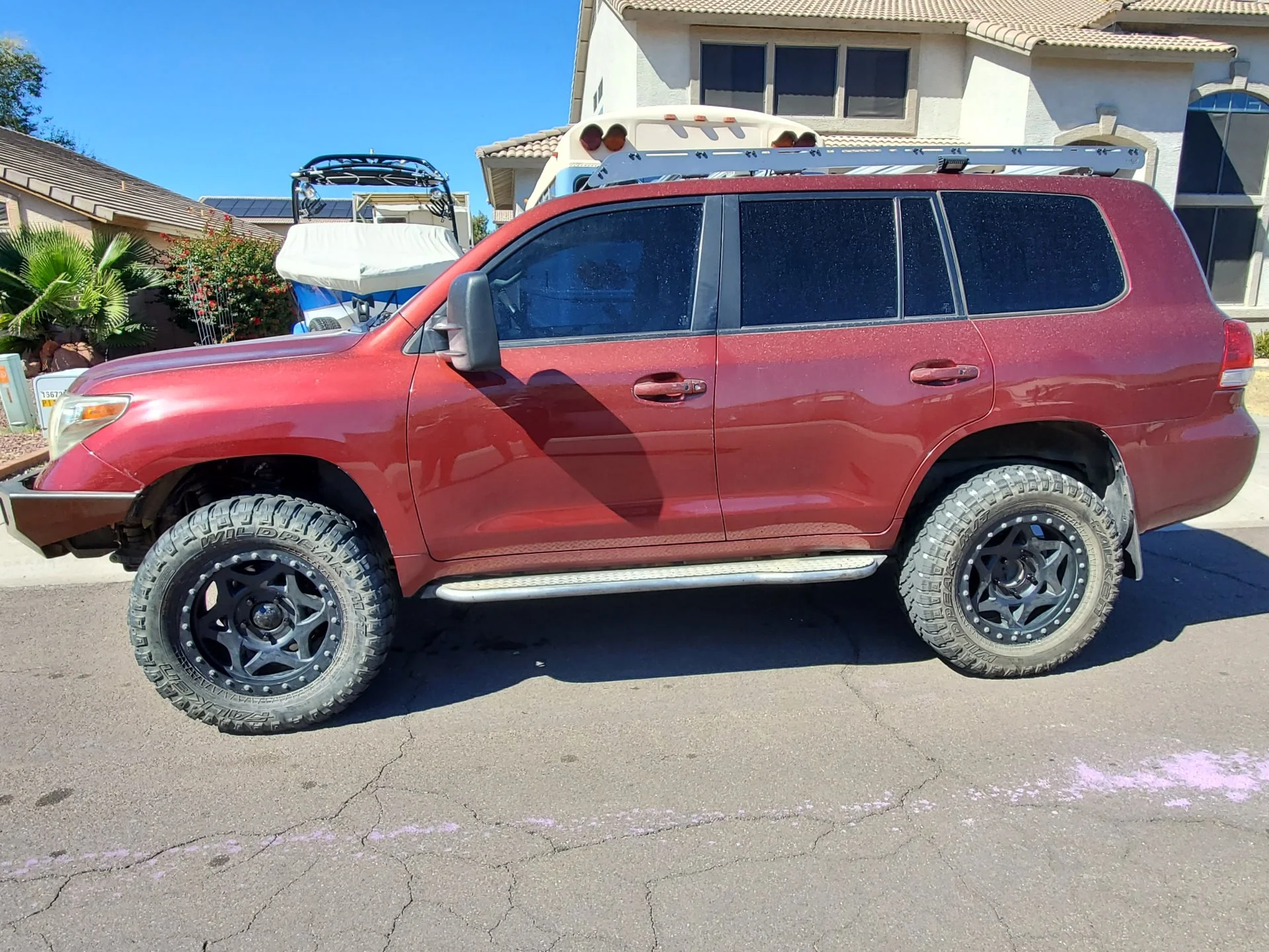

2009 LC with the Tundra front swap, KDSS relocation, 35x12.50r18 General Grabber MTs on Tundra Pro BBS wheels and I'm getting rubbing on the KDSS arms at full lock as well as rubbing on the SPC Uppers at certain levels of droop (and real close at ride height).
Anyone running a smaller spacer up front to avoid this or have another recommendation (short of different tire/wheel combos)?
.75” Bora spacers.
Any issue with the factory front studs clearing a .75" spacer?
Depends on which wheels you run.
No issues with my Rock Warrior wheels, which have voids adjacent to all studs.
