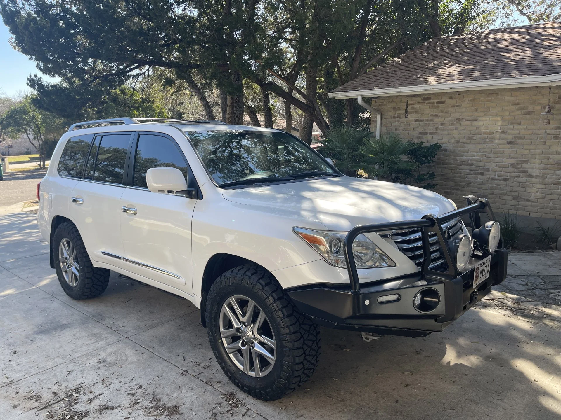

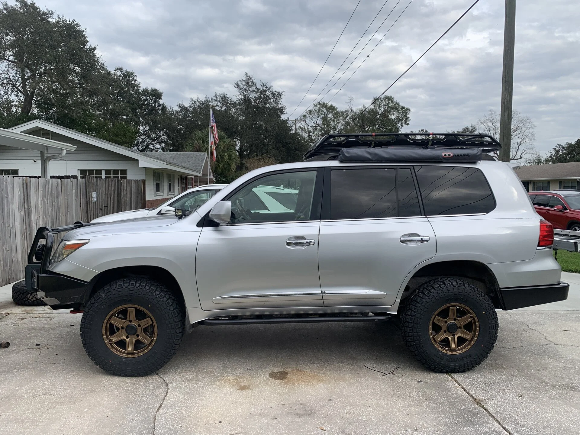

315/70r17 Ridge Grapplers. Sensor lift. Straightforward mudflap trimming. Blown away at how easy it is to fit dirty fives on the LX!

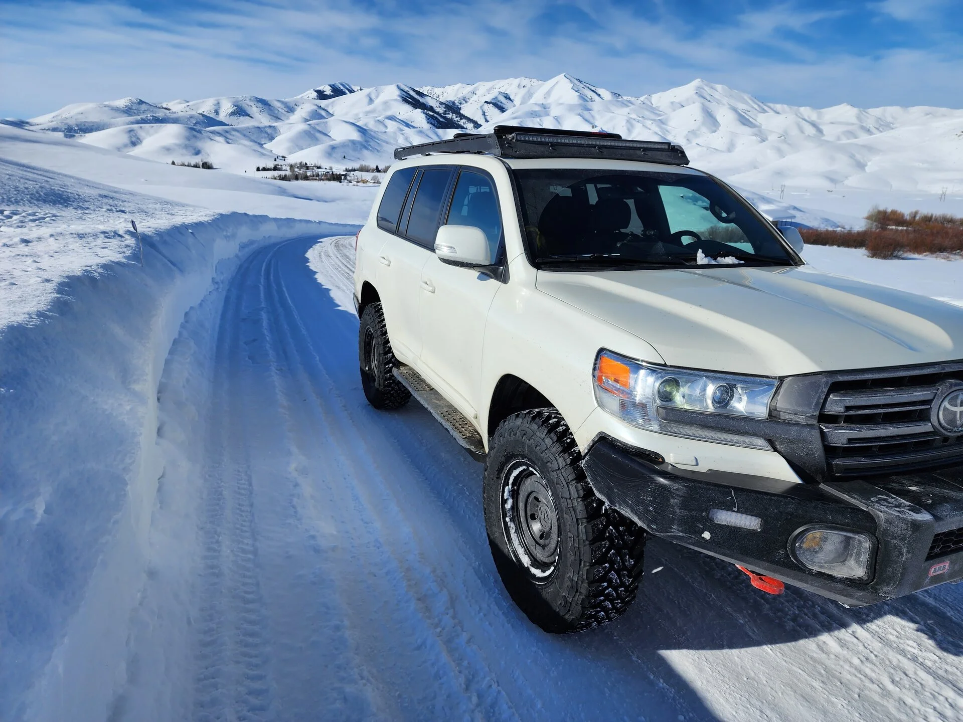

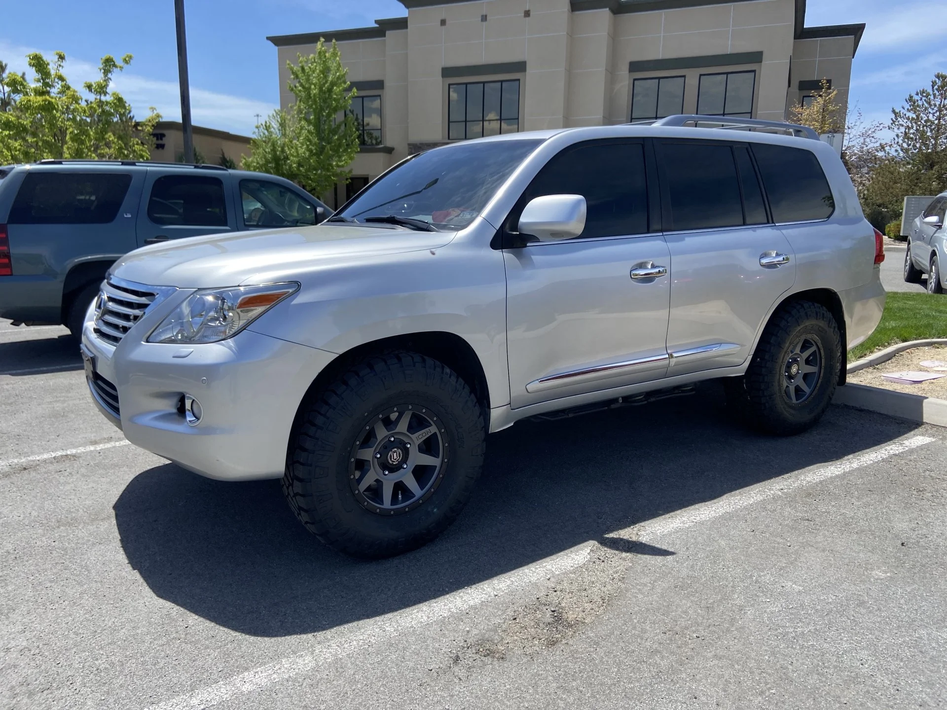

I went back to 34's and I'm pretty happy about it. That is NOT to say 35's didn't work...they did. But you can count me as one of those folks who feel like our rigs are happiest at the magic 34". She feels a little more peppy and and a little better centered.
I'll keep the Kenda/Icon set for winter driving but bird hunting is now taking me to some pretty muddy deserts, so the MTs are in season.

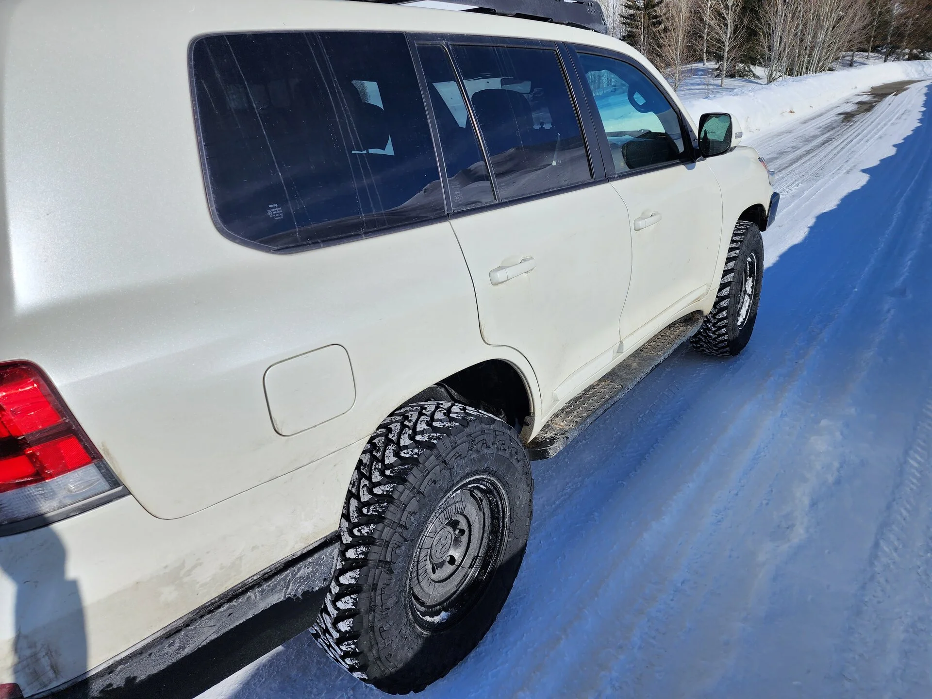

285/75 R17 Toyo M/T with Fifteen 52 wheels. KDSS relo and some trimming/pressing done previously for the Kendas.

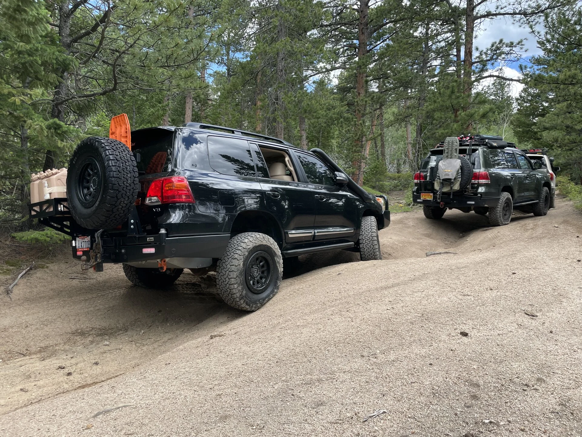

I don’t know if I’ve posted here but I recently did 35’s on a swing away and decided the hassle of messing w the tire on the swing away wasn’t worth it.
I ended up doing what teckis300 did and put a 275 65 r20 in the spare tire location.
I measured that spare tire are under the car repeatedly and it looks like 34.1” (actual tire size on the wheel) is about as big as you can fit under there without hitting the panhard bar.
A worn slightly worn cooper discoverer 275 65 r20 measured in at 33.9” on the rim and easily fit. The kenda 35x10.5r17’s measured 34.75” on the wheel (34.5” on the wheel under weight of the vehicle).
Photo of a mounted brand new kenda and a mounted 275 65 r20 for comparison.
For anyone trying to do the 35’s, it’s not very likely the spare will fit under the car.
On long road trips I plan to bring the full size spare either on the swing away or on a trailer…but for normal driving, I’m hoping a 33.9” tire, inflated to 65 psi…and a few 34.75” tires inflated to 27-30 psi…should get me home to my full size spare.

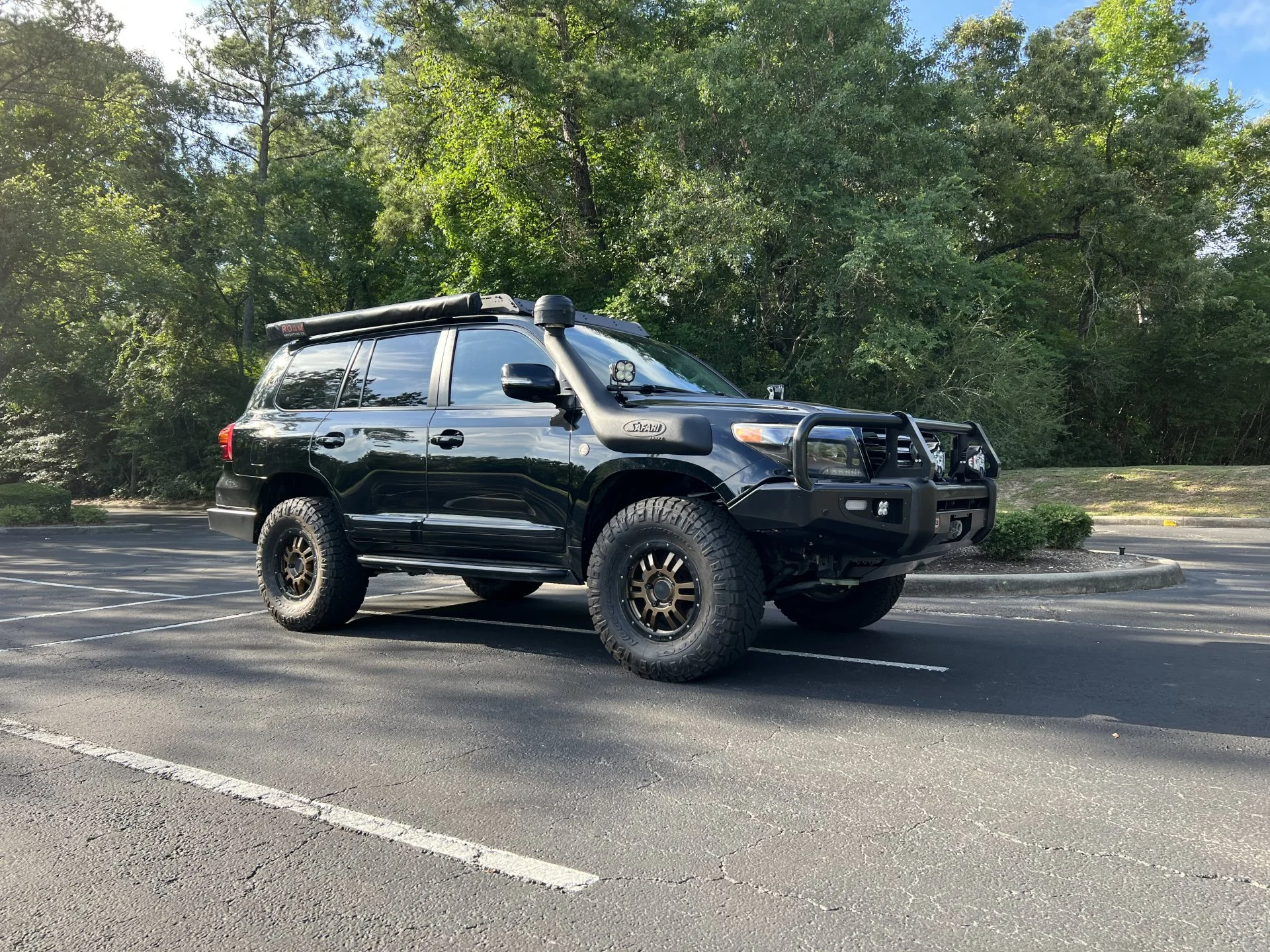

As you know, I am (now) running 315/70R17 BFG A/T KO2s. I have NOT done anything with the seat belt bolt, the KDSS, or the bump stops. I DID however do the body mount chop, but that’s really it.
Upon full stuff, it does kiss the rear body.
Maybe I got lucky. Maybe it’s too soon. But I now feel 35s should be the norm for the 200.

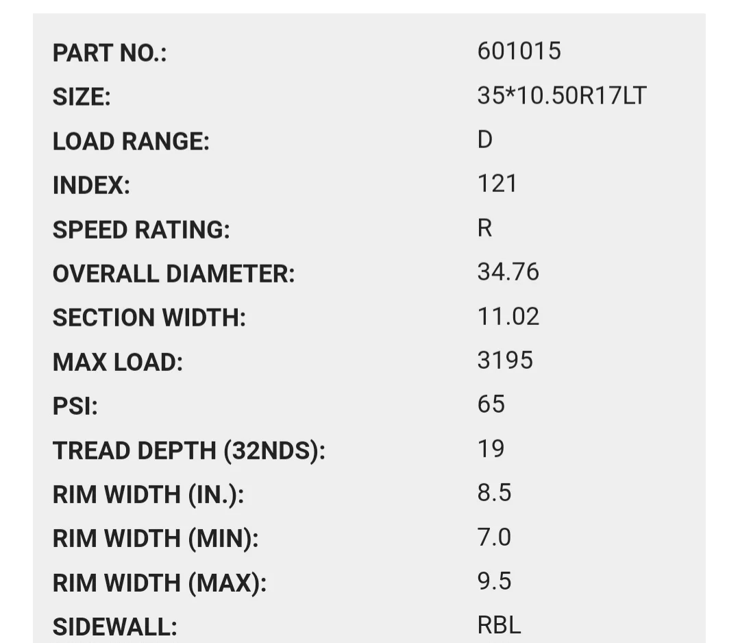

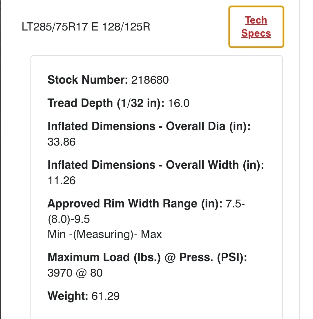

I'll cast my vote for the kenda klever RT in 35x10.5xr17. The klever RTs measure wide for their respective size so don't be scared by the 10.5 advertised width. My experience with their 275 width RTs had them measuring the same width as my 285 yokohama MTs. They are a super tough tire and held up way better to chunking and sidewall damage then what I am seeing out of the yokohama G003 MTs. A little dissapointed in the durability of the Yokos.
The 35x10.5xr17 measure over 11 inches in width and are only 1/4" narrower then your 285 nittos.
First image are the specs for the kendas and the second is the nittos.
You can find the kendas too for between $260 and $300 a tire.

Those Kendas in the 35x10.50r17 measure a disappointingly tiny 33.4" tall in my experience. Stick with the Nittos if you want something closer to advertised size. It bothers the hell out of me that many tire manufacturers can't stick closer to advertised sizes (I'm looking at you BFG...)
But on the plus side, if all you're after is the "35" on the sidewall, the Kendas or BFGs are the easiest way to accomplish that.:hillbilly:
