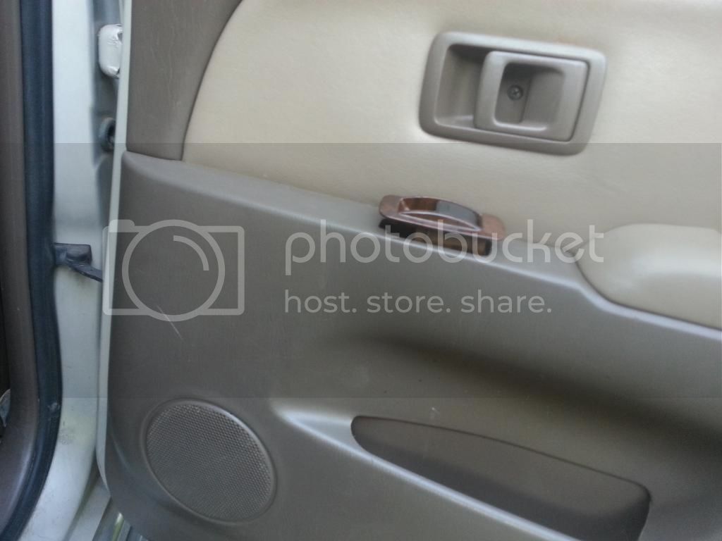

This window does not roll down. I think the previous owner tried to fix it but did not succeed.
There is a big dent on the tail-gate. I wonder if that's the reason that it doesn't roll down...

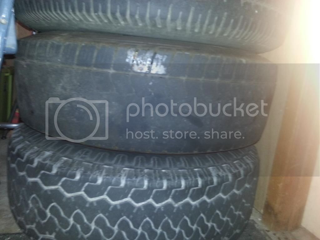

Here are the tires it came with. The rims were the split 3 spokes. The front tires were wearing heavily on the inside. One of the tires started showing threads so I put the wheels and tires in the pictures above. I want to fix the front suspension ASAP so that I can get it aligned.

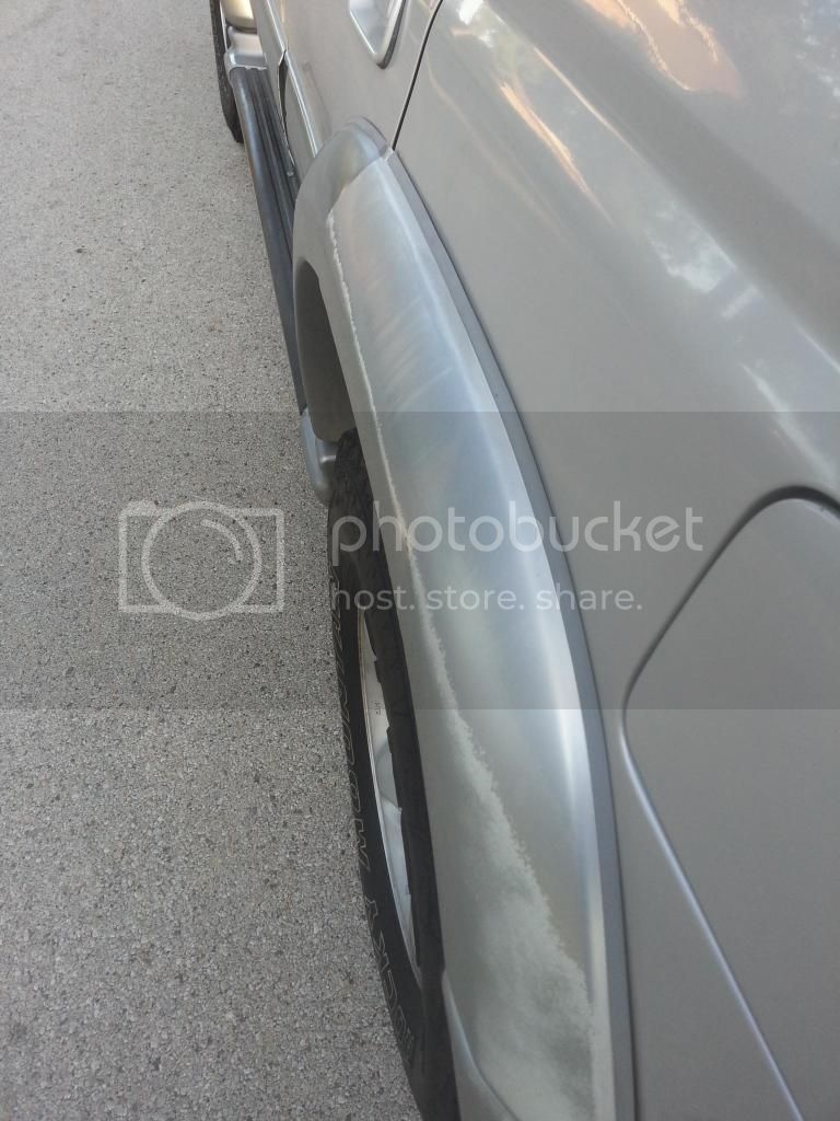

The paint is fading in several places...

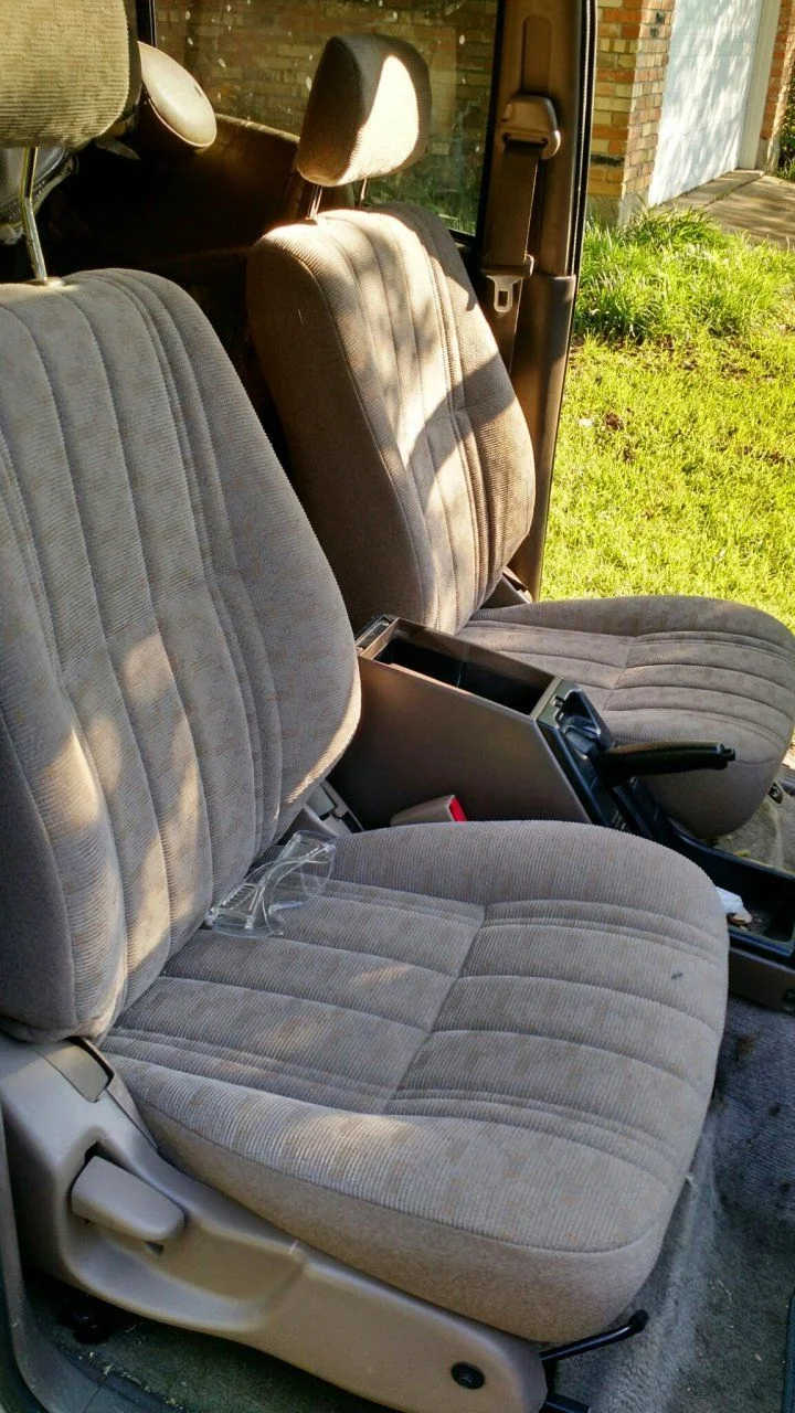

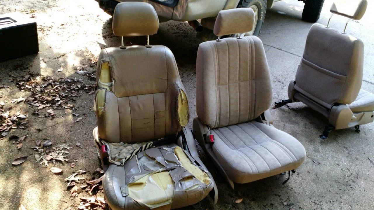

The front drivers seat is pretty much completely shot. The passenger seat is ok. I really want to find some non-power seats to put in there.

That seat...:eek: wow, that needs an award for the most worn ever still usable, EVER. Just slap on a cheapo cover if you get tired of having yellow foam stuck to your butt.

Do the LBJs, OTRs, and rack bushings at the same time. I'd say about 2-3 hours work of planned properly. That should get it alignment ready. Check a few U-pull yards for seats from anything. Different post/bolt patterns are an easy fix. Walmart sells cheap single din radios and a something to fill the other slot can be fabbed out of most anything.

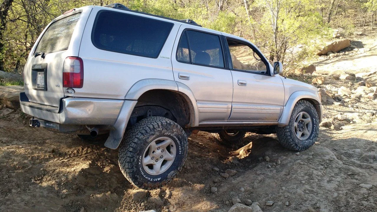

I wanted to give you guys an update on "back alley sally". She just hit 330k miles! I initially thought i could buy the truck for $1500 and just start adding cool stuff to it. Boy was I wrong. It's been a year since I've bought it and I've spent about $5k total on it (and it's still stock :( ).
Here is where the money has gone:
-New UBJ, LBJ, ITR, and OTR's.
-Poly Steering Rack Bushings
-New steering rack and power steering pump (moving the rack to install the bushings busted the seals on the old unit)
-"New" Cloth seats
-265/75R16 KO2's
-Tundra Brake Upgrade
-Denso Starter
-Toyota heater hoses and radiator hoses along with a Toyota Thermostat and Zerex Asian coolant
Purchased and pending install:
-Toyota brake lines
-Toyota fan clutch
-Toyota fuel filter
-Upper and lower A-arm bushings
-CB Radio
Pending Purchase
-Bluetooth radio and some new speakers
Slowly but surely she's coming along. Hopefully by next year I will be able to install an e-diff or lunchbox locker and some armor. Im really happy with how good she's been.

We just installed a Grizzly locker in it! :bounce:
This truck has had a ton of work done to it in the last couple of months. I need to post a big update on it.
