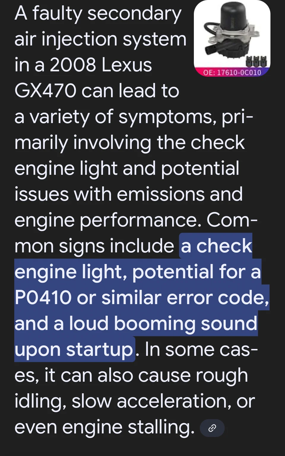

I’m no expert on this, but a common problem on VVTI engines like yours is the secondary air intake
Research this issue more

my SAIS is bypassed. I of course go to lunch no problem at the time. the only other weird thing thats happened was a couple of weeks ago I was getting an extremely strong raw fuel smell in the cabin.
