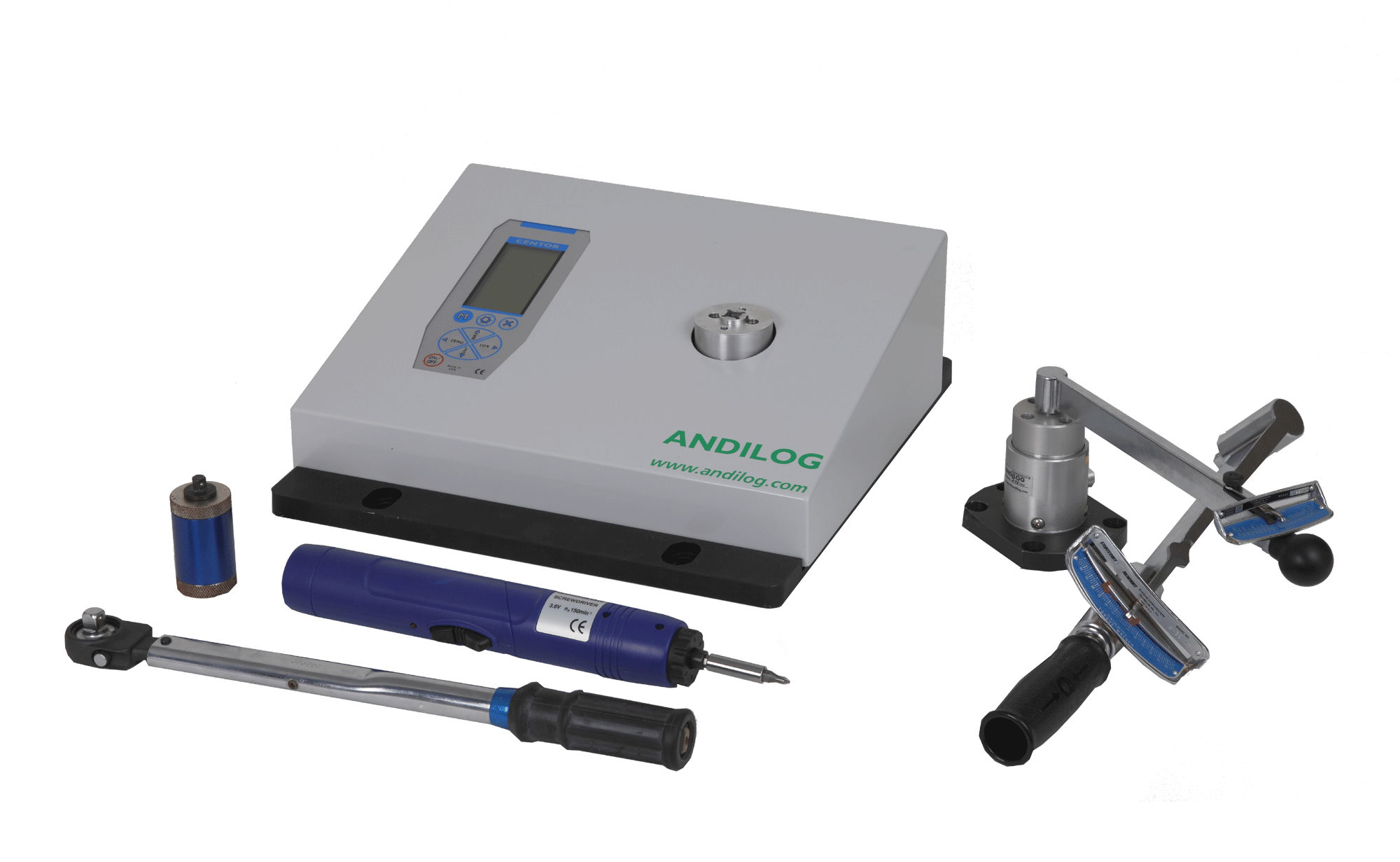

5 Not being inept is one thing, but a torque wrench that has gone loose is another and what apparently caused some of my hub studs to snap on a recent trip, they were overtorqued b/c the click-wrench needed calibration and was off by 11lbs even though only a few months old.
Whatever happens seriously consider finding a shop with one of these or getting one yourself, I am glad my father had one to use.
