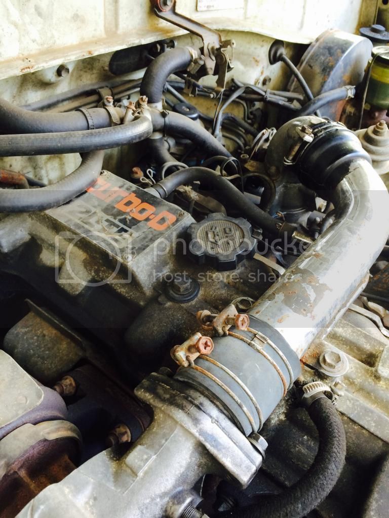

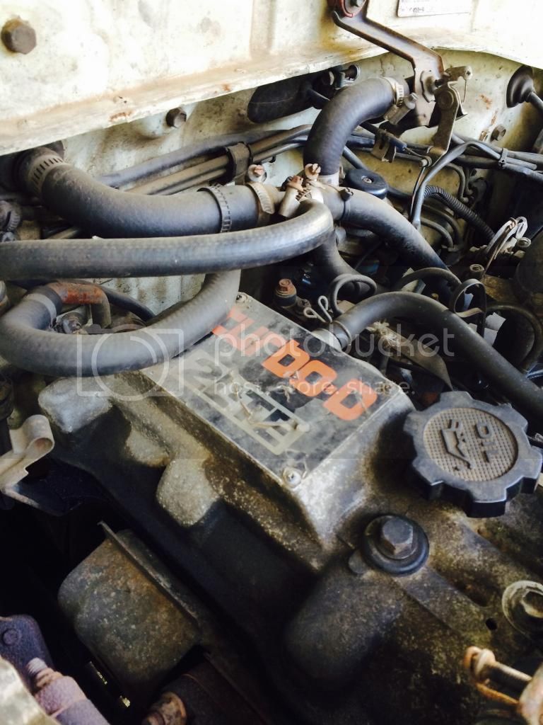

Ok, so, lets start from the obviously stated on the photos, the 2L-TE Engine badge. I would just assume its a normal 2L-TE if I hadn't read multiple times the 2L-TE derives from the 2LT2, and that both have the valve cover with multiple screws all around.
Instead, my engine seems to have the 3 center screws usually associated with the original 2LT. Was there an earlier version of the 2L-TE with this valve cover??

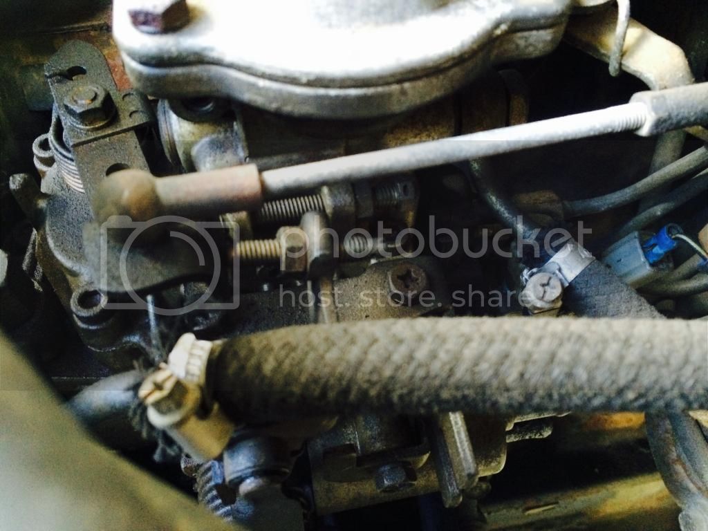

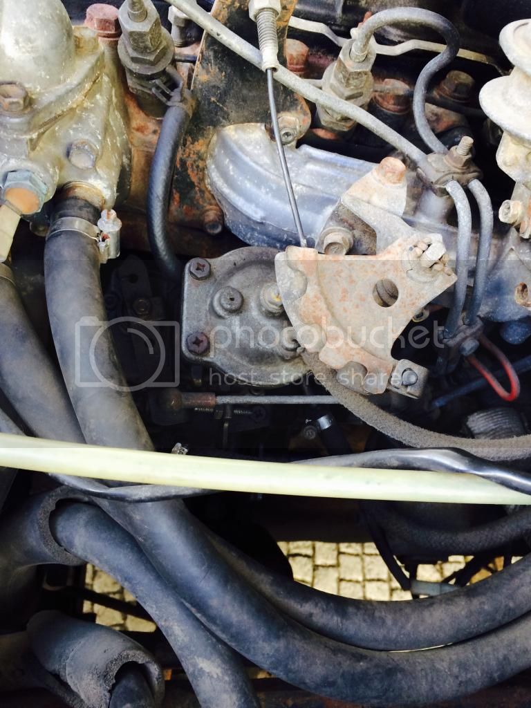

Then we go to the fuel pump, which should be electronic on the 2L-TE, but from what I've seen online and on the repair manuals, this seems to be a manual pump. I couldn't take much better pics of it, but if anyone can confirm this it would be great!!
Here go the engine photos:
The fuel pump:

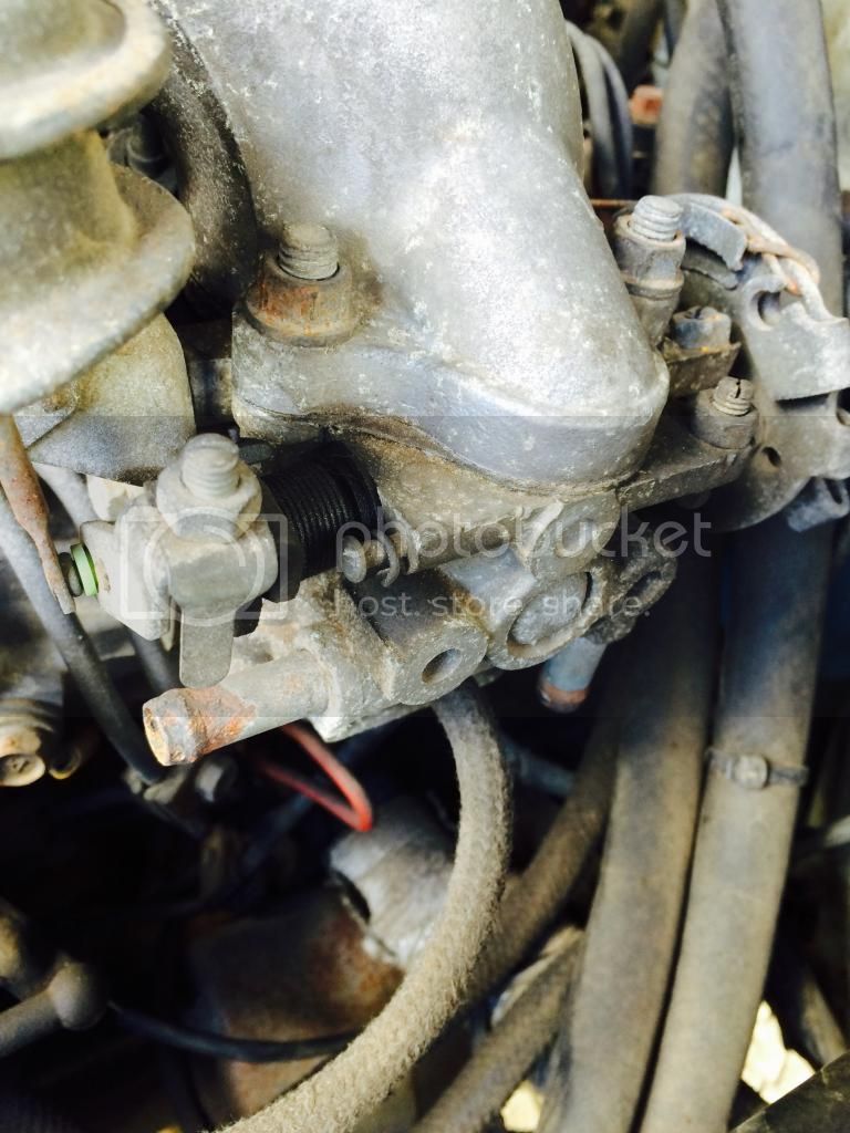

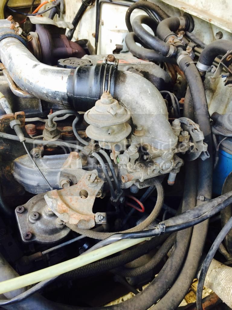

Then, there are this two things where I can't understand whats happening as there are disconnected tubes.
This one (maybe its the EGR removal??):

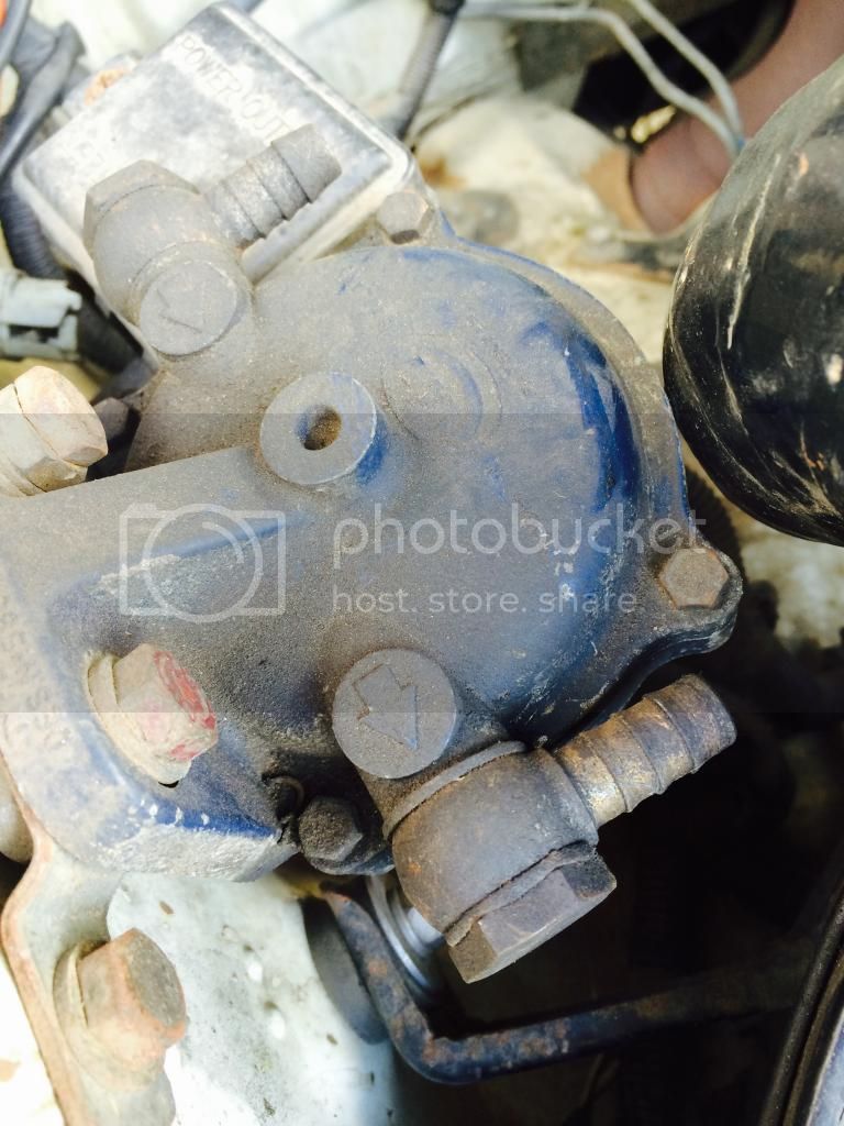

And this thing, that is bolted to the side of the engine bay:

Maybe the PO removed parts of the EGR system, either out of head concerns or just to get a bit more power?

The thing bolted to the side of the engine bay is an aftermarket Delphi type fuel fuel filter although there are a few companies that use the same design. Which begs the question on what it is using now for filtration?
Its a good design although it doesnt have a primer pump on it.
Judging by the inlet/outlet pipes on the inlet manifold, I would say it was a 2L TE with the troublesome fuel pump removed. Im guessing the coolant flowed in/out of those pipes to sensors to help with the adjustment on the fuel pump,but as I said ,its a guess
The electronic gadget on the pump is difficult to work with. I forget the specific reason ,but getting instructions in english was one problem with it.
Looks like a 2lte setup from the Hiace we have here.
Looks like you have the IP either from a 2L or 2L-T.

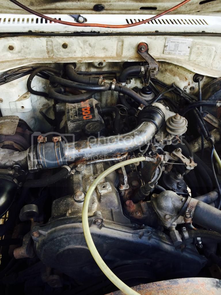

Let's see more pictures of the whole engine bay, and the filter assembly.
Here we had the cold specs filter bracket with heater element.
Ok, I'll try to snap a few more pics of the engine bay and filter assembly as soon as possible.
