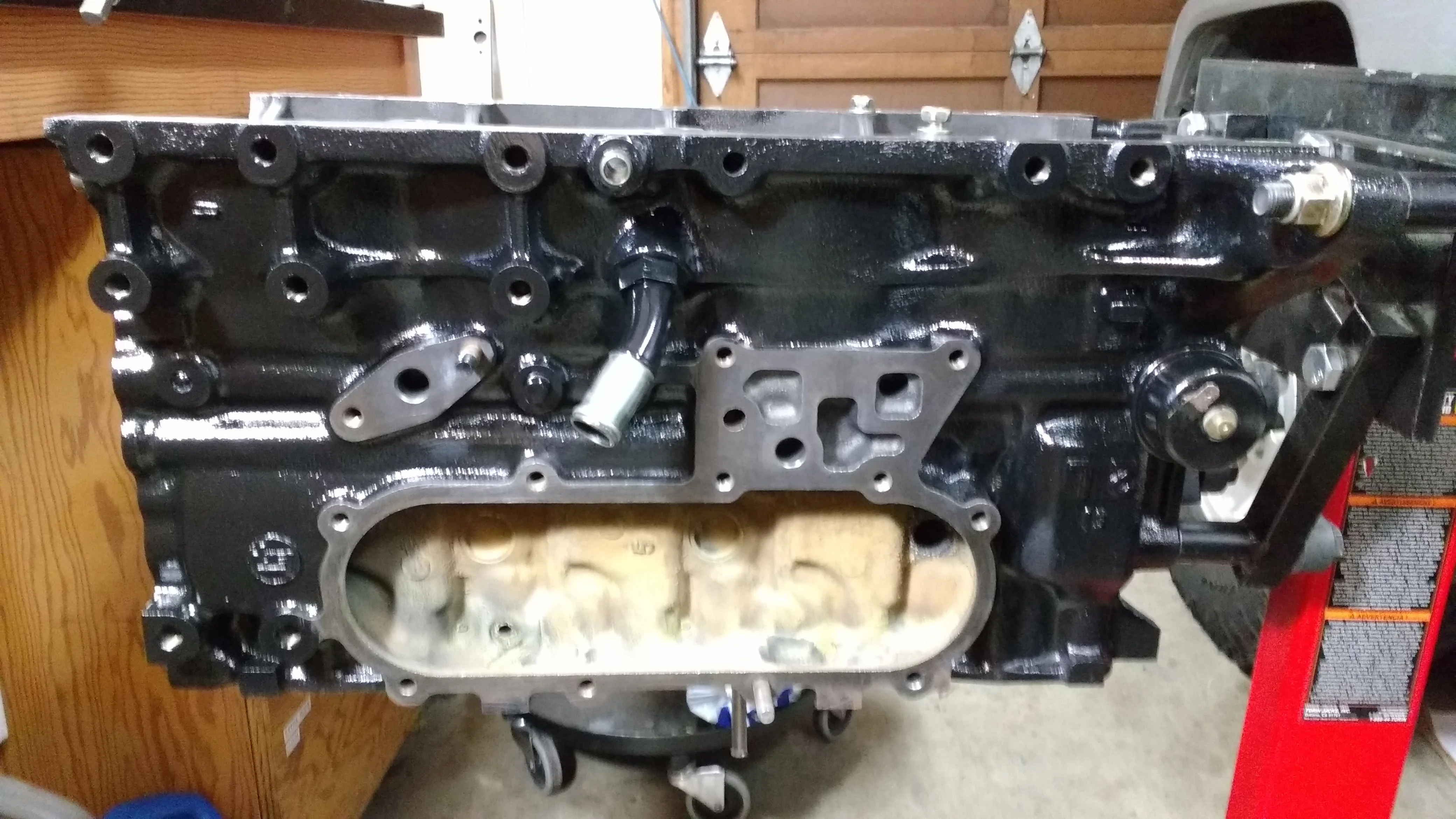

Here is a picture of my oil cooler when I did an engine refresh a few years ago. I never could source the internal cooler core gaskets with the three stud attachment. Newer 2LTE oil coolers have a two stud system, and those are available.
More pics at this link: 2LTE semi-rebuild

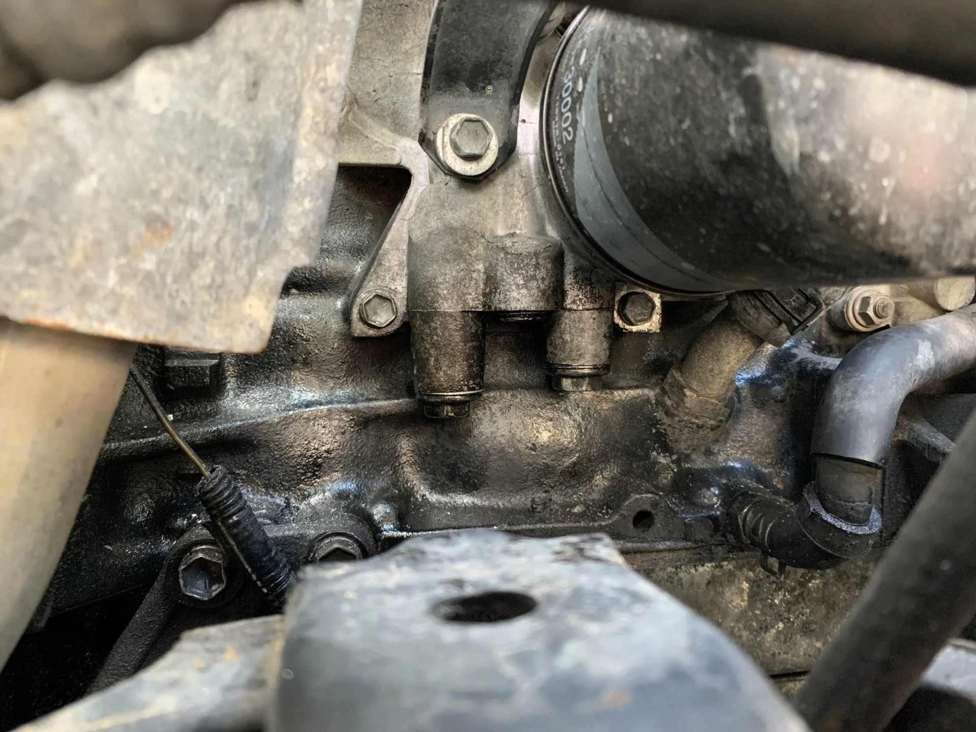

After de-greasing again and going for a drive I’m pretty sure it’s coming from one of the vertical bolt heads in the bottom of the cooler. I’ve got new gaskets coming this week and I’ll swap them out, any tips? I’ve read those bolts are very tight and are tough to get out.

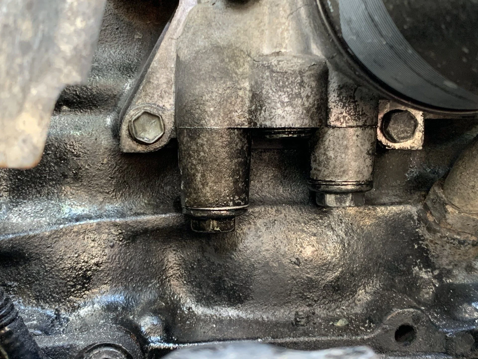

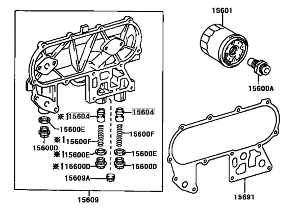

By vertical bolts heads do you mean the bolts holding in the oil pressure relief valves and springs? Can you post a picture? Those “gaskets” are soft metal washers, same thing you’d see on a banjo fitting. You might try just cleaning up those washers and tightening the bolt back up.
Yes, I believe we’re talking about the same bolts. Photos are attached below. I have new metal washers coming, not gaskets, hopefully it’s an easy job.
Super easy. There's a spring and relief valve in there that may or may not fall out. You can measure the spring and check spec for what that length should be if you're so inclined.
