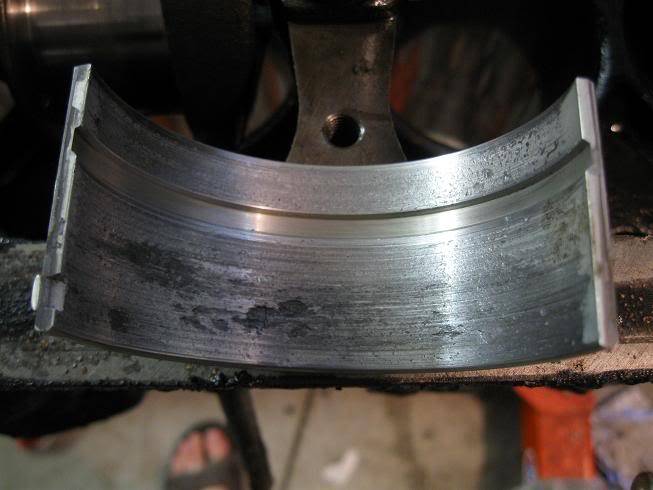

Bearing from #4 crank cap looked pretty ugly:

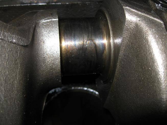

Took all the pistons out - when I got to #2...I swear there was no bearing! Here's what the journal looked like:
All the other journals looks shiny and smooth.
