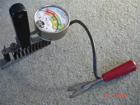

Here's my version Rudi:
And we all know "Older is Better"!!!!!!!!!!!!!!!!!!
:beer:
