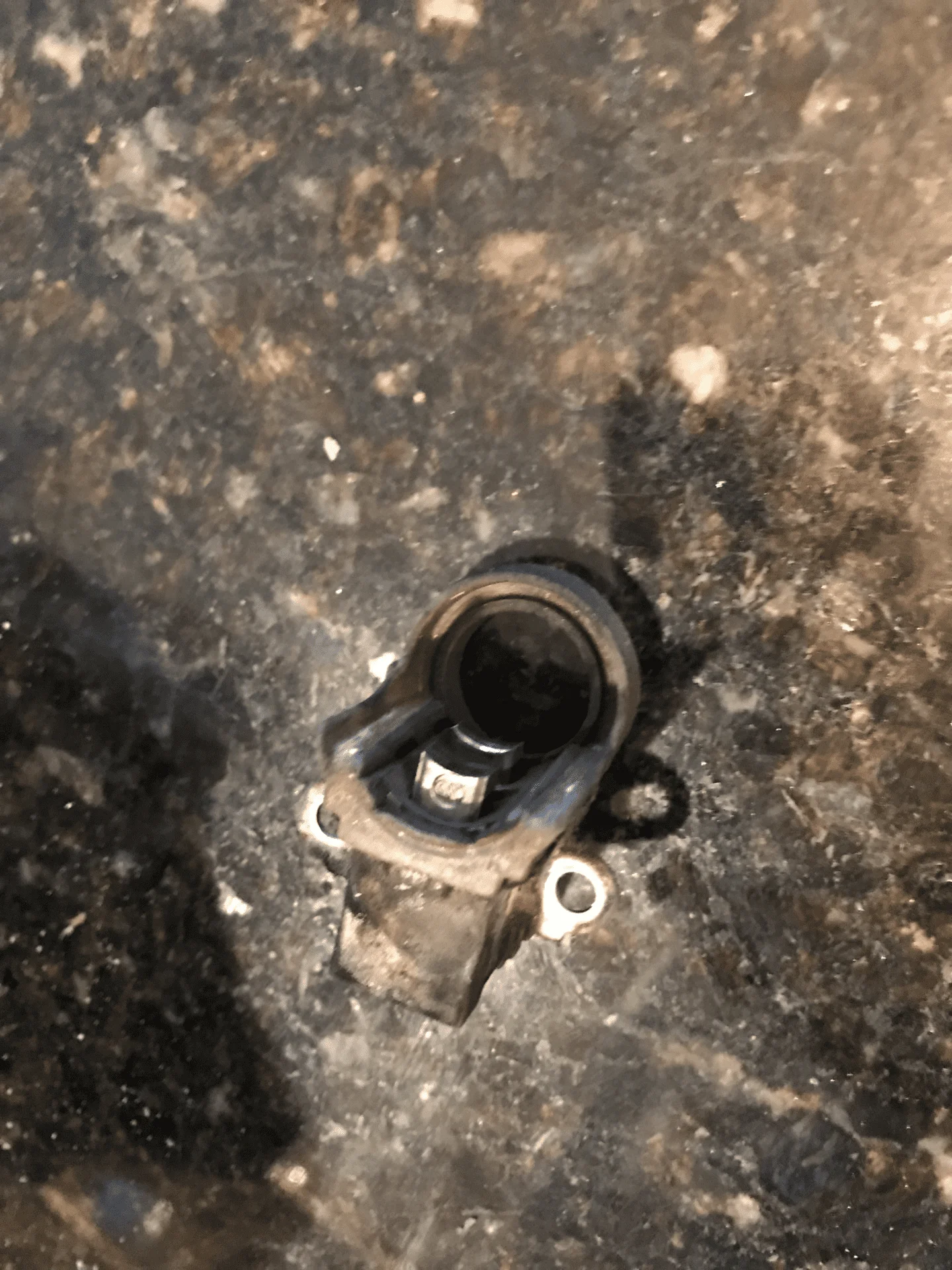

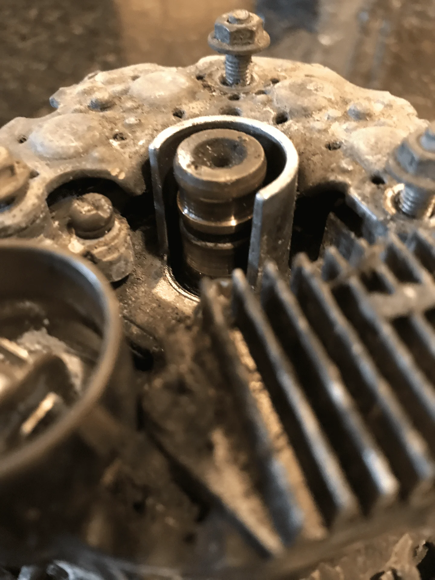

After a little bit of research I learned that this is a known issue with 70 series alternators especially if they get dirty with mud and a cleaning of the brushes can often solve the problem. I had driven through some serious mud not too long ago and not really cleaned the engine bay since. So today I pulled the alternator and took it apart to get at the brushes.
Now that I have it apart I see that the brushes are VERY worn down and the rotor quite worn too where it contacts (see photos below). I'm thinking, if nothing else for the sake of reliability and longevity, this calls for more than just a cleaning even if that might get it working again for the time being. Options I'm considering:

I got a chance this weekend to clean the alternator and replace the brushes. You can see from the photo below how worn down they were compared to new.
It kind of worked but not really. The alternator charges the batteries to 24.5 V but not above that.
Looks like I'm going with the $200 Amazon aftermarket 60A one. Has anybody put in a higher output alternator and used the original output cable? Mine looks like its 6mm or 8mm which should be plenty big for 60A I would think.

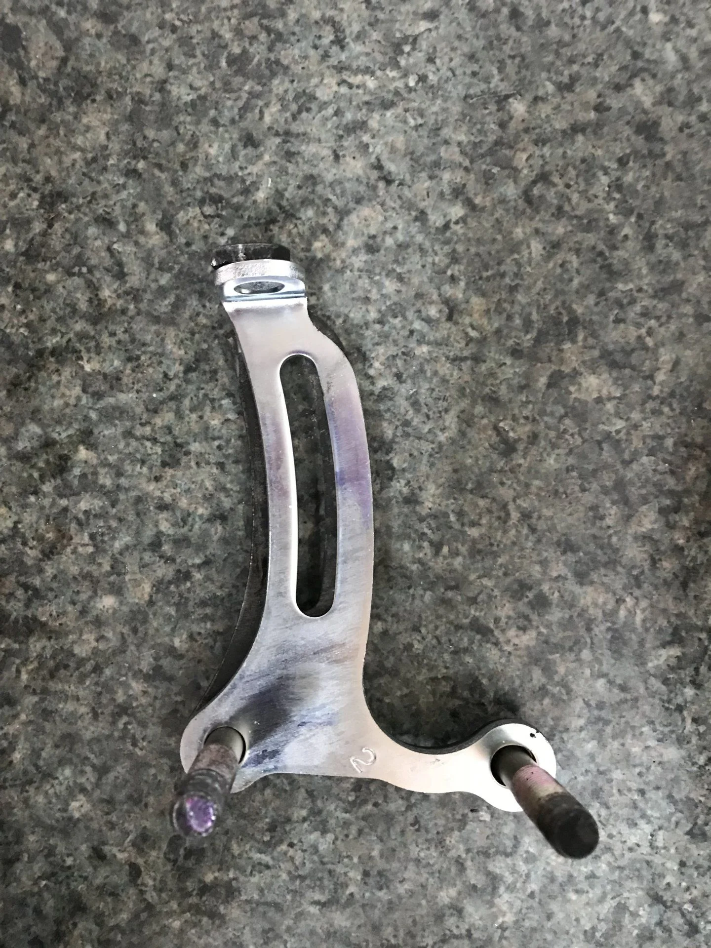

Figured I'd post the eventual resolution of this to document it for others. I ordered the 60A output aftermarket 27060-17120. Went to put it in and since it's a bit bigger, the distance between the two mounting holes is slightly more so a different bracket was needed for the top mounting bracket with the belt tensioner. I ordered that - part number is 1638117020.
Old versus new - you can see it's slightly different.
2010218
Hardest part was just getting those two bolts that mount the bracket to come free. You also have to take off the fan and fan pulley to get the bolts out but not a big deal. I got it installed and the only additional modification was that the new alternator has a slightly bigger diameter output post so I crimped a new lug onto the cable.
