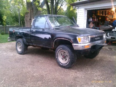

Yep 22re, 5spd, p/s, no a/c. Bed and doors have some rust and the passenger rear frame needs some reinforcing at the front leaf mount.
I'll probably be pulling the bed, media blasting, welding, and por 15 the rear frame areas.
The timing chain wore through the front cover so I ended up getting a street rv head, throwing in new main and rod bearings, all new front components and a new clutch.
The guy posted it on Craigslist at 730am and as usual, by 930 a guy was already on the way to get it/look at it.
I sent him a desperation email and told him to hold out and not take any lowball offers. He did, and at noon told me the guy didn't want it. I left with my trailer and 3 hours later picked it up.
Oil was a milkshake which led me to replace everything I did. I'd like to find a/c parts and swap those in too next spring.
