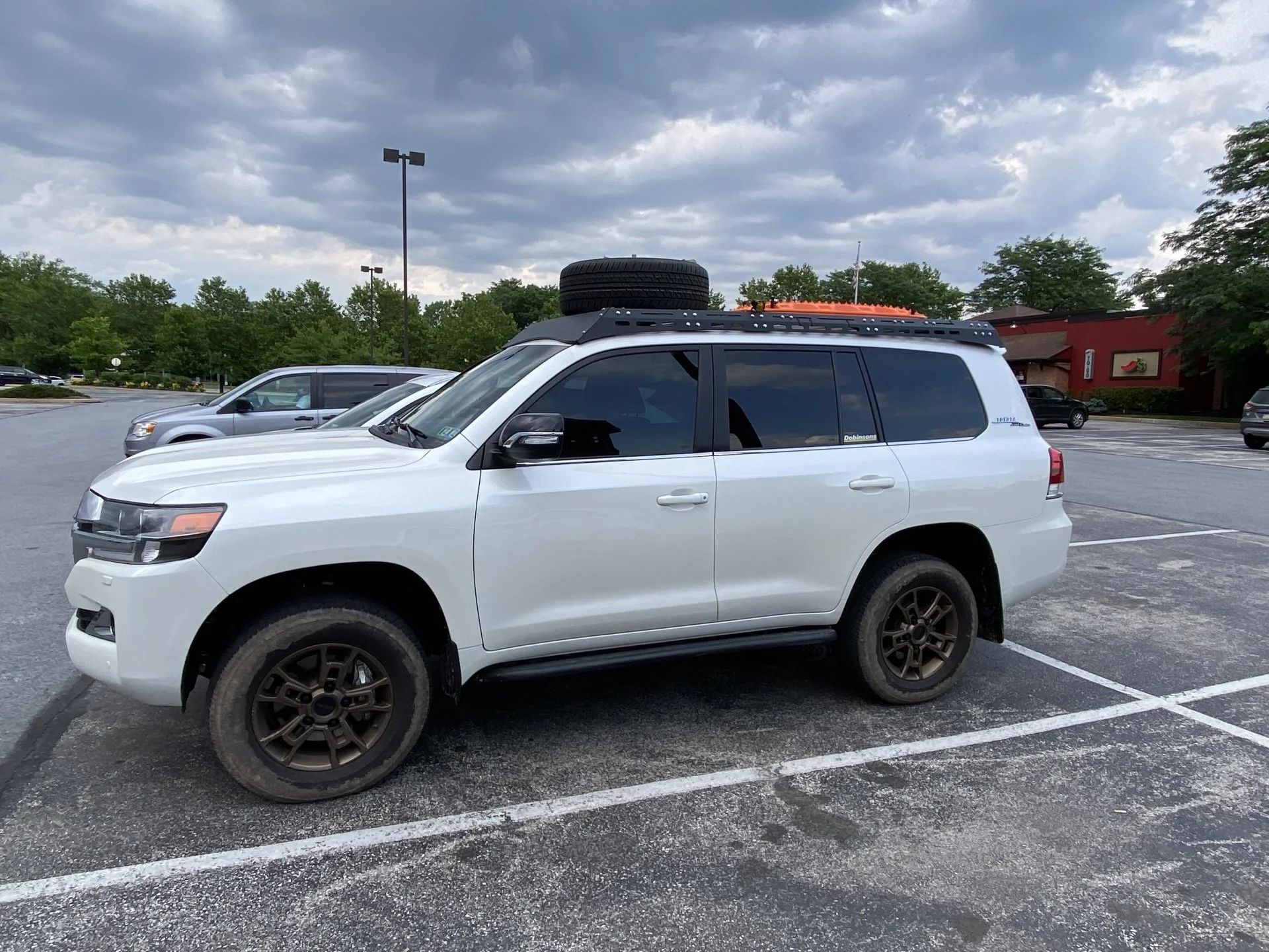

If you are replacing front and rear, you are zeroing out. The existing rake is meaningless. A 2” front and 2” rear spec’d lift from Dobinsons will have you almost level.
Pay no attention to the scrawny stock tires. Mine is IMS and using 542 up front and 547 rear. Almost level;1/4” rake (heavy drawers and 40 gal LRA).
If you are replacing front and rear, you are zeroing out. The existing rake is meaningless. A 2” front and 2” rear specs lift from Dobinsons will have you almost level. View attachment 2713844

My stock gear had become mush with added weight. This has firmed up the ride considerably with no harshness. I am reserving final comment and review until the tires finally come in and get mounted. With a roof mounted spare and Alu-box the KDSS that was near level on curves and on-ramps when new is now a little less level. Physics. Waiting to see what larger E rated tires will add (or subtract) to the KDSS effectiveness. I also don’t think my alignment is 100% dialed in yet. Waiting for tires to mess with it.

Right, so if you are replacing the rear springs with a set that provides 2” lift and the spring se@t for the front coilover is set right for 2” of lift (222mm I think, but check instructions) the tops of your wheel arches front and rear should come in around 37”. Like I said mine are about 3/16 to 1/4” higher in the rear. Effectively level.
