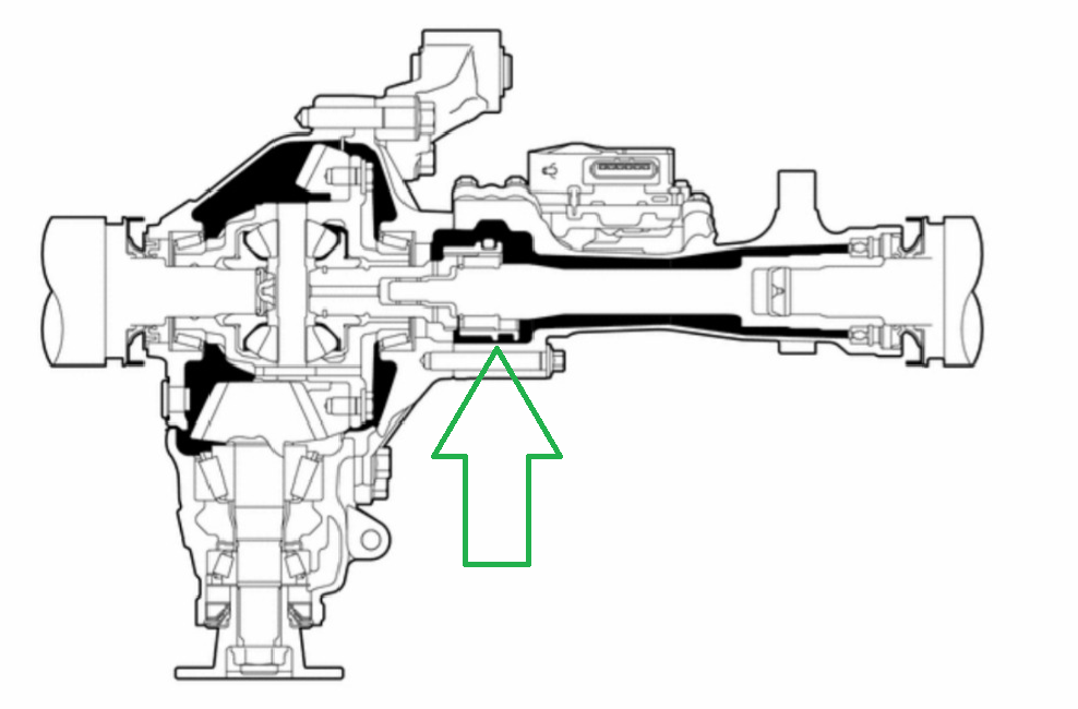

I have not had either one open personally - so this is just based on Toyota's drawings as I understand them. But it appears the Taco front diff still uses an engagement clutch (splined slide collar) on the intermediate shaft.
The Tundra/Sequoia is magnetic clutch integrated into the carrier.
I'd guess you could probably still swap in the LX700 (or presumably any of the LC300 front lockers) into the Tundra or Sequoia, but you'd have to accept that the front will always be spinning even in 2hi (about half of it is anyway already) or add an awd transfer case if it is adaptable. Wild guess - but I'd bet the awd case is an easy bolt on swap. I think the electronics may be a little more challenging.
