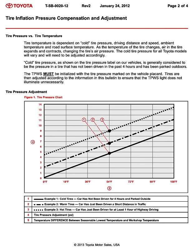

"The Book" says your 2017 Land Cruiser left the factory with ISO-Metric 285/60R18 116V SL (Standard Load) tires with a RCTIP (Recommended Cold Tire Inflation Pressure) of 33psi for both Front and Rear tires.
Note: (Quote from Toyota TSB)
"Cold" tire pressure, as shown on the tire pressure label on our vehicles, is generally considered to be the pressure in a tire that has not been driven in the past 4 hours and has been parked outdoors.
You may find this document from Toyota helpful:
If these are not the same size or type of tires currently installed on your vehicle, then feel free to post back with the correct tire info and I'm sure we can get you sorted.
And don't forget to initialize your Tire Pressure Warning System after you set all your tires (including the spare) to the correct pressure.
HTH

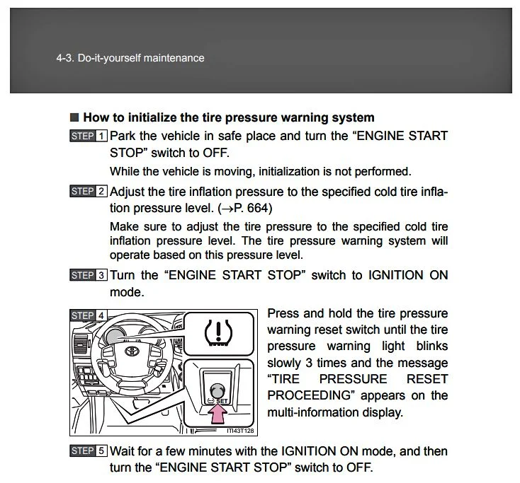

Excellent information thank you very much! Truly appreciate HTH. Now 2nd question once I update the tire pressure how to rest the TPMS?
Your welcome.
The procedure to initialize (reset) the Tire Pressure Warning System is in your Owner's Manual, but here is the general procedure:
